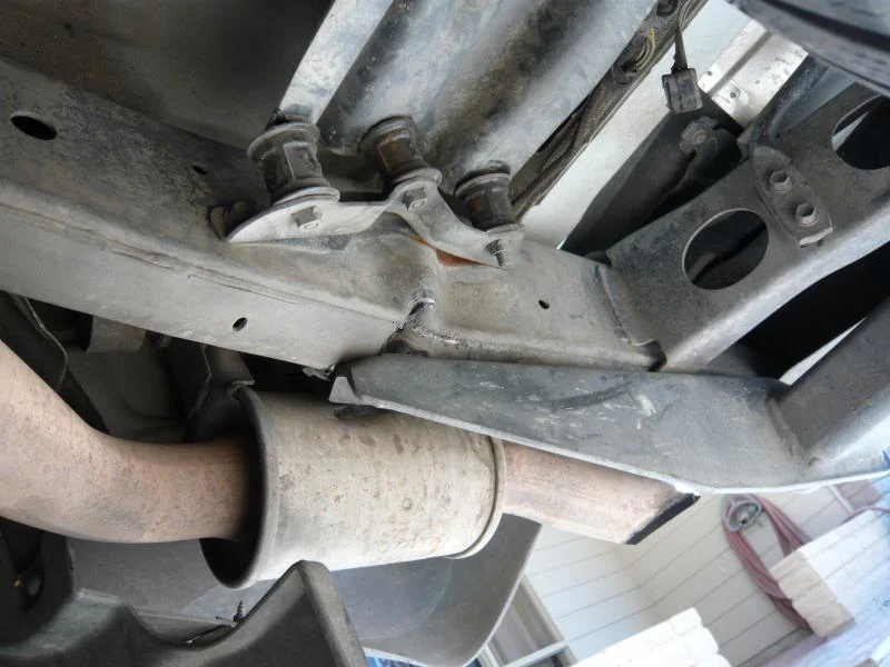

Let me ask a question. I have done the exact same modification and, once I was done, it didn't seem that the tire was much higher. My observation is that moving the crankshaft down 5 inches ... Back to its original location ... Means that the tire will still raise to the same spot it always did. If the crankshaft is still in the same location, post-modification, why do we believe the tire will rise any higher? I may be missing something ...
Basically you get the tire tucked up above the rear diff, rather than it hanging down in the front it will how hang down in the back.
You're basically tucking the front of the tire up where the second aux fuel tank would be. I did this a few months back and am OK with it however you rear departure angle is as it was, the benefit is that with it not hanging down in the front there is less chance of catching on something while moving forward.
I did this modification today with the help of this thread. Thank you it works quite well, simple, cheap and 5 inches of clearance. The only frustation was needing 4 hands a couple of times but one person can get this done in a couple of hours no problem. I'm no mechanic and really appreciate the detail that was given. Thank you again.

Resurrecting this old thread to add a data point on spare tire lift. I picked up the Wits' End (formerly AJIK) kit last week and installed it yesterday, I liked the idea of the adjustability for when I go to a different tire size down the road.
This was an easy install, the instructions were very thorough and easy to follow. I will probably go back in and stick lock washers on everything (they were mentioned in the instructions but not in the kit), but that should be fairly straightforward. I wanted to get a good idea how much of a difference this mod made so I put down a tripod and shot a timelapse video for myself. From that I pulled some frames from the start/finish for before/after comparisons and made the GIF below, showing the change with and without the spare in-place.
A few things:
  • Between the start and finish I unloaded between 25-30lb of tools from the cargo area, so the suspension raised slightly from the before to the after pics.
  • My suspension is 100% stock, with tired old springs with 300k+ miles and 26 years on them.
  • The spare tire is of the original size Michelin LTX (doesn't match the others).
  • My rough tape measure measurements for front and rear of the tire before/after:
    • Rear: ~12" → ~12"
    • Front: ~9" → ~ 12"
  • The tire is pressed hard up against the body pinch seam just behind the tire winch crossmember. I'm a little concerned about it, imagining dropping the spare on the ground going through a dip and having the pinch seam dig into the spare sidewall. Thinking I'll try to half-cut some fuel line or small-ID heater hose lengthwise and stick it onto the pinch seam where the tire contacts it just to blunt the contact point a bit, wouldn't take much material as it only touches the pinch seam in a few places

Hey folks I thought I’d chime in and add to @imhighlander’s excellent write-up. As far as I can tell AJIK and their descendants aren’t making spare lift kits anymore. Delta says they’re going to “soon.” But I'm impatient.
Here's a write-up on my own DIY job based on @imhighlander’s post and the youtube video. I made some made mods documented here.
Background: I have a ‘97 anniversary edition that came from PO with a Kaymar rear bumper. The bumper had hinged spare carrier and dual fuel can carrier. But the way I use my LC I’m opening and closing my tailgate all the time. And I'm not doing much aggressive off-road. The hinge-outs were a huge pain. So here we are.
The details:
First, instead of 5/16 bolts I opted for M8 x 1.25’s to take advantage of the OEM welded-on nuts and tapped holes already part of the assembly.
I bought the fasteners from Mcmaster-Carr. McMaster has a great selection. I chose 140mm (but later shortened to 110 see below) hex head zinc-plated class 8.8’s because I thought this was the best combination of strength and corrosion resistance. McMaster sells stainless steel in that size but those are a lot weaker. They sell Class 10.9 too, but class 10.9 is not much stronger than class 8.8 and my understanding is they’re less corrosion-resistant. I’m by the ocean so stuff rusts a lot here.
For the spacers I wanted as much metal as possible for make-it-really-strong reasons. But I also didn’t want to design and pay for a custom machined or custom sheet metal because... time and $$$. And I never get it right on the first try, so even more $$$ and time.
So I chose ⅝” OD x 0.12” wall 304 stainless round tube. The tube comes in 1' 3' and 6' lengths, and I can cut fairly accurately with a carbon cut off wheel on my circular saw. It fits snugly around the M8s. (McMaster P/N 89895K756).
AD_4nXe_yKF74kA3hsz3juZmSWW4nJkDXiLBFLiZTtUBUfamBSfn9K72xBpNsaKjMJVtdxi-Rsgjz4NVyUY_j-GwTgzY6eF2p4e54Mz8u0JmfJVt8sYBoFIuX6zzTGVK5cVGzL5crmZ7oQ
After removing the lifter assembly and treating all the rust with POR-15 I reassembled with the spacers and longer fasteners, then to the vehicle to test fit. The spacers were about an inch too long. I saw someone else on this thread mention the same issue, not sure what the deal is.
Take 2.
I cut the spacers down to 3.5”. Re-assembled, re-installed. Great fit.
AD_4nXc0xGhcX0EMvIYJ_k2wnwlEdqSoP67ylKy881DB3M_dADIlELe6XATPaJzsRnPxblA4QuSg1n9oKpFcaWs5De4YY7cDaulFgnIED7DX8VSRL3_f0h_icdPDhCvKDY_JFirYdFU5
Here's a pic of the assembly with the 3.5" spacers prior to install.
For the record after install it appears I gained 1.25- 2” of clearance out of this mod. I measured but it was hard to tell exactly as I'm not parked in flat ground. But definitely not 0 and definitely a lot less than the full 3.5.
