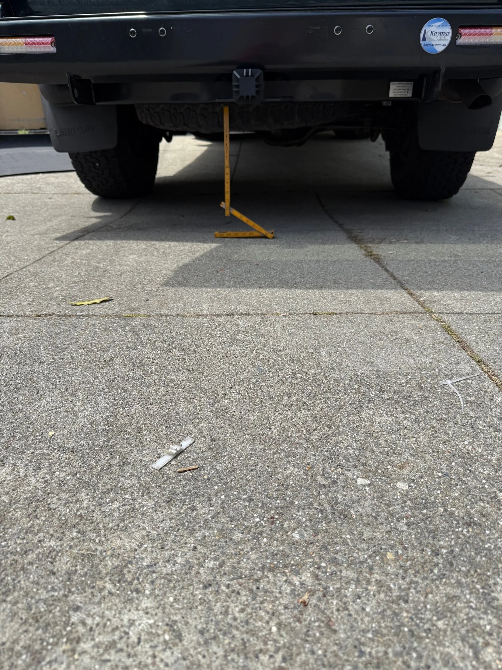

For the record after install it appears I gained 1.25- 2” of clearance out of this mod. I measured but it was hard to tell exactly as I'm not parked in flat ground. But definitely not 0 and definitely a lot less than the full 3.5.
