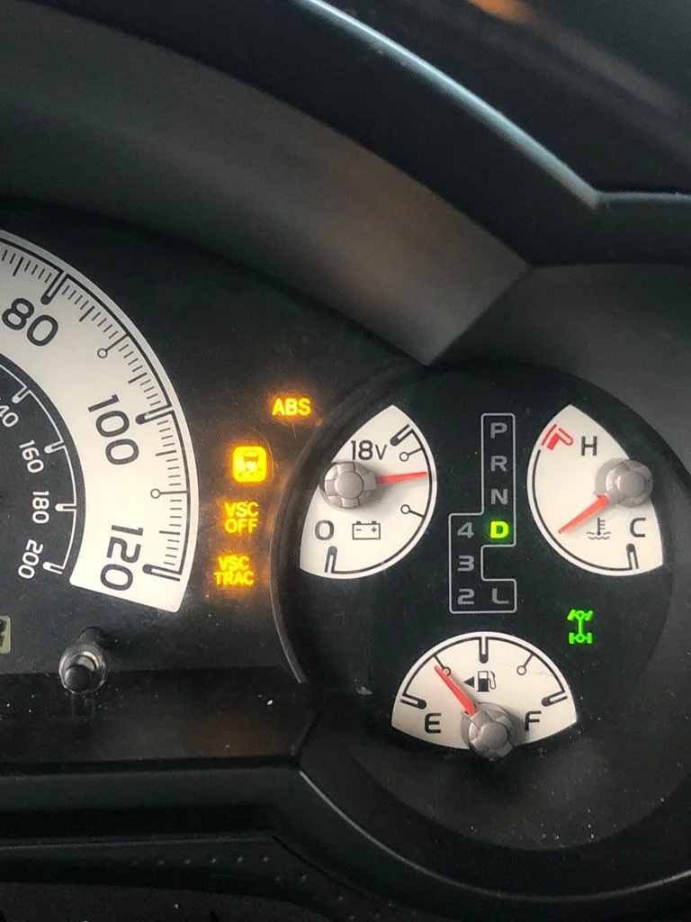

Warning Lights: Vtrac, VSC off, Slip, and ABS lights all come on

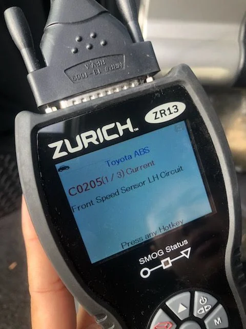

Error codes: C0205- Front Speed Secsor LH circuit

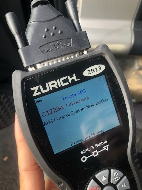

C1223- ABS control System Malfunction

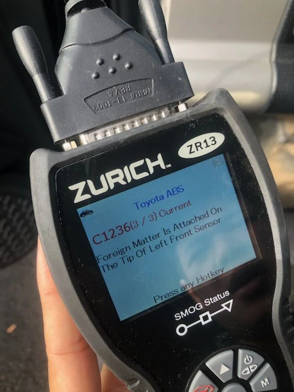

C1236- Foreign Matter is attached on the tip of the left front sensor

Wheel speed sensor is held in with a small bolt on the backside of the spindle, just follow the wire loom down the inside of the spindle, alongside the soft brake line. Remove the bolt and carefully wiggle out the sensor with a slight rotating movement. It's plastic so don't pry on it with a screwdriver, if you can avoid it. Remove it and check for debris. A little grease on it should not be a problem, but if it has metal bits or mud, that's an issue. In addition to the sensor, it may be the tone ring in the hub assembly. Based on the amount of rust I see, you are probably due to change the hub bearings anyway.
The easiest method is to buy a pre-assembled hub unit instead of just the replacement bearing. That way you don't have to press off the old bearing and press on the new one - a real time saver and headache saver.
I've used bluepitbearings.com for replacements and they have several price points now. The new hub assembly comes with the big o-ring, 4 captured bolts and new lugs, so it's handily a good way to go.
Here's a post on the unit bearing hub assembly
looks like its almost time for brakes. when you pull the speed sensor out make sure that it is sitting flush on the knuckle, if its lifted a bit on one end or another it can also cause speed sensor codes. clean the sensor tip off, reinstall, clear the codes and see if they come back
