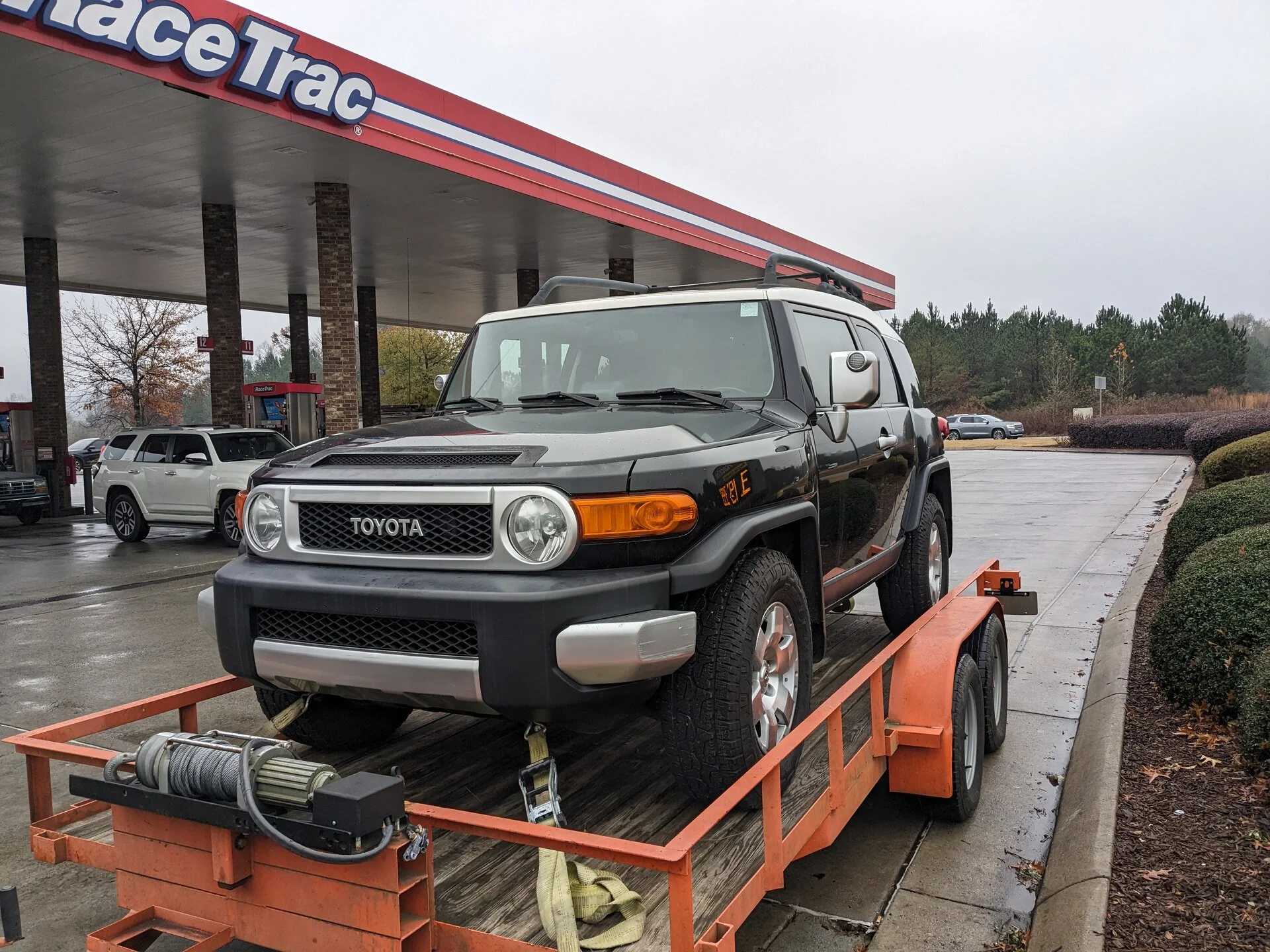

I sold my 2007 FJ cruiser when I was living in DC and I was having to commute in crazy traffic. It just wasn't ideal at the time, ended up picking up a turbo diesel Volkswagen and sold it. I have regretted it ever since!
Fast forward yesterday, I saw one pop up that was finally priced realistically, two owner vehicle and the guy had owned it since 8000 mi with full maintenance records.

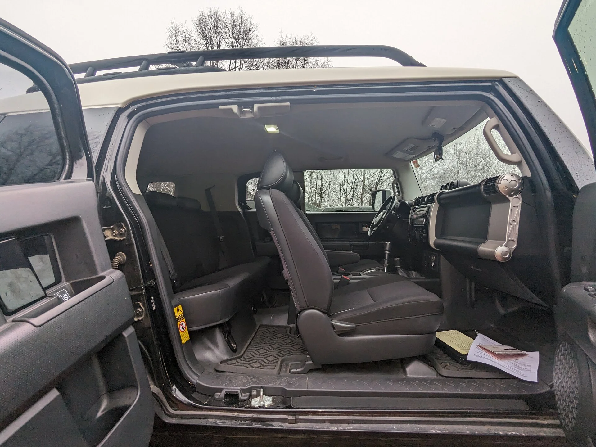

I need some little things, passenger side seat belt won't retract, CV axle boot is leaking on the front passenger side, paint on the very front of the hood has a bunch of chips.
I'll be going through it probably next week. I just trailered it because I couldn't find anybody else to go with me to get it. Runs great! 260k on the clock.

Looks Great! Go with SafelyRestore for your seatbelt retractor. I replaced my front nose piece. Went with black. But since, I had a full body Line-X done on the rig.
Toyota had a whole seat belt assembly for 168 so I'm just going to pick that up. Quicker and brand new everything. Good to know though!

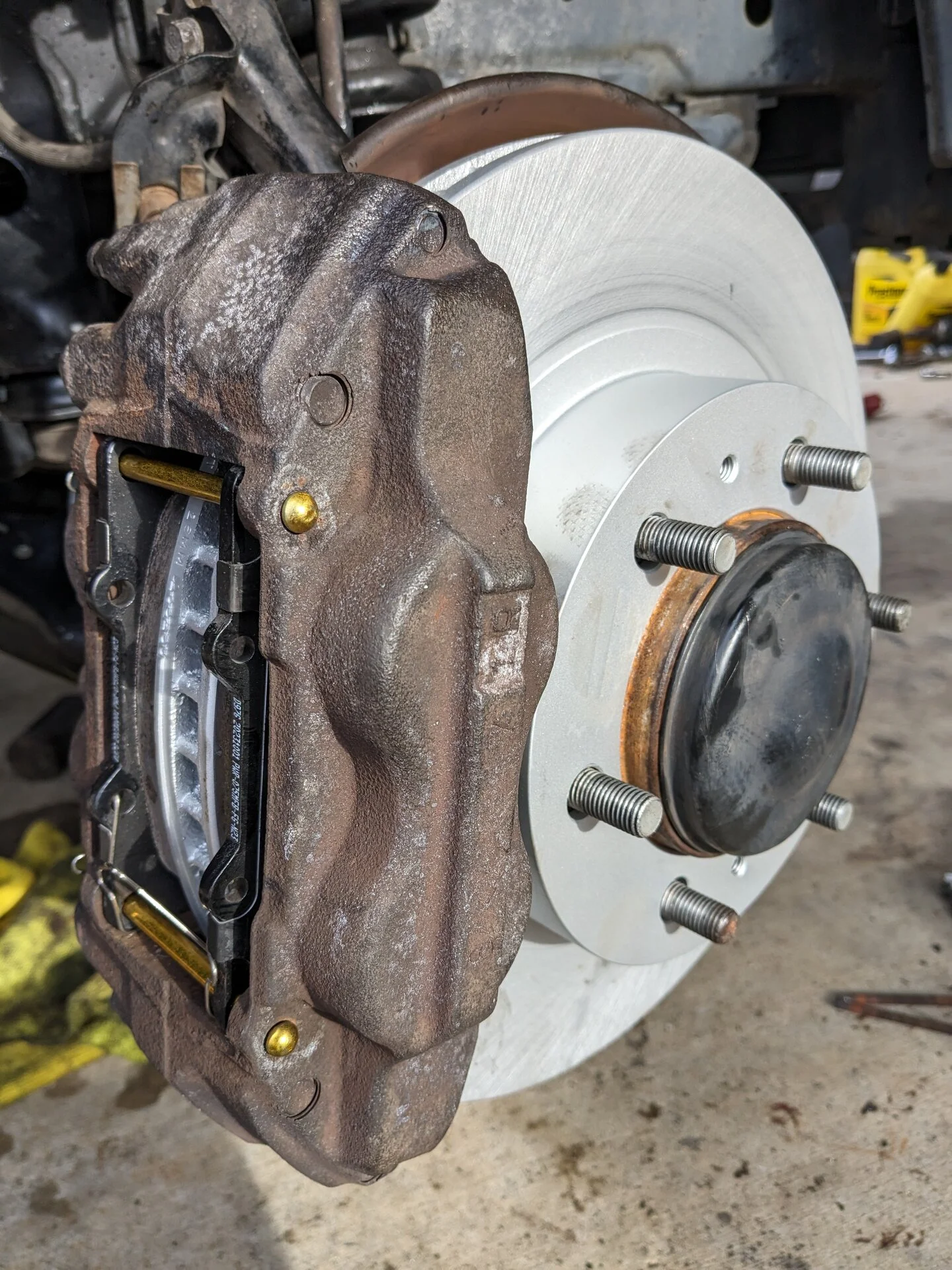

Brake pads on back were just about metal on metal so I plan to change rotors and pads all around when my parts come it. I went RockAuto for the pads and rotors with the corrosion coating.
Also got plugs as part of the baseline.
I am a OEM brake pad snob. I never liked the feel and extra dust created by aftermarket pads.
Yeah I hear you, I may end up swapping them at some point, but for now just to get it going. I didn't even think about getting pads from Toyota

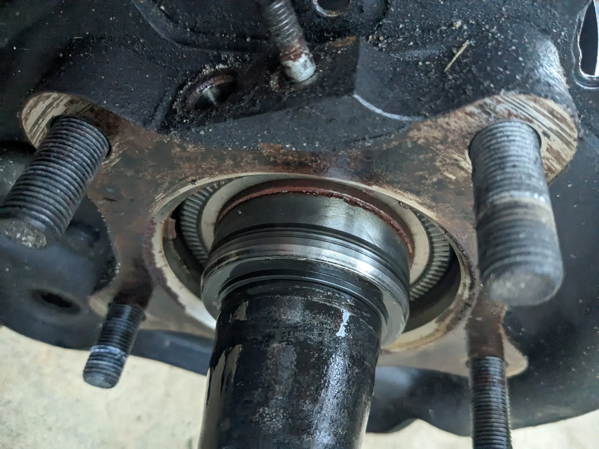

Well I was making quick progress until I got to the driver side rear, the previous owner had receipts for re
placing this axle seal in March, approximately 2,000 miles ago. Well I noticed it was leaking again. When I tore it down I found that the axle shaft has a groove in it.
Any Idea if there's a kit to sleeve these? Is that portion actually part of the wheel bearing? I'm about to do some research.
