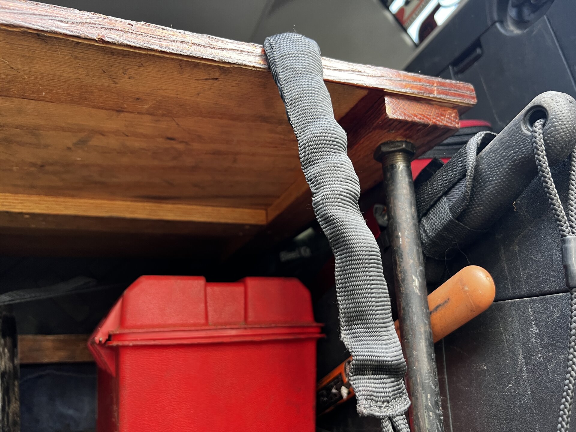

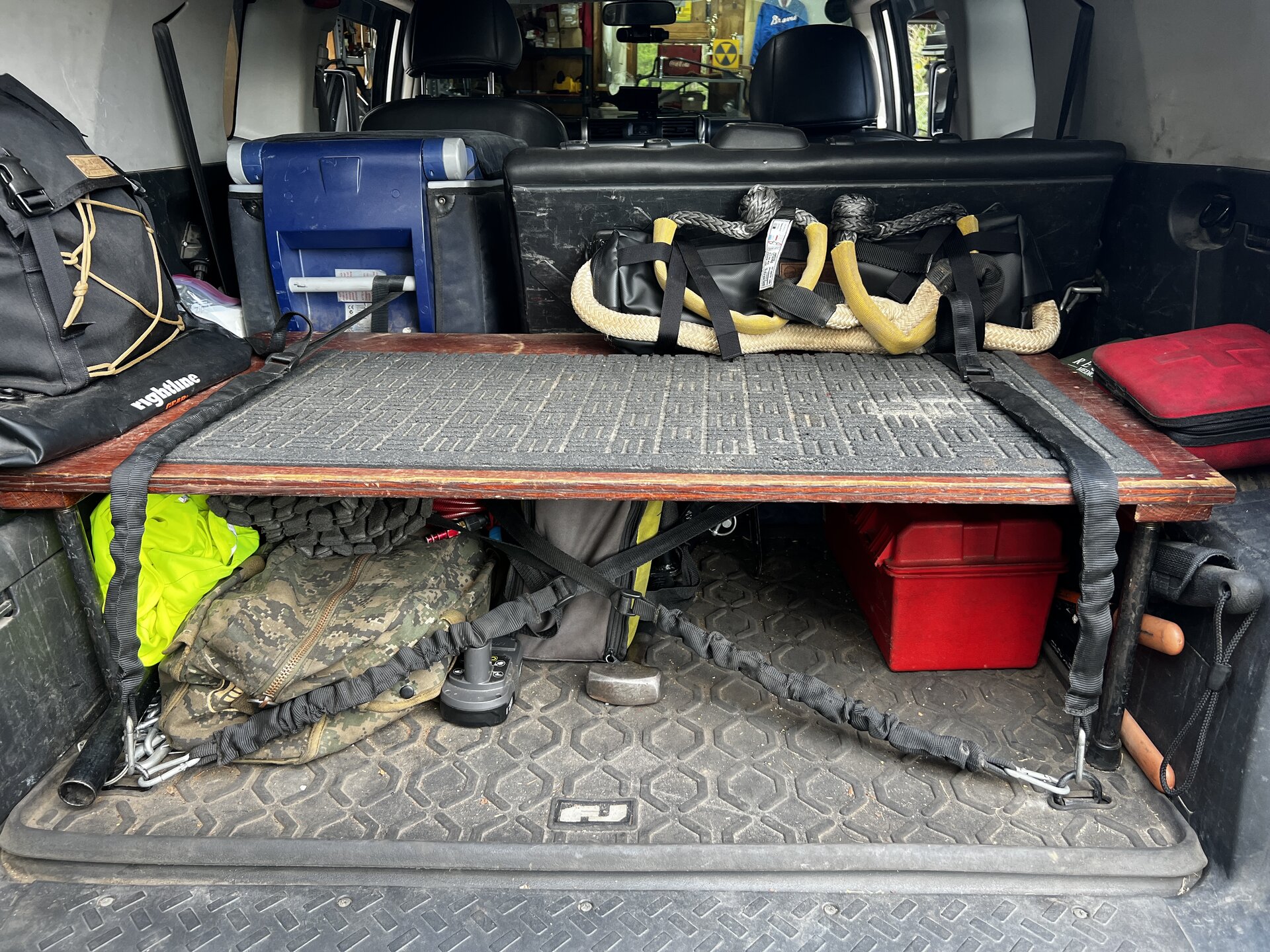

I did the cheapest mod I could build. I cut a small platform out of 3/8" plywood with a couple of 1 x 4's under it for rigidity, then supported it with black iron pipe/flanges and rubber cap feet. I put my fridge on the seat behind the driver's by removing the back seat bottom and flipping the seat back down. It provides a nearly level spot for a fridge.

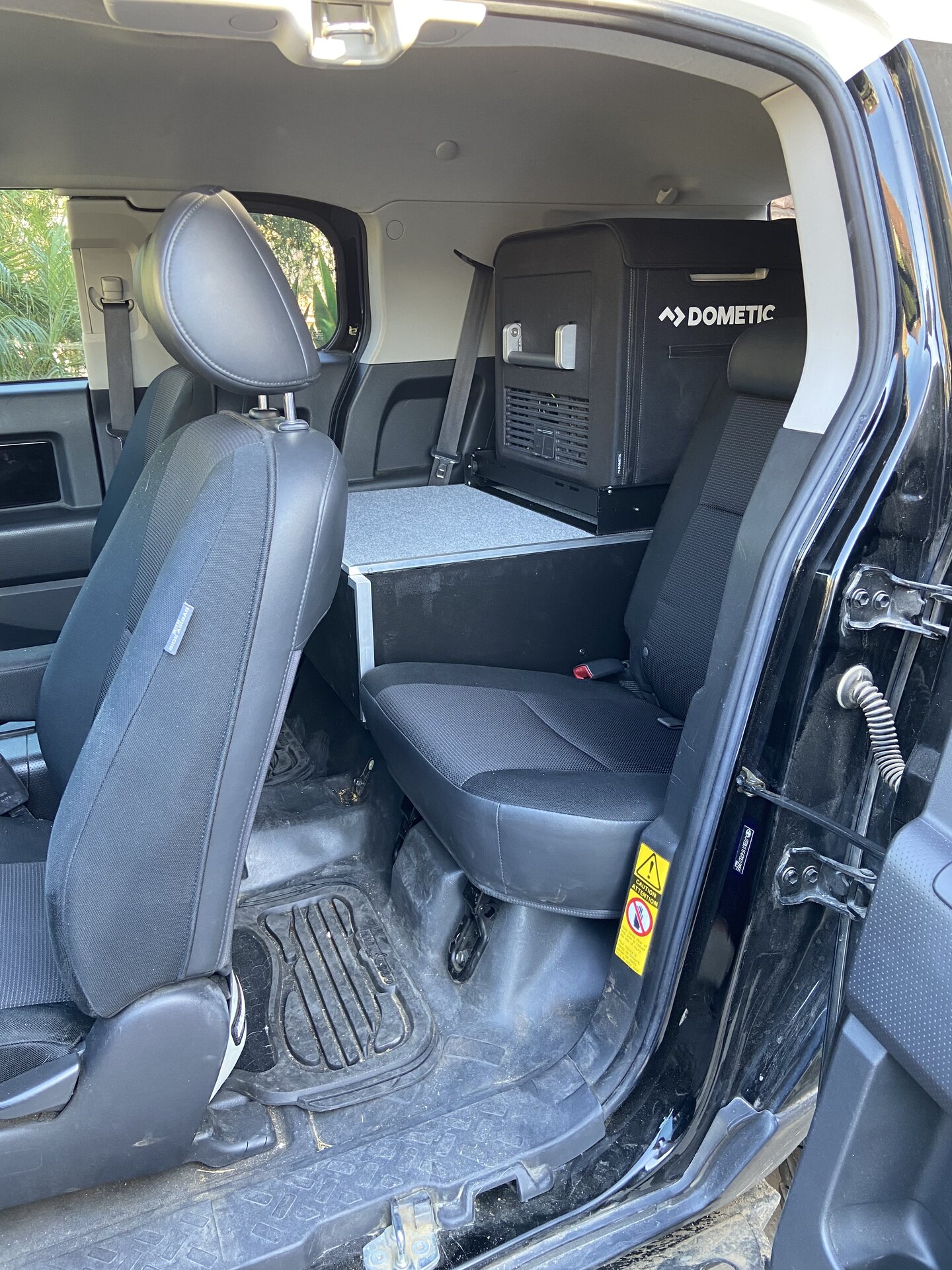

ARB fridge mounted behind driver seat.
Cheap shelf. Looks more like 3/8 or 1/2 inch plywood and I used 1x3 boards underneath. Cargo straps do double duty as hold down for the fridge and the shelf. And if I load the top of the shelf they can secure that cargo too.
