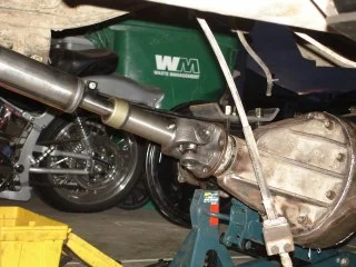

Well I was, untill I got the drive shaft in place and test fit everything. I just didn't look right with parallel angles and a steeply angled driveshaft. It might have worked fine. However, I had a spare DC driveshaft, and the angles looked a lot better, so I just did that. I'm going to get a spare "normal" shaft made for trail emergencies.
I also have the memory of one of my friends breaking a Spicer CV shaft at Rubicon and the consternation and welding it took to effect a good and drivable repair, so I decided to go with Toyota and hope for the best. My photos are weirdly angled, but the angles themselves look really good. I'm going to run it a season and see.

I never realized how pitched the 40's x fer case sits at.
My x fer sitting in the rig is at 4*...
The angles in your photo look pretty good.
The guy who is building my shaft is gonna run a CV from a toyota and is gonna re build the whole shebang.
I measured it up with out turing the axel housing, and it too looked pretty harsh as far as the angle were concerned. Talking to Dean, the driveline guy Im using, he said that the length of the shaft is close to the line between where I could get away without one, and disaster...I prolly could have gotten away without, but I didnt see any real advantage to sticking with the stock shaft and risking it, so I decided to JUST DO IT!
In the front, Im gonna flex the hell out of it and see what's doing...Im still a bit concerned with it. With the axels hanging free, the u joint binds at the x fer and it makes me un easy...
And, the slip is sitting about an inch away from coming out, so if nothing else, I might have to have it lengthened a bit if I can get the damn this apart!

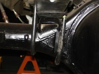

Next time you are snapping pics, can you please get a close up of the diff side perch. It looks like you are using a round u-bolt. What did you do to keep it from climbing up the side of the diff?

Yes, I did use a round U bolt, and I welded some tabs to the inside of it to keep it in place.
From what I can tell, the real issue is not so much the u bolt climbing UP the diff, but rather it moving OUT away from the diff. Its nestled right off to the outside of it, so it wants to lean away.
Ill get some pics to show you, as what Im saying isnt even making sense to me!;p
The perch is kind of a bitch to cut and get perfect. It took a LOOOONNNG time, and I had to do it twice cuz Im an IDIOT!

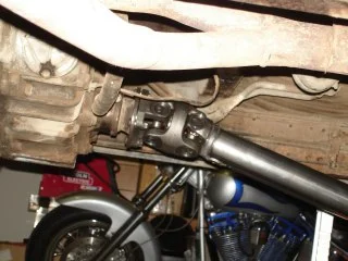

NEW DRIVE SHAFT BITCHES!!!!!
Also got my rear diff back that is now 4.88's and LOCKED AND LOADED with a Lockrite!
UMMM, the lockrite install....PITA!!!
It was a PITA because of the center pin. I didnt realize that its butt ass tight going in with a locker, and lining up the retainer bolt when its that FU*KING tight is NO FUN!
Still not too sure how to mount my x member for the trac bar.
Here's a few pics of the new DS!
For some reason I couldnt up load all three...

Here's a couple for ya Kavik!
The best solution Ive seen for the Pass side diff issue, has been Cruiserdrews set up! He had the top plate drilled on the angle of the housing, and spacers made and welded to the top plate, so the u bolt angles right in place! I believe Luke Porter at 4x4 labs did it for him!

Thanks. Weird how much the u-bolt leans like that...hmmm
Looks like the tabs you added would have done the trick. I think I'm going to weld a tab at the bottom.

Well, theyre sort of bent that way around the side of the housing.
Im not so crazy about how this had to be done, but many a folk are running em this way, and havent had problems....
So hopefully it will all be good!
The tabs I welded are about a 1/4 in thick and about 2.5 inches long!
I hope it will be alright!
