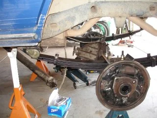

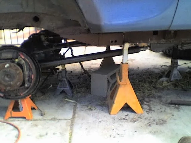

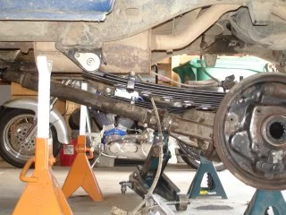

First is a pic of the rig with the packs on
Next, is a pic with the axle in, NOT set in place just yet!
Third, is the axle set where its gonna live!
Enjoy!

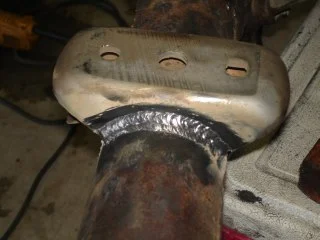

Just a couple of the housing while welding on the perches!
Because Im using a 110V, I beveled the edges, prepped the hell out of the welding surface with a wire wheel on my 4.5 in angle grinder, sprayed with brake cleaner and then did TRIPLE passes just to be as sure as I possibly can.

freaking good looking welds!!!! they make mine look like donkey dick.
your "bench" is pretty sweet too. is that a "Kustom" build? J/K man you're doing really nice work, and I know how we have to improvise a lot... Keep it up.

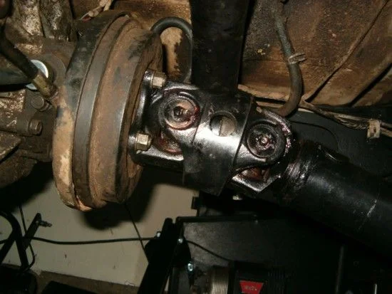

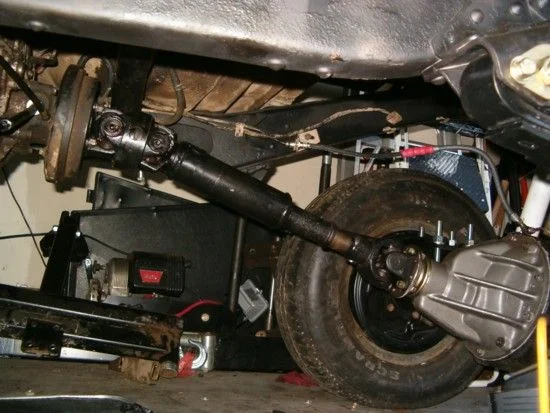

It looks like you pointed your diff right at the t-case. I'm wondering what you did for a double cardan shaft?
I did the same by the way, and used a front shaft off an early FJ60 and had it lengthened.
Aint it nice getting things done :)
Hey Andy,
Im having one built! Now that I have the angles set, Im gonna bolt everything in (AGAIN) and take the measurments, flange to flange and bring it down this week with my rear diff to have the 4.88's installed.
