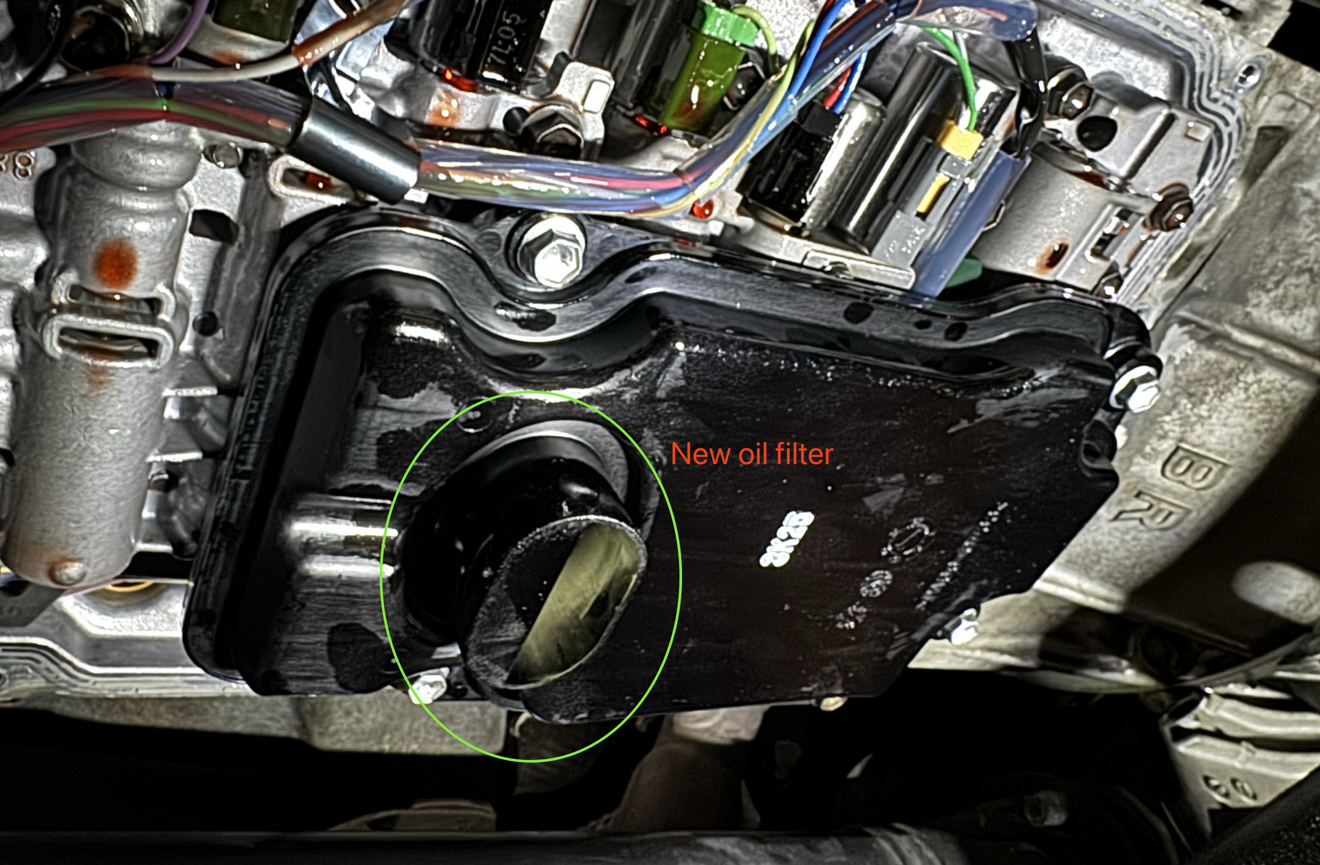

Suddenly, I realized that the OLD oil filter is wired:
The wrong oil filter probably was the leading cause! The old one doesn't have the raised tube so sometime will suck some air into it, might cause the issue. Any thoughts on it?
I put everything back, refilled new oil and checked oil level. The trans works smooth! No issue with 1K miles so far.
Will keep report if the P2714 is completely gone. What a dealer's s*** job!

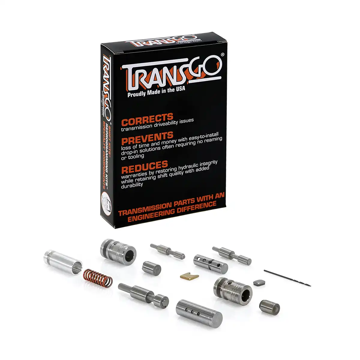

P2714 showed up again, I gonna try TransGo SHIFT KIT Valve Body Repair Kit.

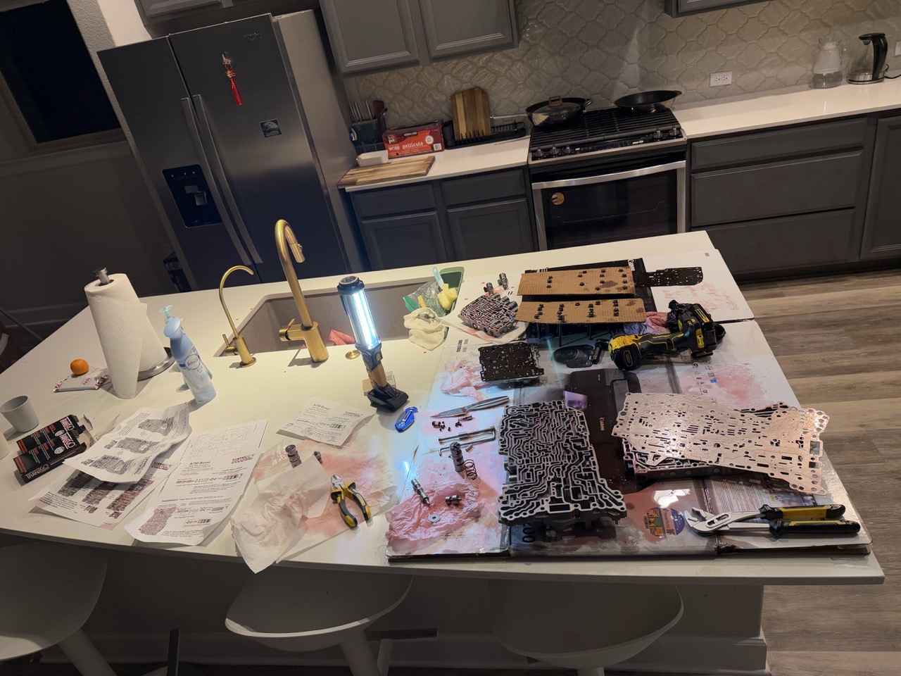

Spent about 5 hours to finish the TransGo work during the weekend.
But I lost reverse gear, so sad. Maybe I did something wrong or the previous owner did some wrong. The difficulty of fix valve body is like 7 out of 10. Please take lots of pics before you take parts out. Also do some notes to mark, really help a lot for anyone first time to do transmission work.

Great news! After adjust one retainer's position, so far the transmission driver great!
TransGo Parts 1:
TransGo Parts 2 (a key part of a successful repair):

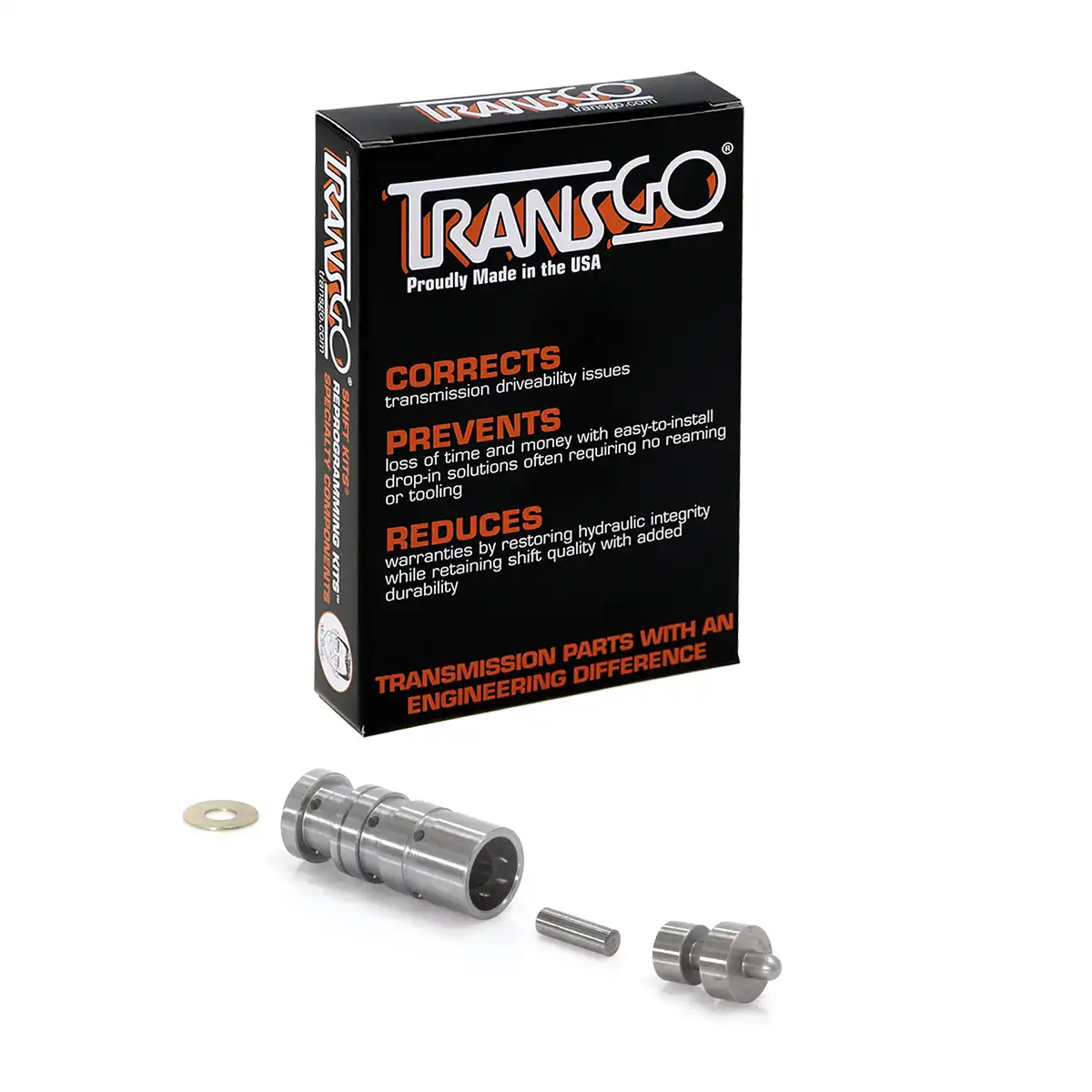

TransGo Parts 3 (Recommend, but I forget to buy):
TransGo Parts 4:
I only did TransGo Part1 & 2, if do it again, will apply all these 4. If you're planning on doing it, I highly recommend doing all four TransGos.
