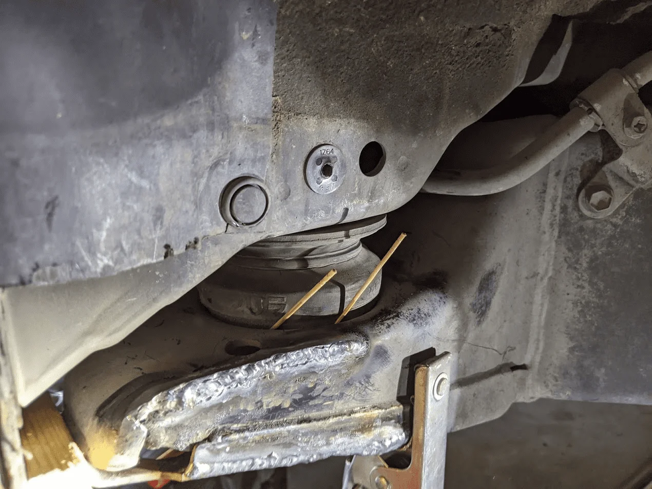

Stitched up one side. I'm glad to have made the stitch towards side facing rather than on top and bottom. Much easier to tig. Trying to minimize the heat into the mount so as not to compromise the body mount bushing. I loosened the assembly and the toothpicks are to create a gap to decrease heat transfer into the bushing.
Does the engineering side of you think you are comprising BM strength due to the heat input and essential tempering of the HAZ? What’s your filler?
Not concerned for a couple reasons. Frames are generally low carbon steel. Even if this part was not, where it's cut and spliced is largely beyond the primary structure that holds the mount. It serves to box in and provide crash structure against tire intrusion. To your point, I tried to rework it in a fashion that needs minimal heat and welding as I didn't fully cut out the side to weld in a new donor plate. Pulse TIG also minimizing heat input. Not using any particular filler, run of the mill steel filler I have in my garage.

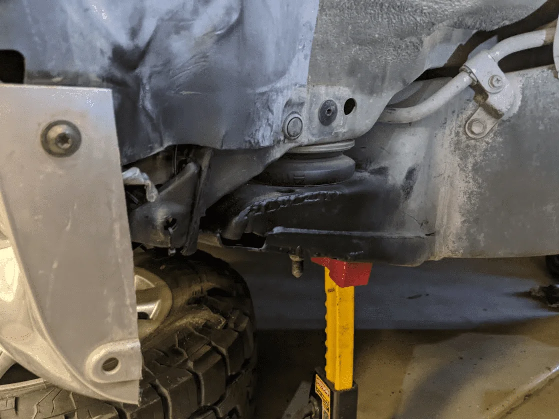

With nothing to lose, out comes the angle grinder. A useful tool when solving interference issues. :)
Marked the cut around the tire witness marks. Making a gentle curve to ensure no stress risers.
Cut, grinded smooth, and a nice coat of paint
I was going to weld and box material back in. Cut relatively little material away and the UCA is plenty strong there so no structural concerns in my mind. Given the geometry and strength primarily needed on the horizontal plane, these things are potentially still stronger in those directions than some aftermarket UCAs.

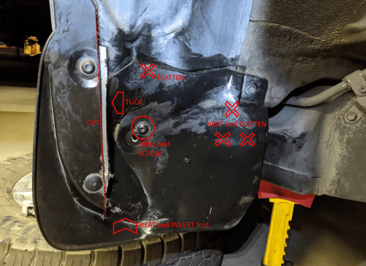

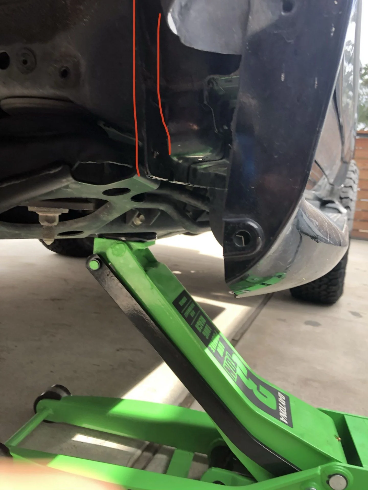

Hi @TeCKis300 I just wanted to make sure this what you are calling the mud flap you trying to avoid contacting with the tire? I want to be able to keep this as well when I move up to 35s.
That part I consider the step. You'll want to make that verticle cut closer to the holes than is pictured there.
I did put back the mudflap with some effort. Quite a bit of shaping and contorting to get it to work. I added some more details and pics to post #3 to clarify.

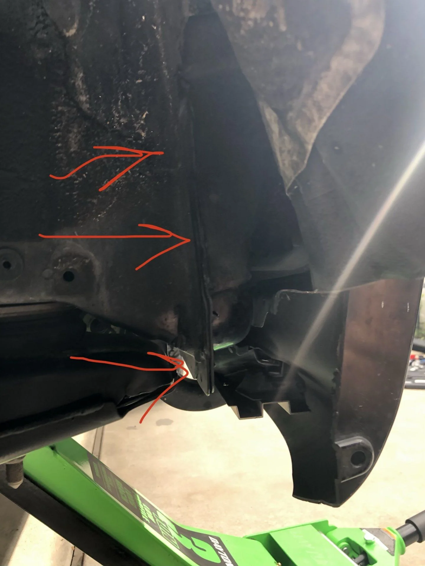

@TeCKis300, is this the pinch weld you “hammered over to the side”? Just bang it over to the step side?
Yup, bang away to fold it over. I used 3lb hammer. I didn't fold mine over too much, but IIRC, you have an incrementally taller tire but narrower tire so you may or may not need more?
I hit it with some paint after doing the deed as that part likely gets the brunt of tire spray.
