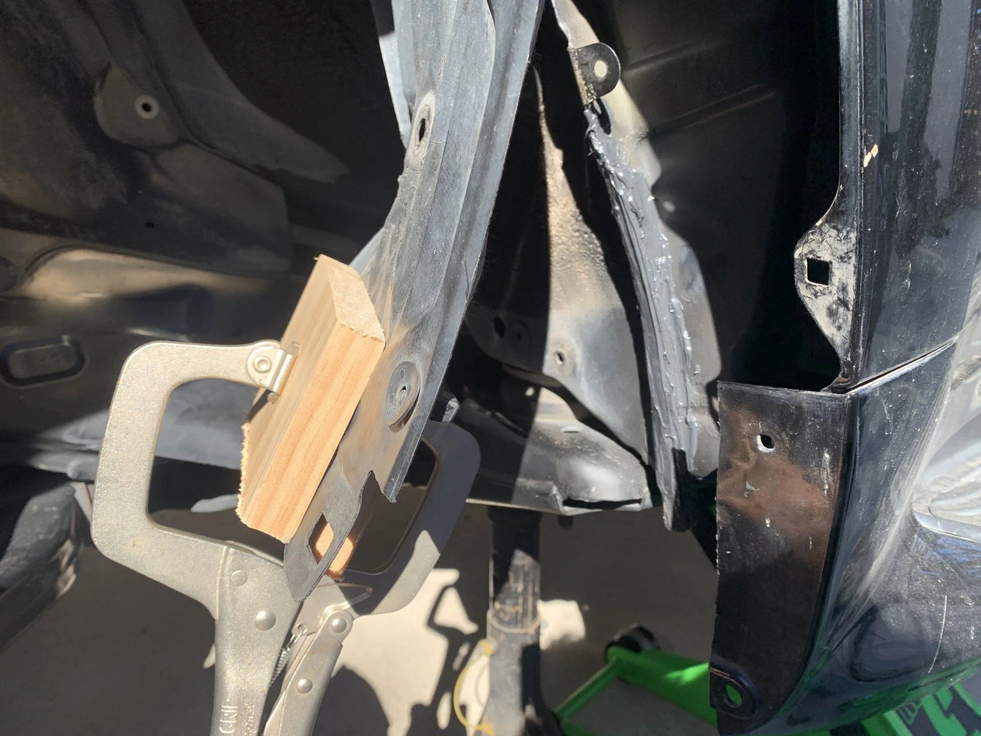

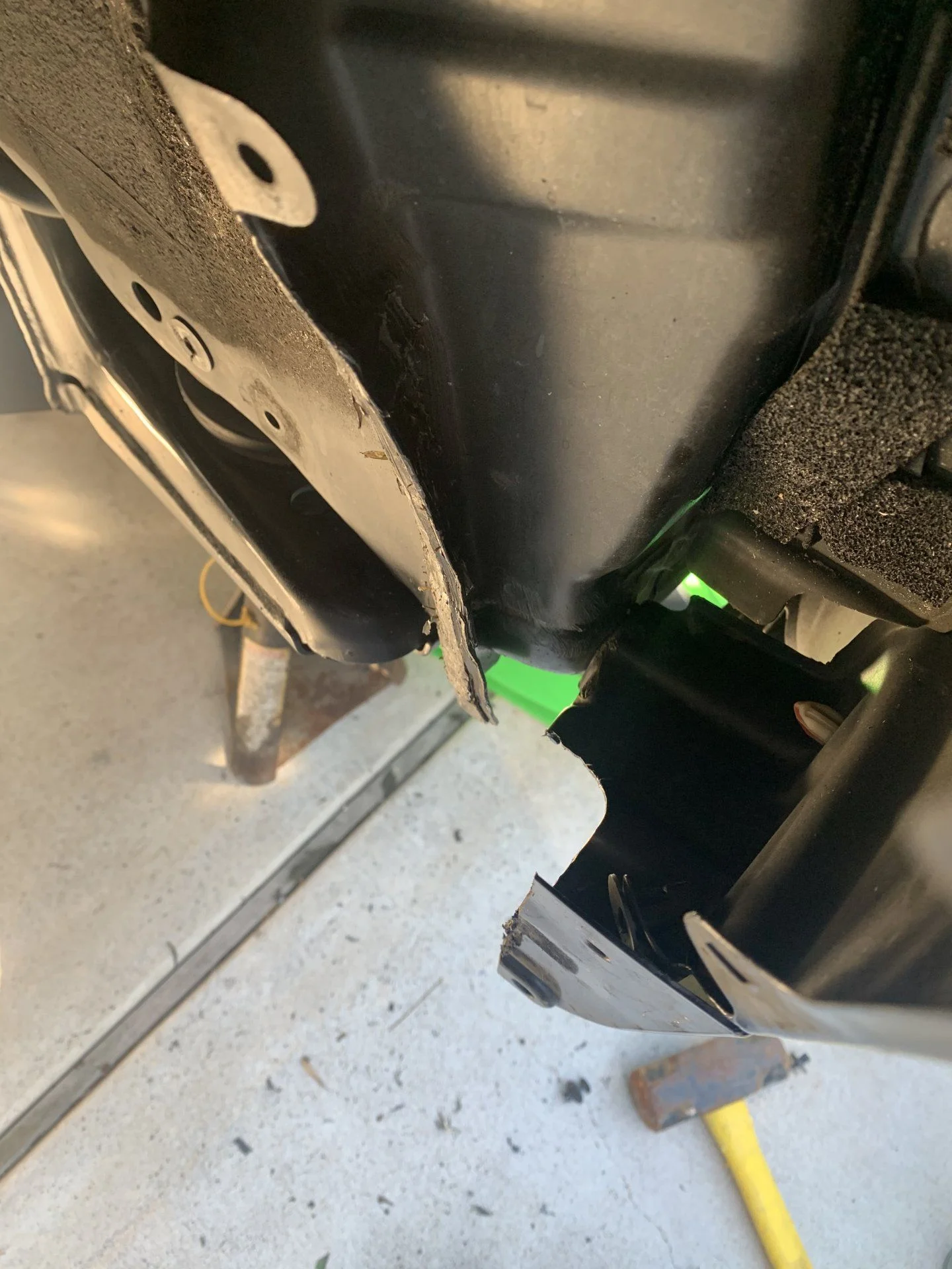

Vise grip and bend method seemed to work a little better than BFH for me.
sealed up the sandwich with some rtv...

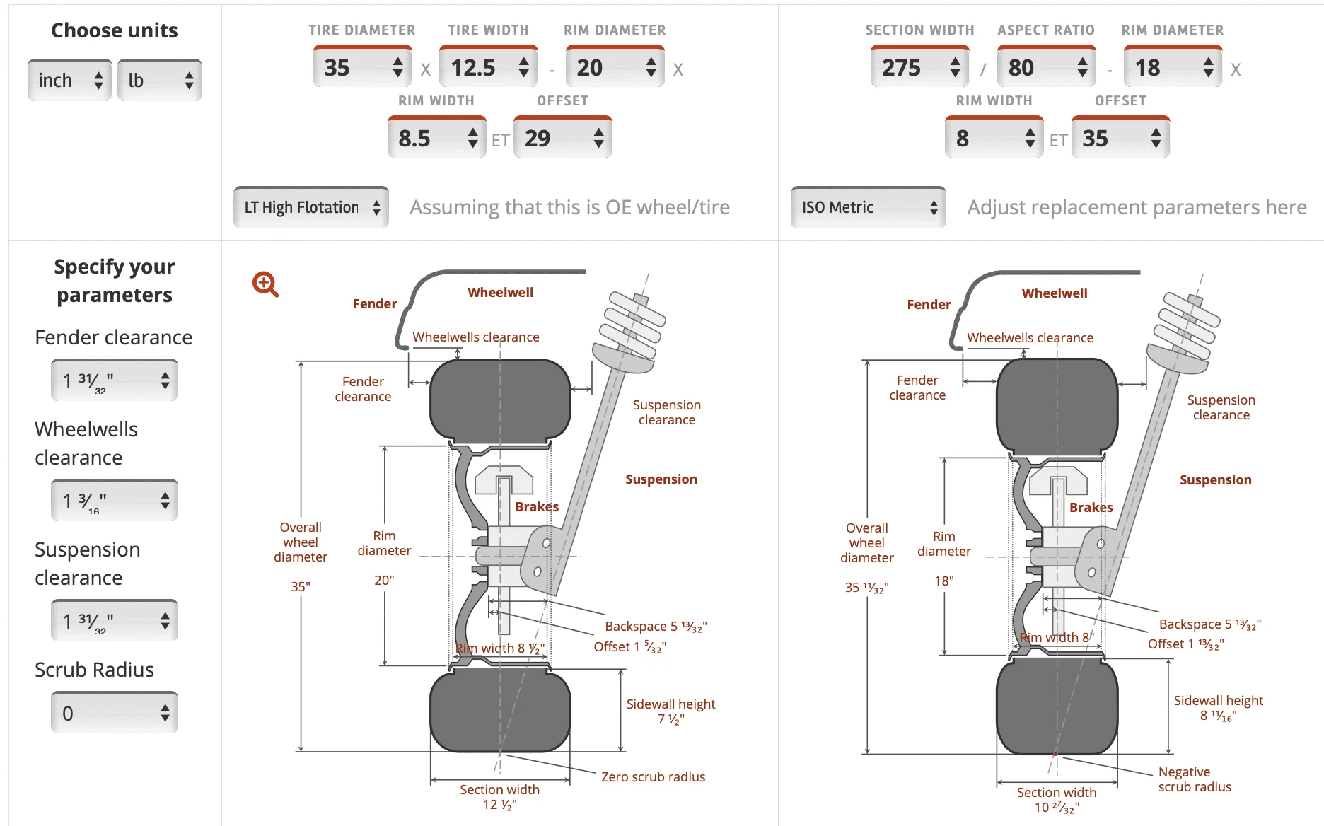

Back of the napkin math tells me for a 34.5" diameter tire, optimal offset based on the kingpin inclination angle should ~36mm. With a 1" spacer, I'm effectively at that A 1.25" spacer would put me at 28mm offset. Both close enough to stock geometry that it shouldn't produce much different feel or handling.
Optimal offset is based on overall tire diameter. The further one deviates from good geometry, the more impact it may have. A 33" tire for example wants about a 48mm offset. Running a 1.25" spacer on that setup may have more undesirable symptoms.
What's the best direction to fold the pinch weld? In the "Nor Cal Mods" video I saw they fold it to the inside but you guys are folding it to the outside.
Hey @TeCKis300 i thought you might find this interesting:
The host asserts that the narrow voids on the RG make it more if a highway tire compared to the Toyo. Anxious to see more long term reviews of the Toyo. They look promising so far.
i went towards the steps (away from the body mount). In the images above, you can see that there's a bit more room this way.
@supercarrera Same with radman. I folded towards the outside as this opens up the most clearance for me. Folding outward didn't require folding it flat. Folding inward would be about where the tire turns into that pinch weld and would need to be folded more aggressively.
This may depend on your wheel offset. For lower offsets, (+25 or lower), may need to consider where it needs the most clearance to decide which way to fold it.

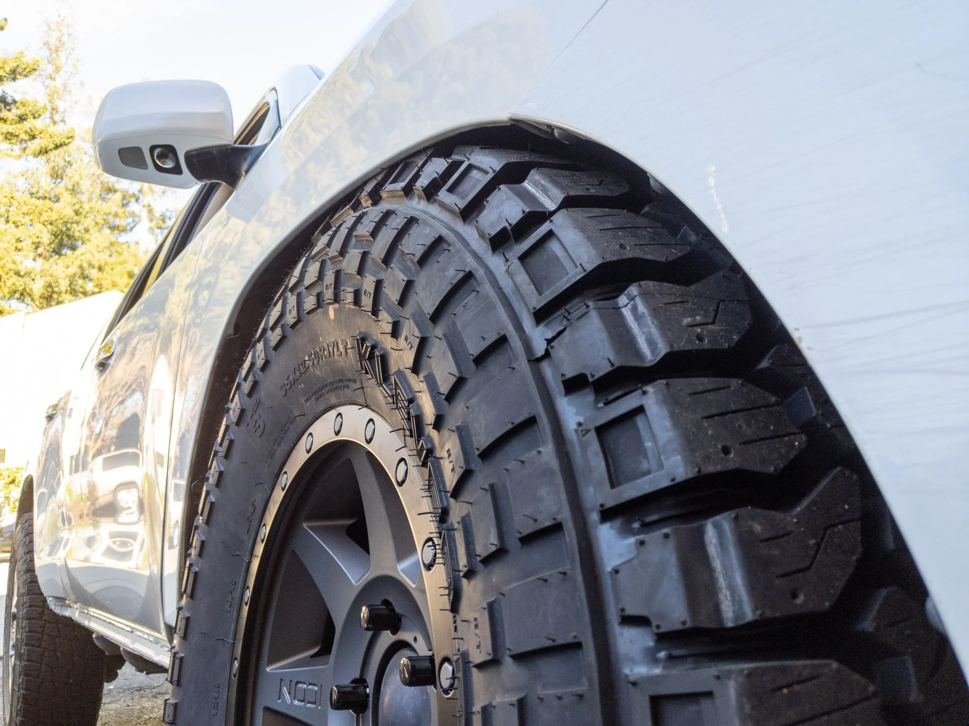

From my last wheeling trip in the desert, I've found that on full squish that the top of the front tire will just contact the upper fender well liner. This is part of the reason why I worked to keep the 1" spacer (+35mm effective offset), rather than switch to the 1.25" spacer (+ 28mm offset) as I expected the clearance upwards and against the fender to be tight.
Easy fix. Pulled the 3x push clips securing the liner to the fender. Orient the liner fully above the fender tab. Gently fold the fender metal tabs by hand tighter against the fender (don't bother putting any clips back). Heat gun to rework the areas with rub marks.

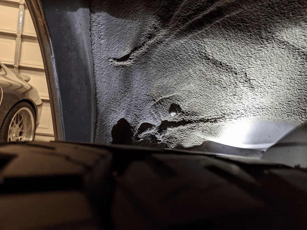

One area in the rear fenderwell mentioned before was an interior anchor bolt that protrudes into the well. I may cut the extra threads off to minimize any potential just in case.
What better way to relieve the week's work stress than to go into the garage and zip some metal off. Quick operation with an angle grinder and some touch up paint. Took off about a 1/4" of threads that protruded into the wheel well. At least if the tire were to contact now, it won't get its treads ripped up. Thanks for asking @supercarrera

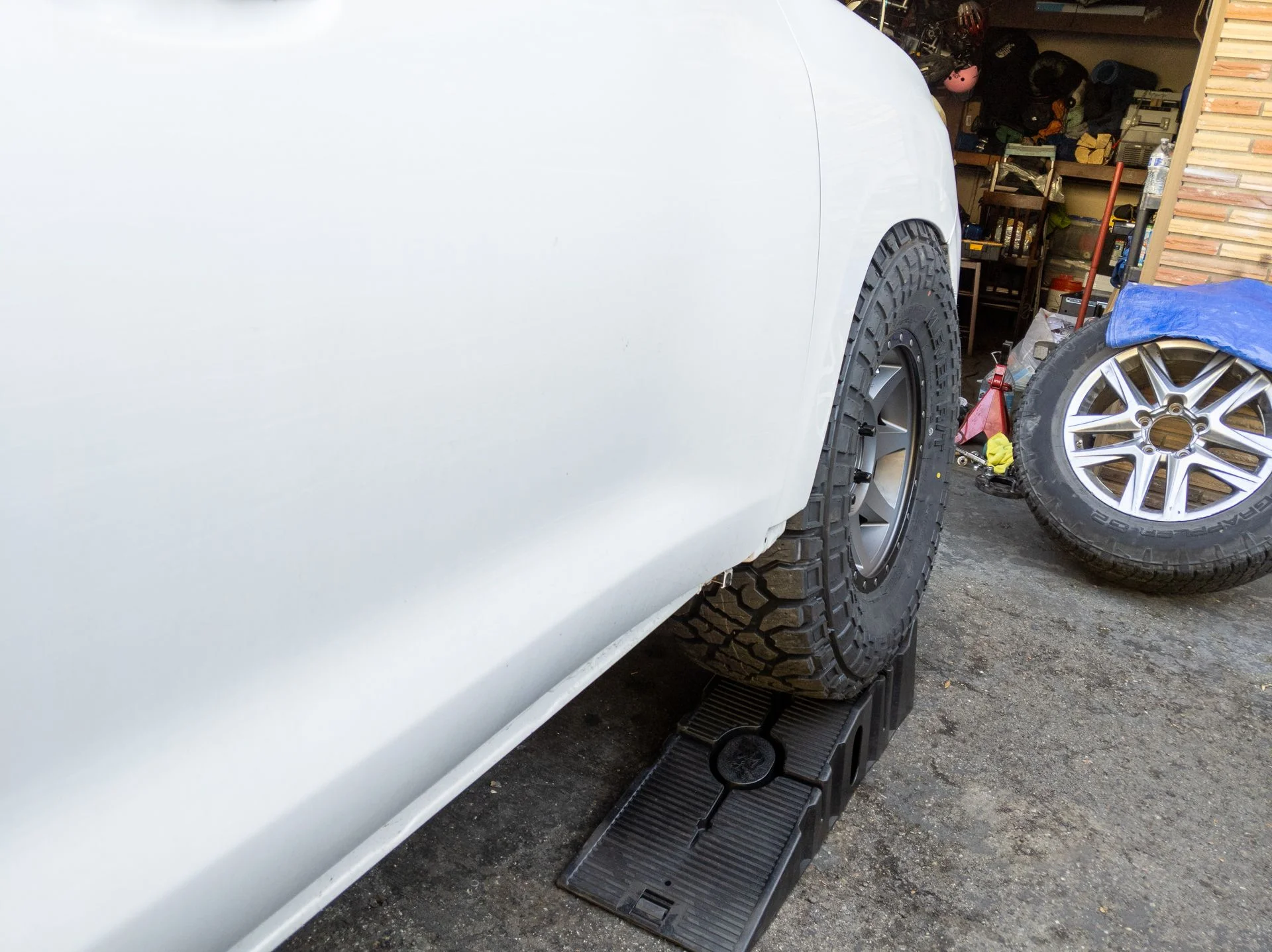

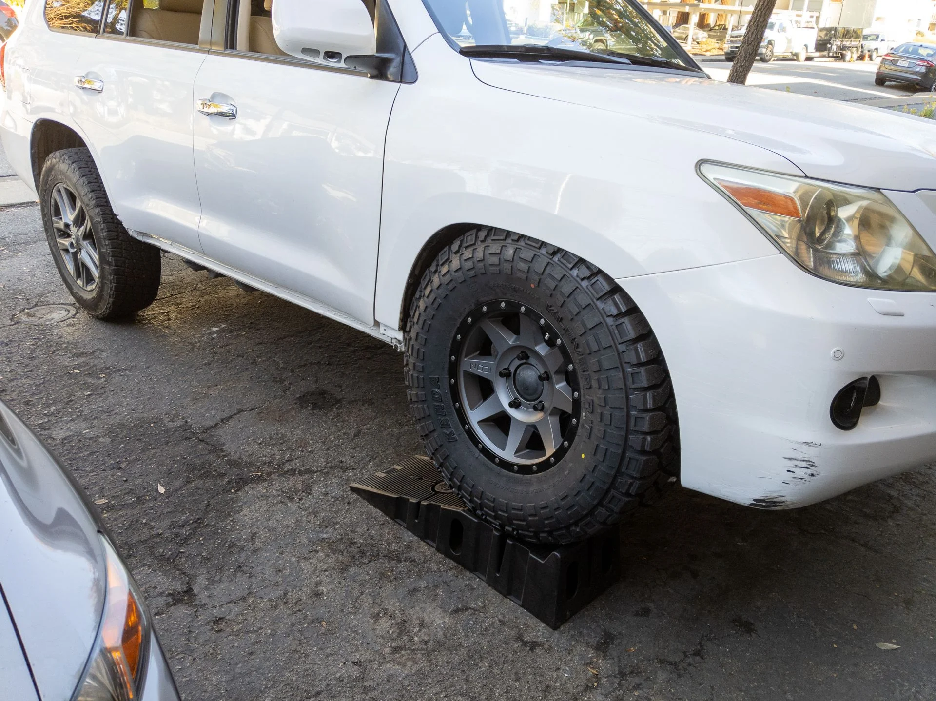

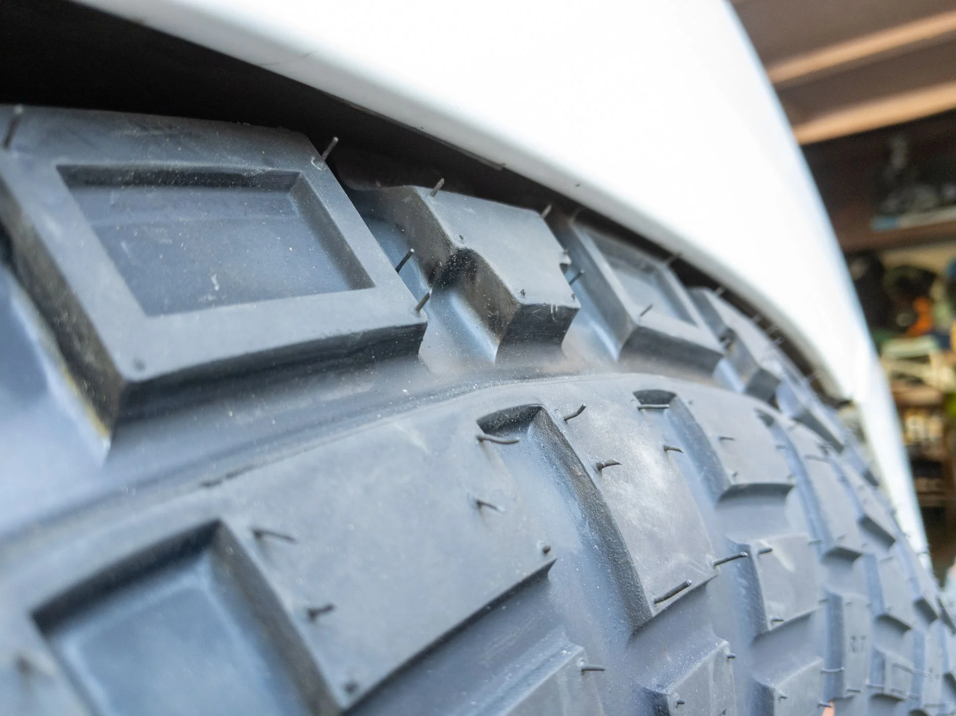

As I mentioned in the "What did you do with your 200 this week" thread, I'm trying to fit Kenda Klever R/T 35x12.50r17s. I thought I would follow up here since this is a dedicated fitment thread. I think I have enough clearance everywhere except for front fender at full stuff as @TeCKis300 predicted. I actually have 1 or 2mm clearance when the tires are pointed straight ahead but if I try to turn the wheel at full stuff it will be bad news:
The slightest of clearance:
Contact!
