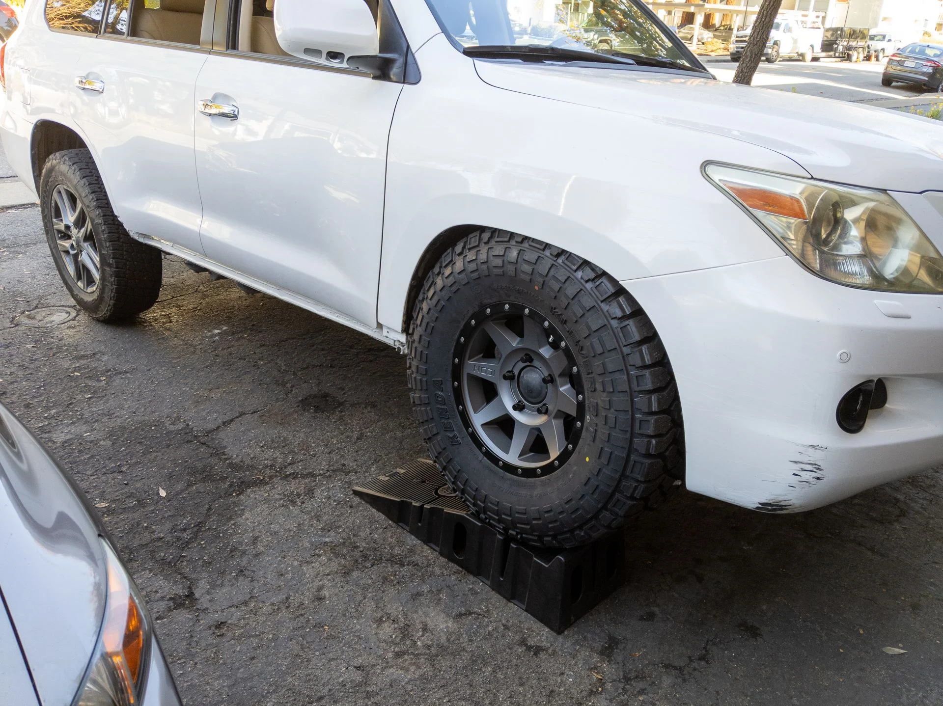

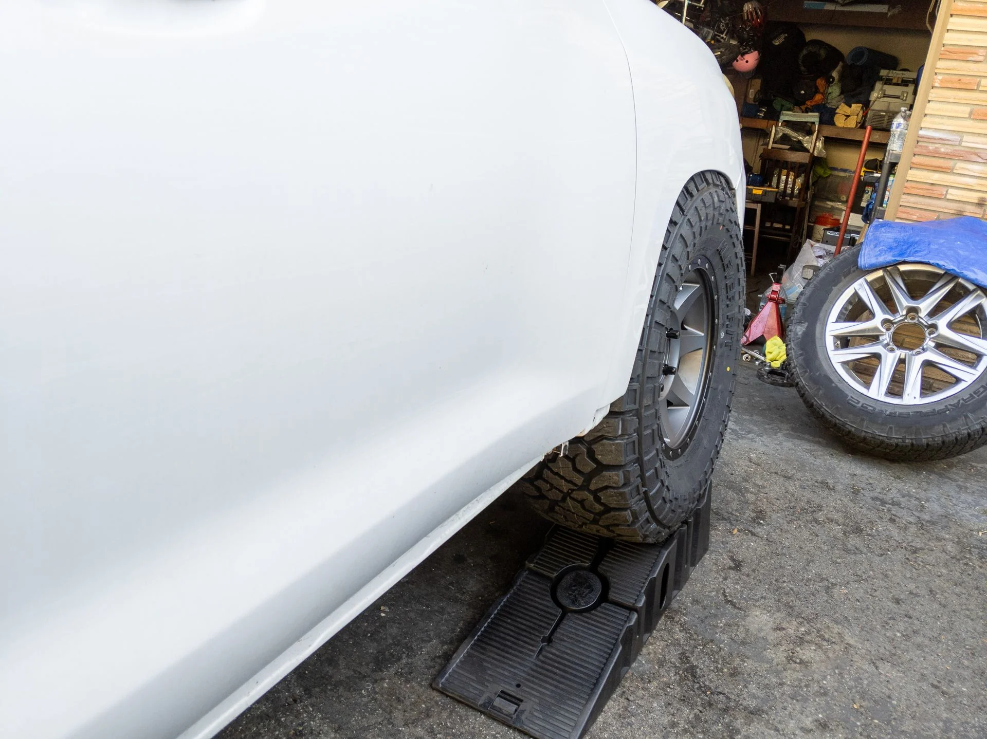

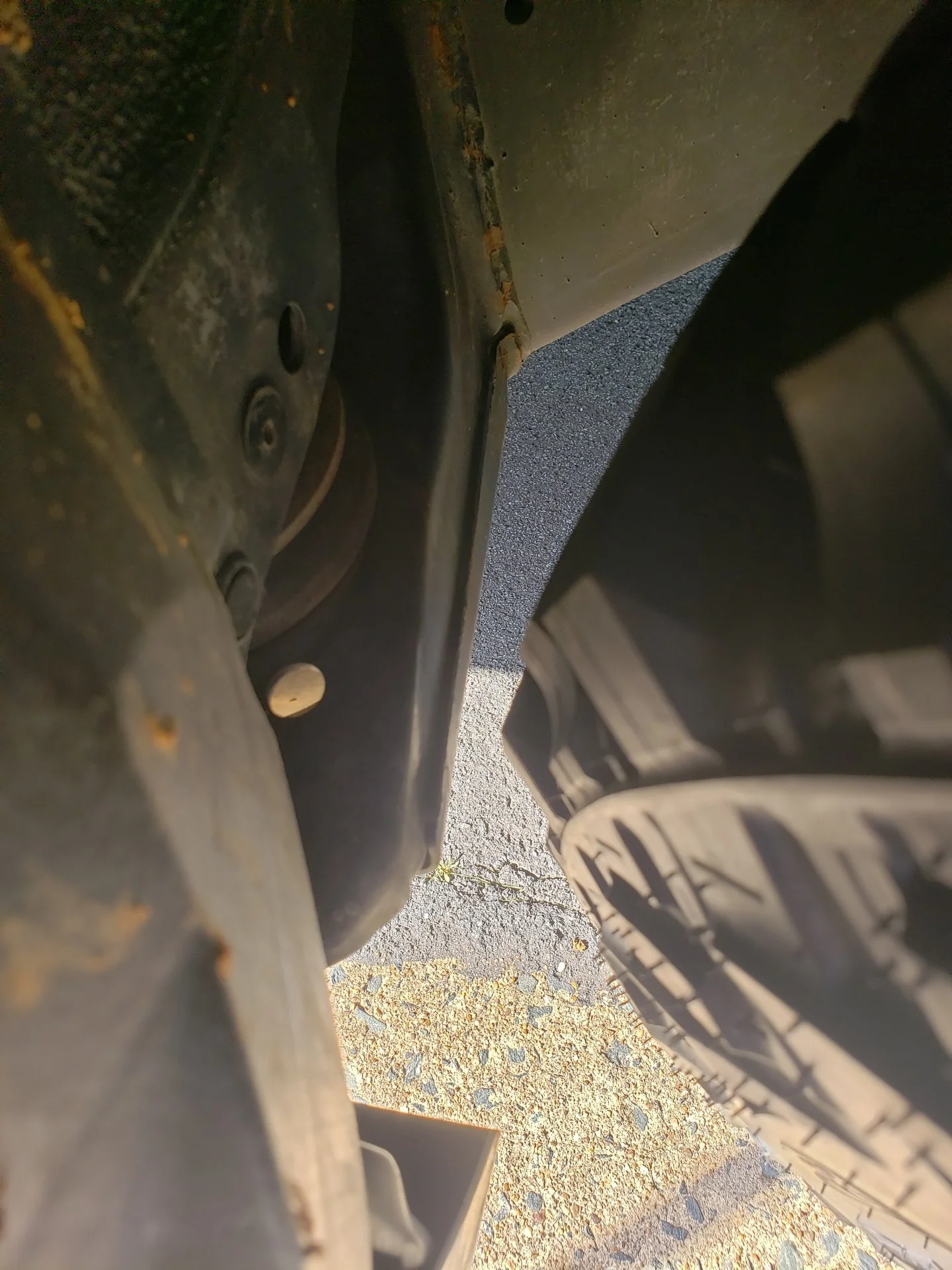

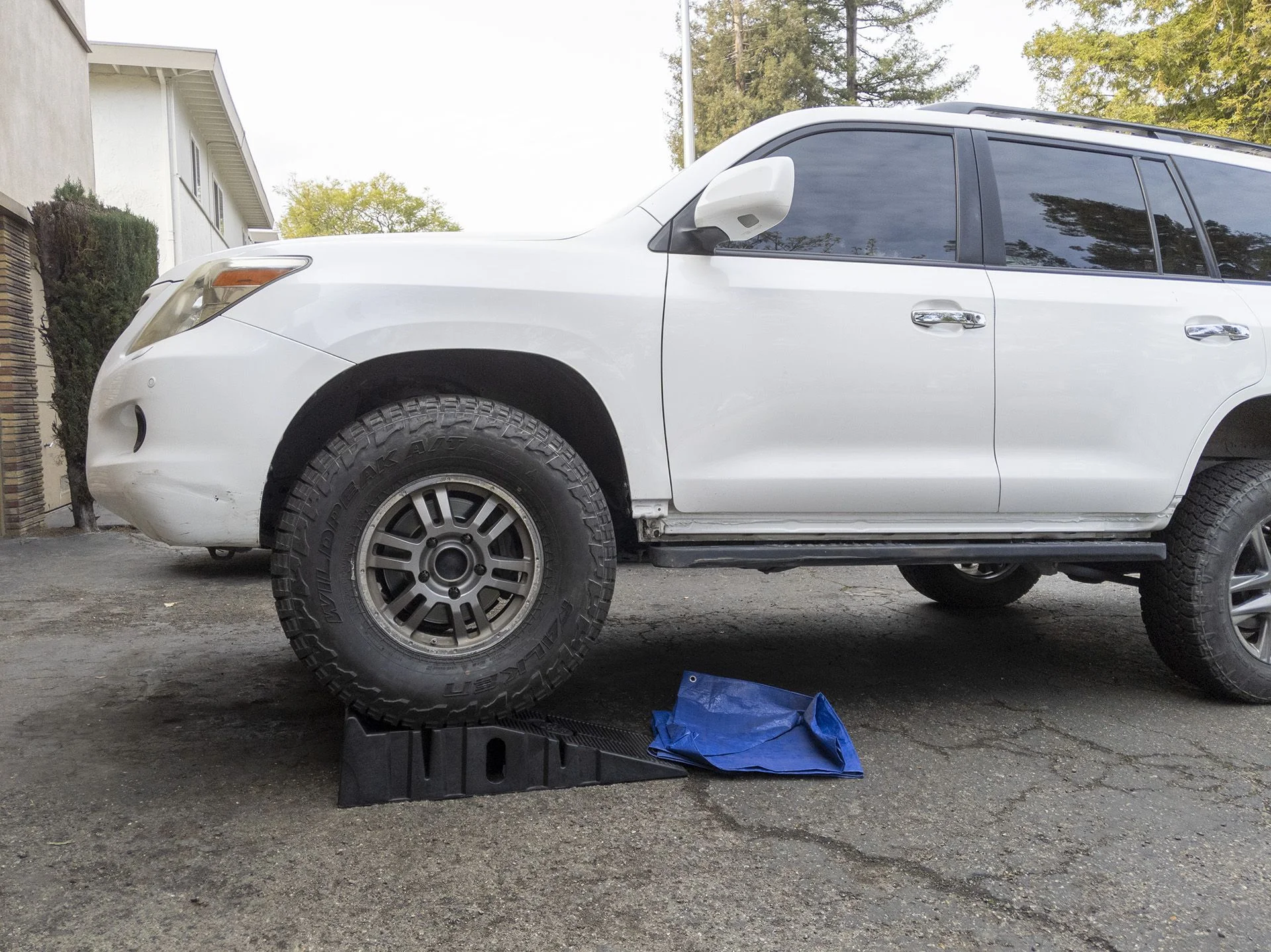

As I mentioned in the "What did you do with your 200 this week" thread, I'm trying to fit Kenda Klever R/T 35x12.50r17s. I thought I would follow up here since this is a dedicated fitment thread. I think I have enough clearance everywhere except for front fender at full stuff as @TeCKis300 predicted. I actually have 1 or 2mm clearance when the tires are pointed straight ahead but if I try to turn the wheel at full stuff it will be bad news:
The slightest of clearance:
Contact!

Seems like a good candidate for a small body lift, or a good body shop that might be able to push the lip out ever so slightly and allow you to still use your inner fender liner. I don’t recall what size spacer you are using. Can you bring the wheel in at all and still clear the UCA?
It doesn’t look like you are far off, however expect a little more compression while driving considering the dynamics of the weight transferring to that corner if you are going downhill, or a little bounce. A third option could be an extended bumpstop, but this would be my last resort since you don’t want to reduce uptravel if you don’t absolutely have to.
But don’t give up!

Impressive flex for one ramp. Are you in low mode?
Yeah low mode. I'm guessing that stuffing the tire would look more or less the same in the other modes.

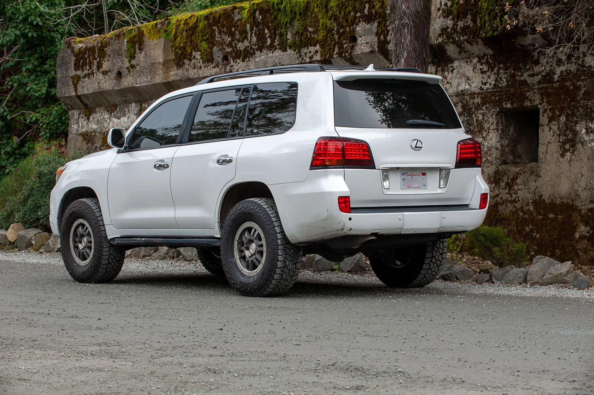

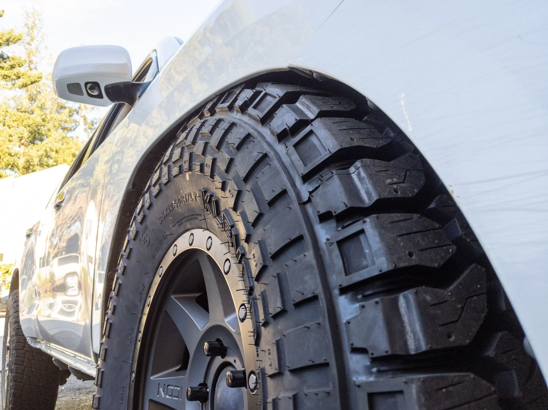

I decided it would be easier to work with less offset than +25 so I found a set of rock warriors. By using the RWs with the .75" spacers I already have, I reduced the offset by 6mm to +31. I also took back the Kendas and bought a Wildpeak AT3 to try out. The slightly smaller size of the Wildpeak is easier to work with. I'm pretty sure I'm going to go with this setup. The size of the Wildpeak is 315/70/17. I chose that over the 35x12.5 because the 315s are approved for 8" rims and the 35s aren't.
The upper front fender still looks to be an issue, but there's a few millimeters more clearance with this setup than with the Kenda's. I'm not exactly sure how to handle that yet. I might need to break out a sawzall after all. :cool: The picture below is in high mode.

For the upper fender interference, some options or a combination of these options
- shim bump stop or add larger aftermarket bump stops. Though this would compromise suspension travel to a degree
- roll fender, an Eastwood fender roller would make quick work of it
- bodylift. @MTKID just did his with stock bodywork
Check your UCA - I think you'll be connecting on full lock/full bump. I barely clear 275/80r17 on rock warriors w/aftermarket UCA barely, and my tires are 1.5" narrower (taking into account your spacers)

It's tight at full lock but no contact with the UCA. Finally got the other 3 on. I haven't really dealt with the upper front fender yet. I don't think I really need to until I know I'll be flexing it out.
