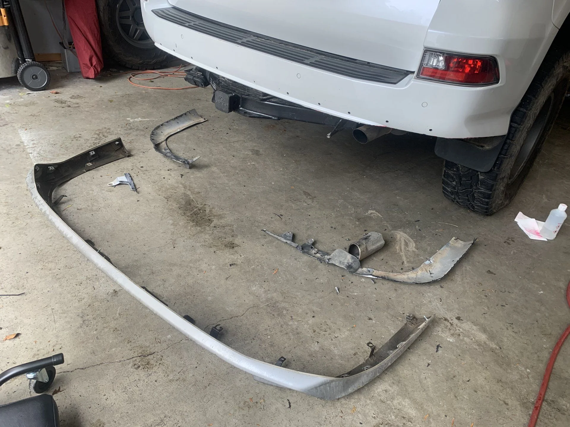

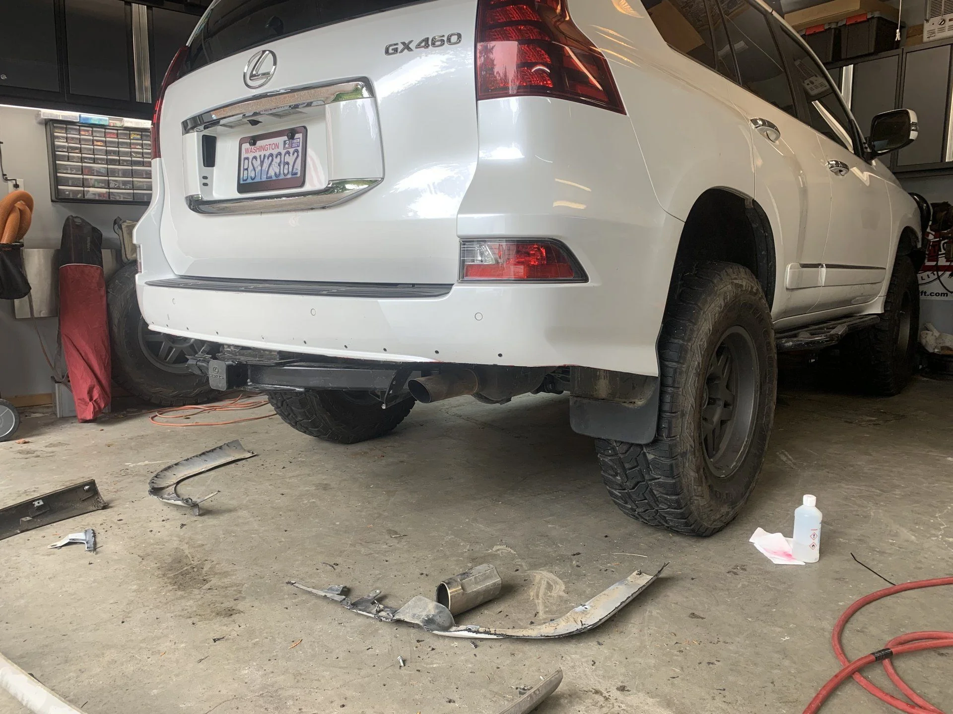

Thanks, a few steps not covered but I just drew on the plastic with a red sharpie. But after years cutting on far more expensive machinery it all comes second nature. Filing is a must to produce that smooth factory edge. Start with an aggressive bastard file and work your way down to a fine file.
It's about a 2-3 beer job. ;) :beer::beer::beer:

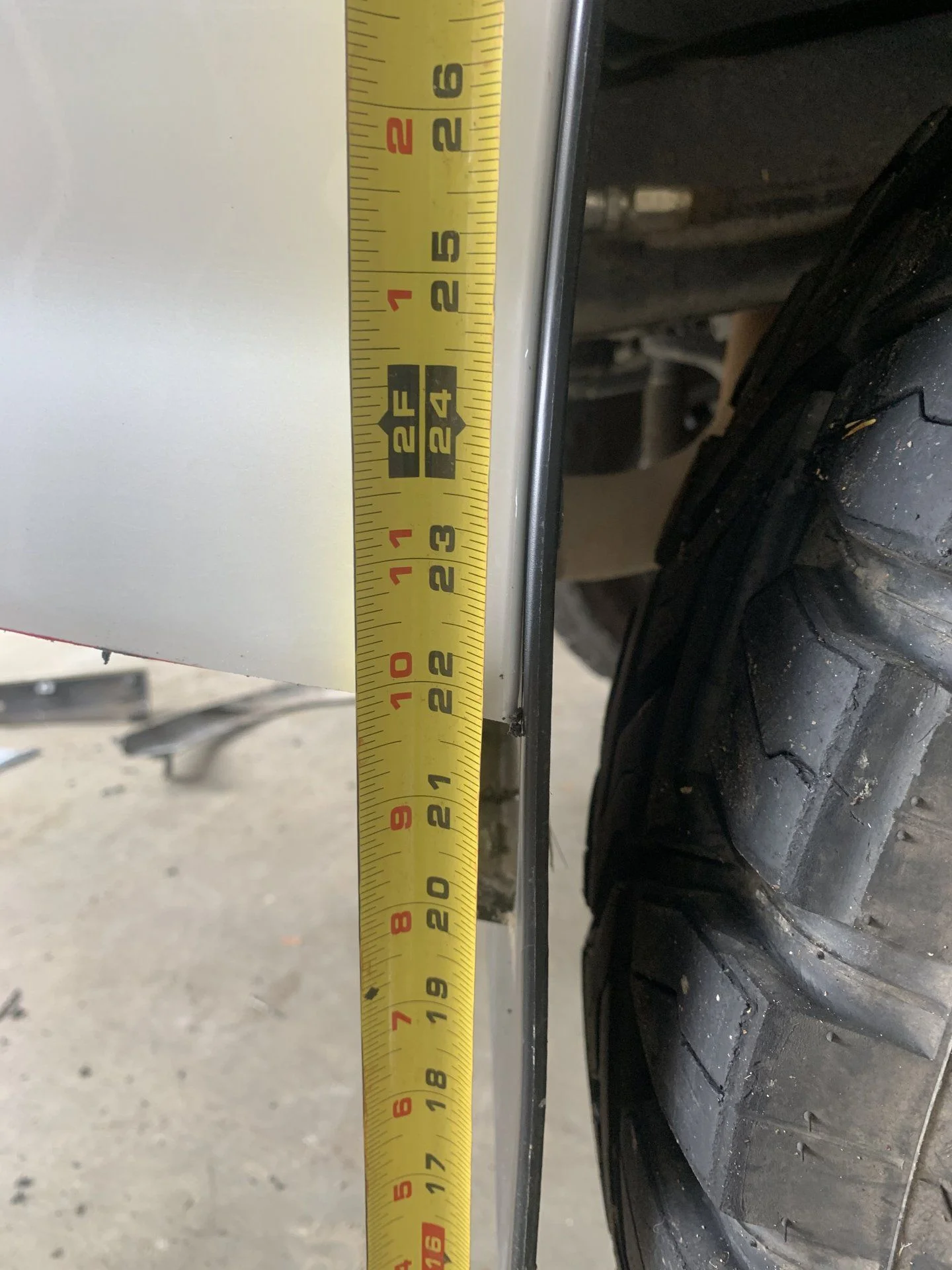

yes. after i trimmed the front bumper the height at the front was 16.5625 inches and the length from the front axle was 36 inches. which increased the approach angle to about ~24.7° = tan⁻¹(16.5625/36). i think this is pretty good since a 2 inch lift and 33 inch tires would increase the approach angle to ~25° from my calculations. plus it is a lot cheaper.
i'm on stock size tires and stock suspension.
from what i can tell tan⁻¹(9/15) = 30° is the maximum possible approach angle on stock suspension and tires.
