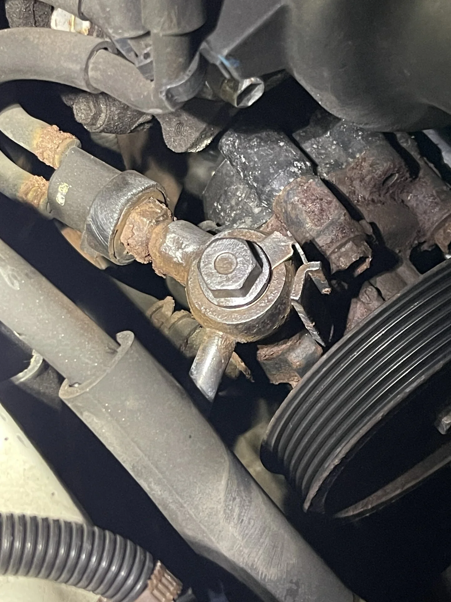

The power steering pump is pretty heavily corroded and I imagine it’s original so I think it’s just time for it to go. Though I am wondering about the union bolt area, I took a photo of it and I’ll add it here. There’s a decent amount of corrosion on the hose connectors there and I definitely want it to be freshened up, is there a way to just replace this connector or do I need a whole power steering hose assembly? That assembly seems to be inordinately expensive for OE, I seem to remember seeing it for $450 or something silly like that.
