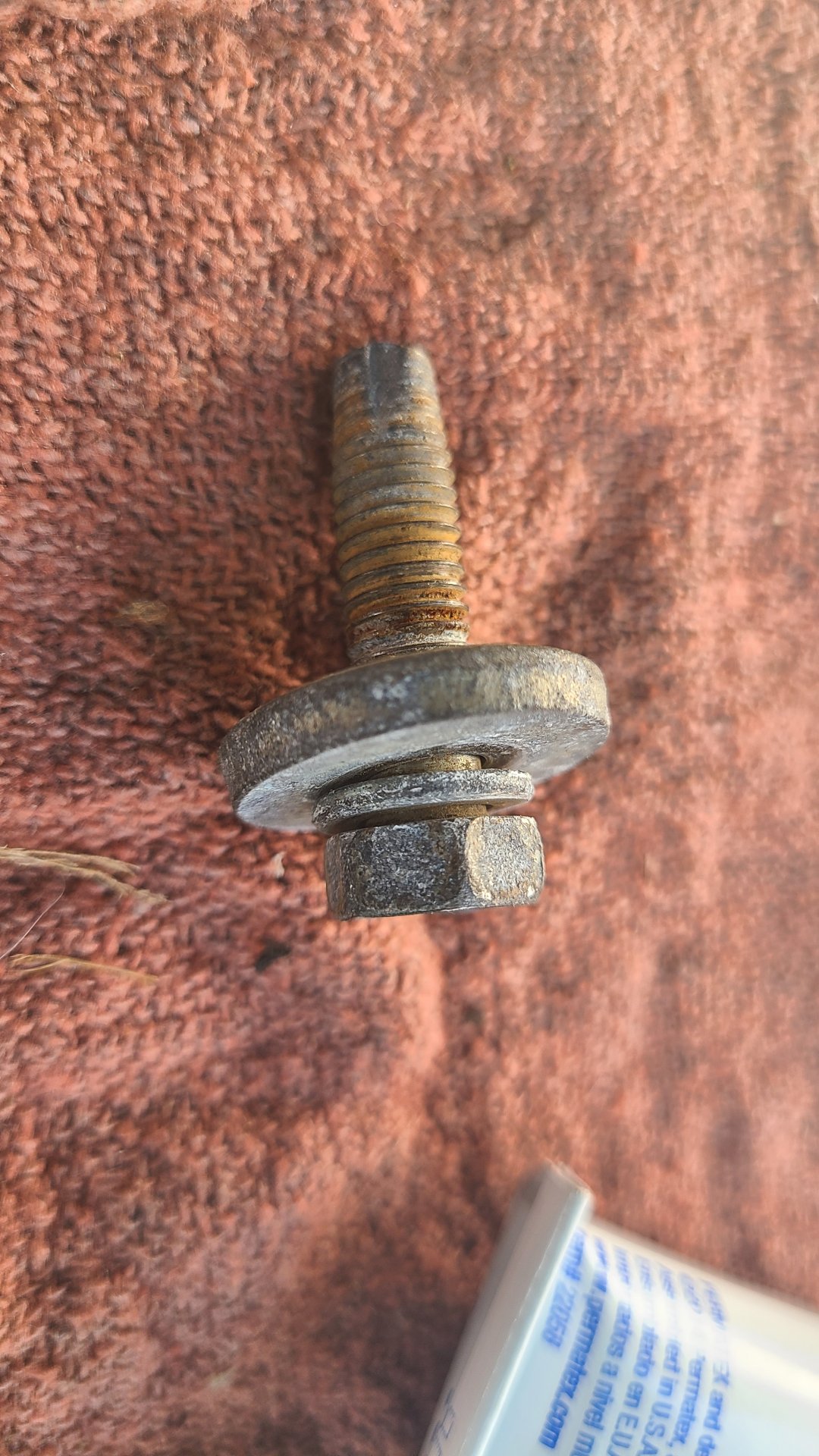

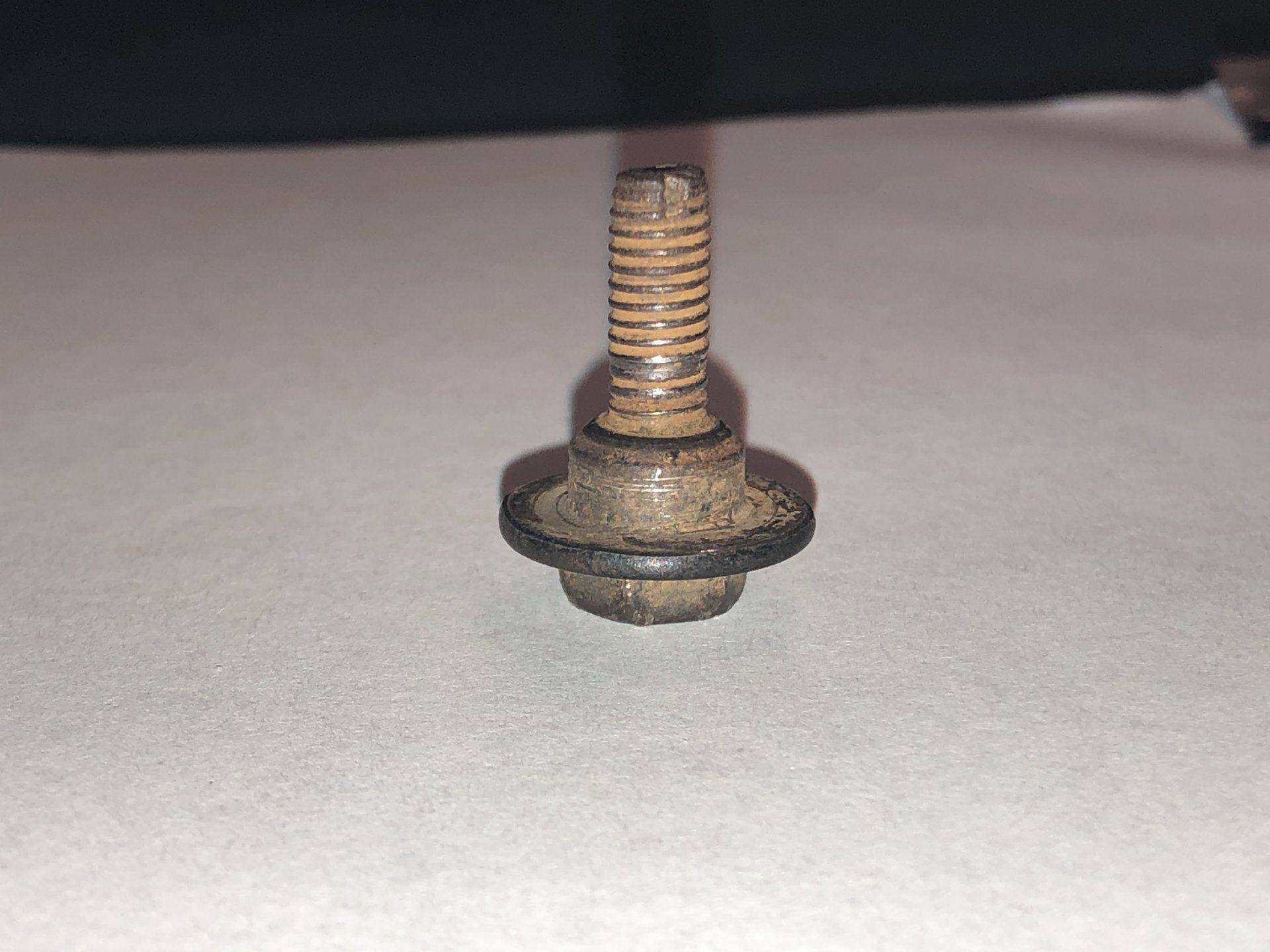

Missing a few of these, M8x1.25x30 with captive washer and lock washer. Source?
@scottm the metal tab is to keep the stock oil filter housing from loosening on its own. Most of these have them bent so they don't even do that job anymore.
Also note that there are two different bolts of that thread/pitch. The pictured one goes into the two square holes on each side metal splash guard, and six go into the plastic under-engine/transmission guard.
There is a different part number with a smaller washer that go along the inner edge of each of the splash guards into the metal strut that connects the radiator support to the suspension cross-member.
And two more of the one you pictured hold that strut to the support and crossmember.
I can't remember whether it's the large or small washer version that go into the oil drain plug hatch.. don't think it matters either way.
Thanks, I'm trying to get them where they make sense. Several dealership oil changes, lost some bolts, moved some, threw in some odd ones (at least they tried). All had low-strength thread locker after I installed the bumper, re-applying this time around.

@scottm I can't remember whether it's the large or small washer version that go into the oil drain plug hatch.. don't think it matters either way.
Small washer. You could diy it at most any hardware store.
The factory parts with the captive washer and tapered end are convenient.
