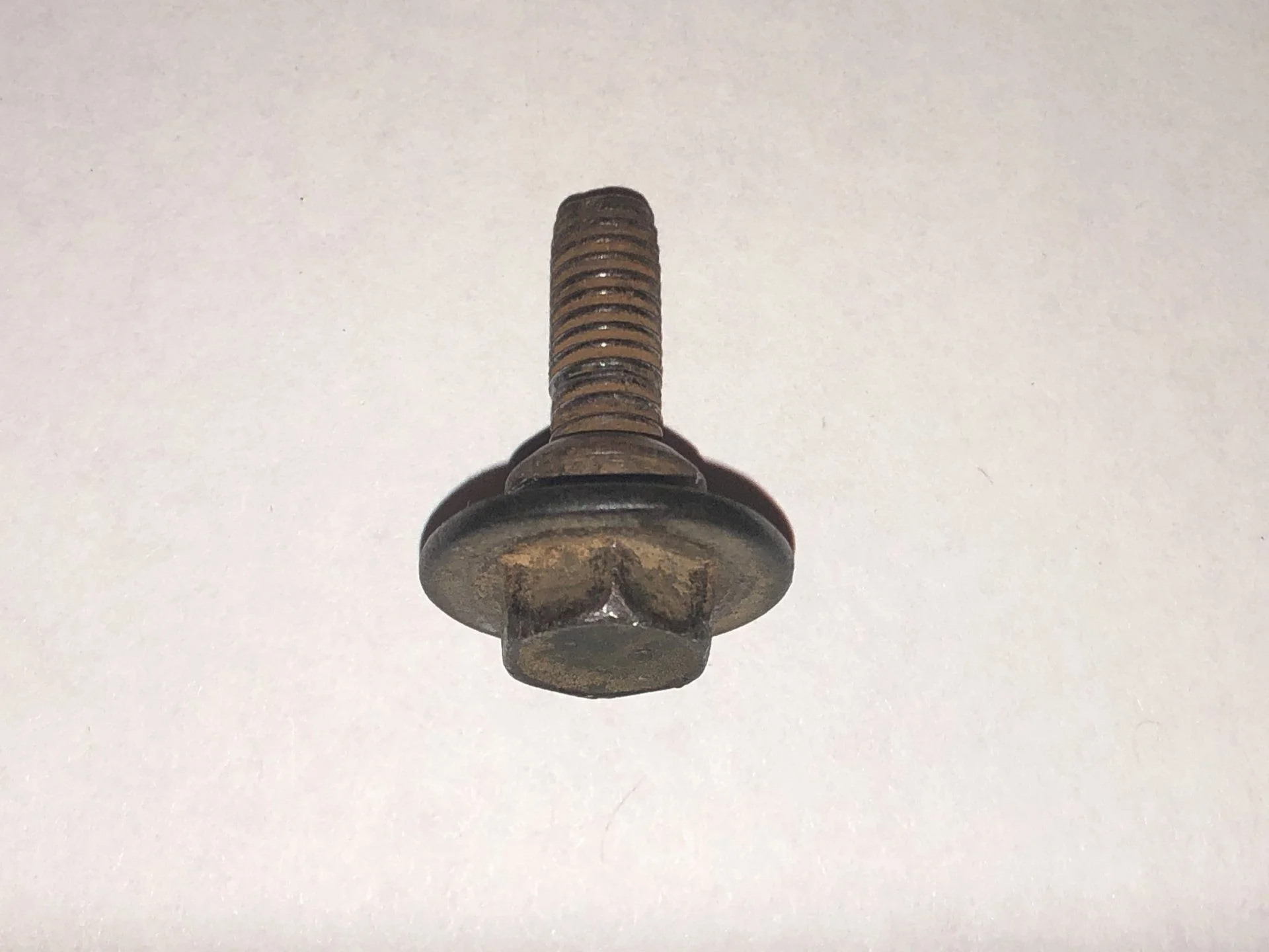

Anyone know the part number for this bolt ? It goes in the factory skid. I think there are 6 total.
While you are at it run a M6-1 tap into the insert for it, then grease the threads of the bolt when you install.
So I just went out and pulled the bolt in question. It matches yours. It may be that Toyota has simply superseded this bolt with the other 10mm, but I am looking into it.

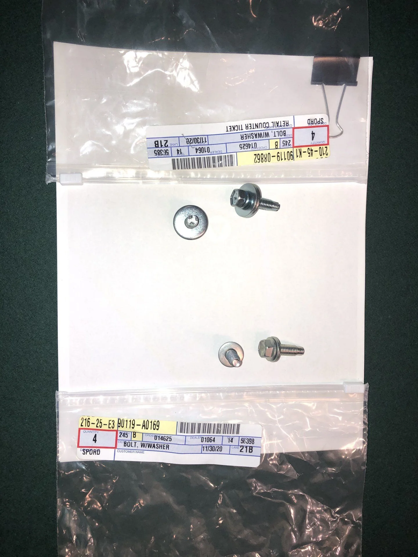

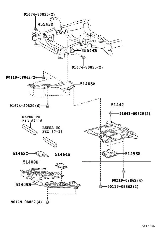

90109-06375 is the first pictured M6 flanged bolt, it goes through the side plastic splash shields into the skid plates.
I ordered a new one of these a couple months ago. They haven’t changed from the originals on my truck since 2013.

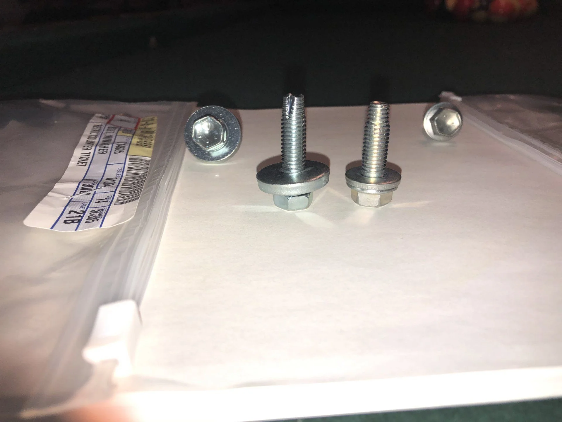

I’m replacing all of the skid bolts. These are the other two sizes that were in the skids View attachment 2516918View attachment 2516920

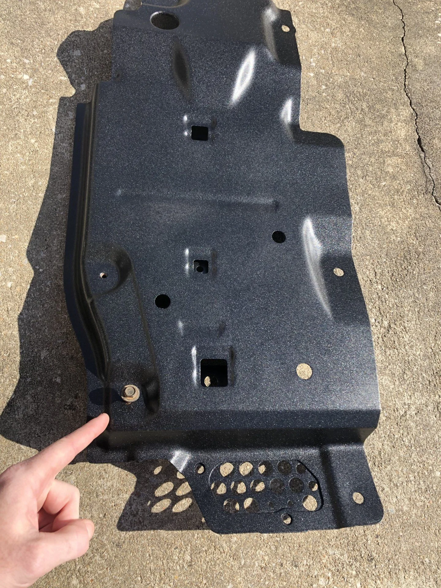

Also if you haven’t figured it out yet, the small washer bolts go through the inboard edge of the skids into the center rib structure that connects the front crossmember to the one under the engine. Also two go into the oil drain plug access hatch on the plastic skid.
The large washer bolts go everywhere else.. one each into the two deep holes in each side skid plate, four into the front edge of the large plastic skid, two into the rear corners of the big plastic skid.

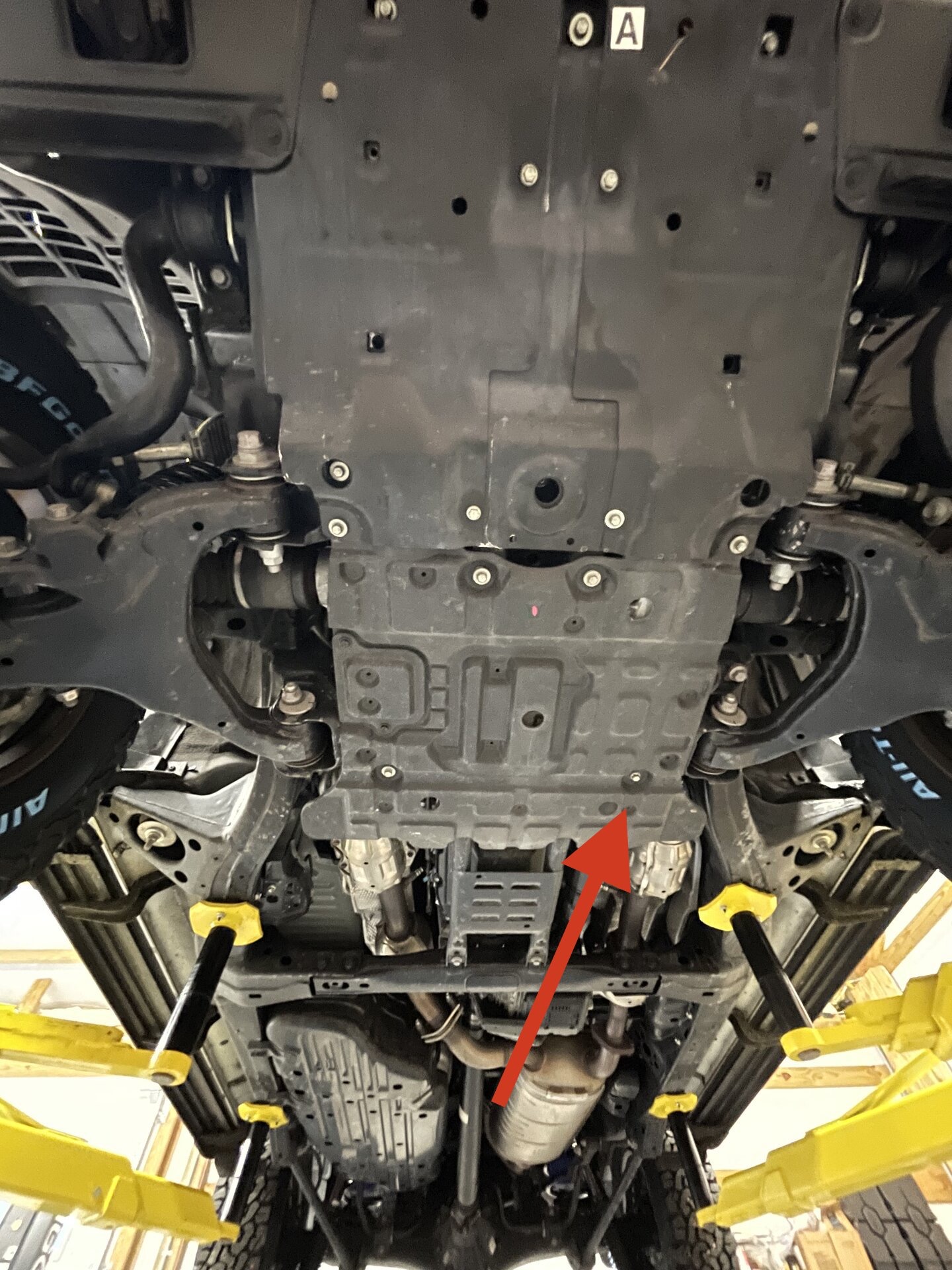

Surprise... dealership lost a skid plate bolt on my '13. Aftmost bolt, left side. I can't seem to determine whether it's a 9011908862 or a 9167480820.
