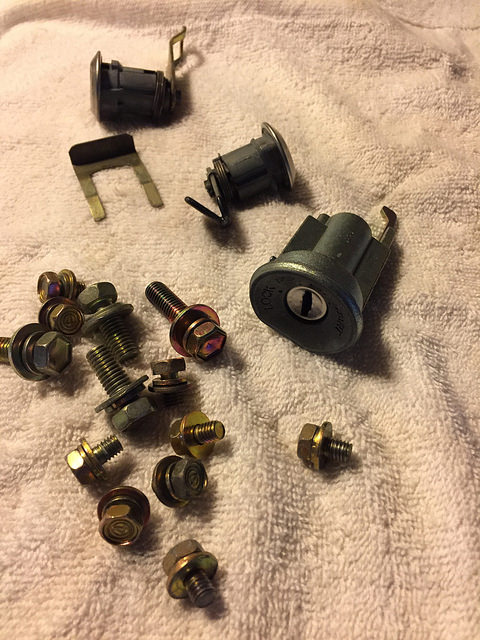

Yesterday my buddy and I ran to Pick n Pull as a rarity showed up, apparently they had gotten a 85 FJ60 in the yard so we ran to see what was available and scavenge parts. Got there only to find that the thing had been there for a couple weeks and was just about completely picked over. Seeing as it was 50% for toolkit members for the holiday I picked what I could and came away with an $80 bill. Body was in decent shape, rust in the normal areas but had been in a rear end-drivers side crash which probably put it there. Engine and entire drivetrain with axles was gone, front fenders, hood, passenger doors and rear liftgate were gone, headliner and seats were gone and most of the dash was torn apart. All glass but the drivers window was shattered and just about every accessory under the hood was gone.
Ended up walking away with..
- drivers window
- clean exhaust downpipe to just after the EGR port that attaches (someone cut off right there to take cat it looks like)
- Charcoal cannister
- Ignition cylinder
- Drivers door lock
- HIDE-A-KEY with original key in it!!
- various pieces and bolts for like window regulator
- holddowns for the rear seat back on the c-pillars
- Emissions control computer for the ICS

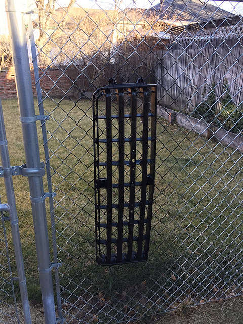

First order of business was to pull the headlight doors and sand them down to repaint. The paint job that I did when I first bought her is starting to flake off finally and the peeling chrome beneath wasn't helping. Took a nylon wheel attachment for my drill to it to get everything off but not go too hard at the plastic and it seems to work a treat. Got a couple coats on the headlight doors yesterday and will do another one or two today, grill is already completed.
Untitled by Greg Fisicaro, on Flickr

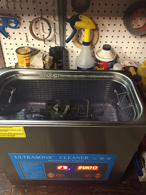

While this was going I was pulling the rear wheels off to work on the bellcranks (didn't take pictures of course) as my passenger side bellcrank was pretty much frozen. The bolts and cylinders that I had grabbed from the yard were in the buzz box to see how well the dilution of the Simple Green PRO HD (purple) would clean them..
Bolts came out sparkley and new and the cylinders looked pretty good once done. Cleaned them under hot water, per the instructions, and then blew everything out with my compressor.

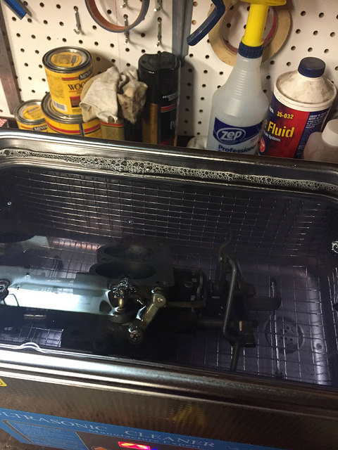

After that the fun part came of disassembling my carb slowly, section by section, and throwing in my solution of Simple Green in the buzzbox. I have the heating element going on it up to 60*c and running for a full 30 minutes. I had created my own little basket out of two sink strainers that I picked up for a couple bucks each at Bed Bath and Beyond to hold all the small parts. And worked between the carb and the bellcranks. Passenger side bellcrank was pretty much frozen (takes a hammer to get it to move) but I was able to disassemble and throw everything into the cleaner. They came out pretty dang cleaner and I was able to sand down the rusted spots on the arm itself and then filed the body as well where the plates that are a disimilar metal are. Eventually I was able to file everything down enough in the body to get the arm to go in pretty easily but still be semi tight. Then I used a drill bit to open up the pin holes in the body that hold the arm to the body just enough so they will press in nicely.

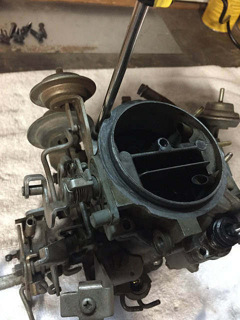

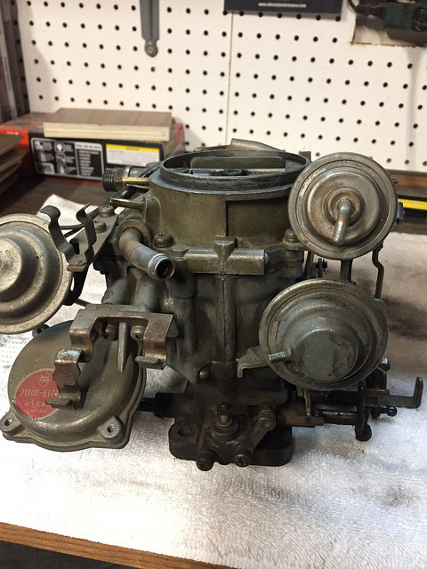

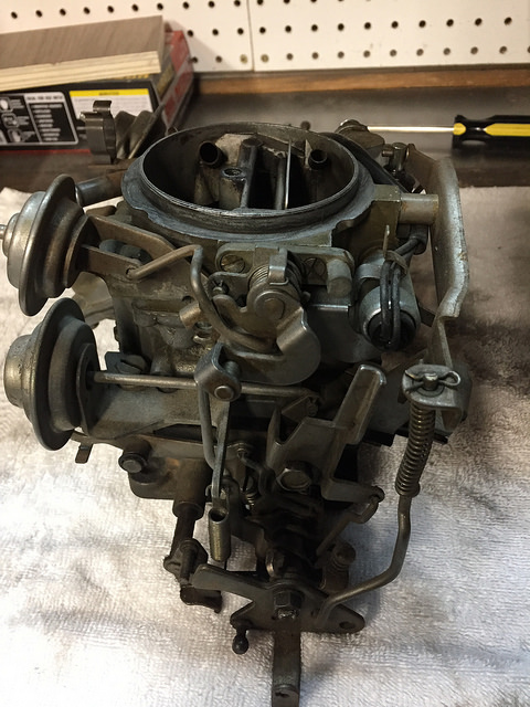

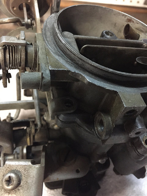

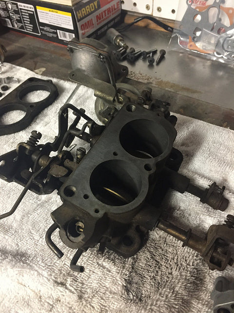

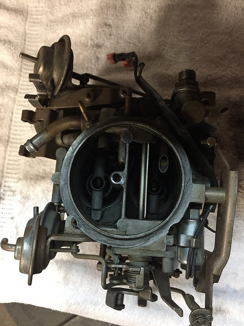

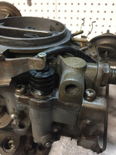

So here are some pics as I have been going through the carb. Got it 2/3rds of the way done so far, finished last night around 10 and called it good. I reassembled the top hat as much as I could to ensure that all parts were going back where they belonged when I threw the fuel bowl section into the cleaner. With the carb body I am actually doing two cleaning cycles with the buzzbox to ensure everything gets nice and clean.

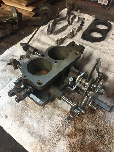

Here are some detailed before pics of the carb as I was getting ready to disassemble.
Here you can really see how varnished and crappy the accelerator pump is on the outside. I dont feel like the one in the Keyster kit was making a good fit but I have an OEM from CityRacer to replace the keyster kit one.

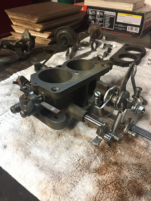

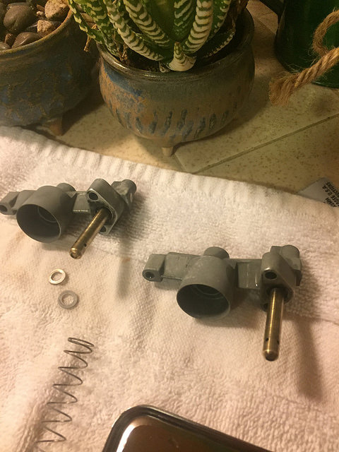

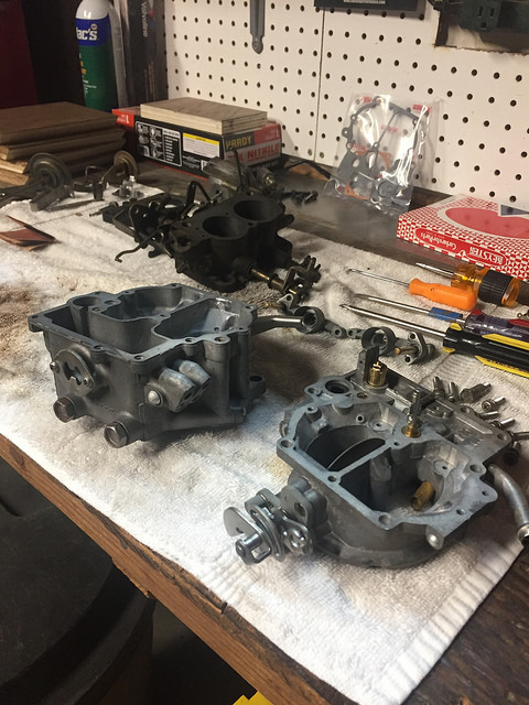

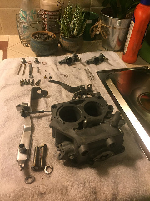

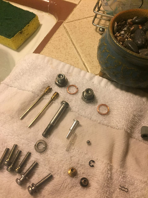

And here are some after the cleaning.....
Seems like the light in my kitchen casts a really really yellow light, so here is some comparison in the garage with the new LED ballasts from Costco. Much cleaner and brighter light, so glad I grabbed them when they were $20/ea a few weeks ago!.
You can really see the difference between the two upper pieces of the carb and the base in the background! So far this buzzbox has been well worth the $100 spent on it.

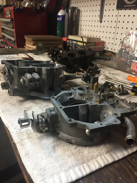

The base didn't come out with the drastic difference that the two upper parts of the carb did but still pretty damn clean. Left it in a while long as my buddy called to go for a ride right after I put it in for a second go round.
So before...
and after...
Definitely where you see the most difference is the linkages. I am not using any sort of scientific or calculated method of mixing the simple green and water so that may play into how much cleaner the items get. But yes.... @OSS and @NeverGiveUpYota this thing has been more than well worth the money, kinda wished I had grabbed a larger one but oh well this works perfectly for almost anything I have thrown in there.

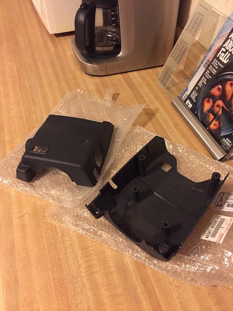

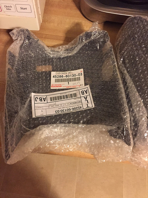

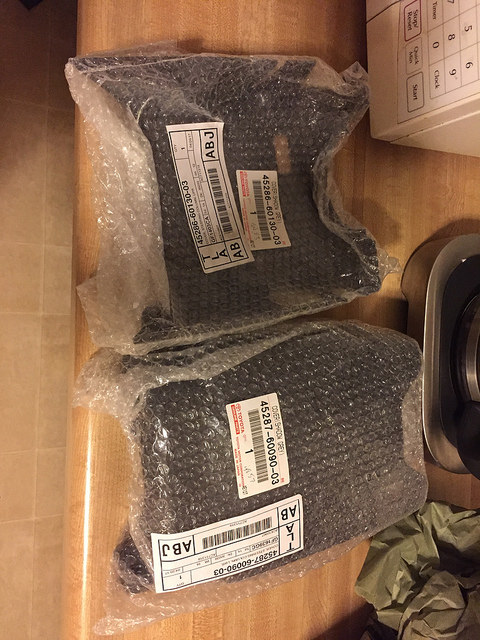

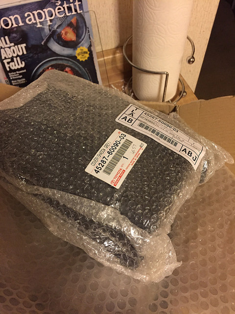

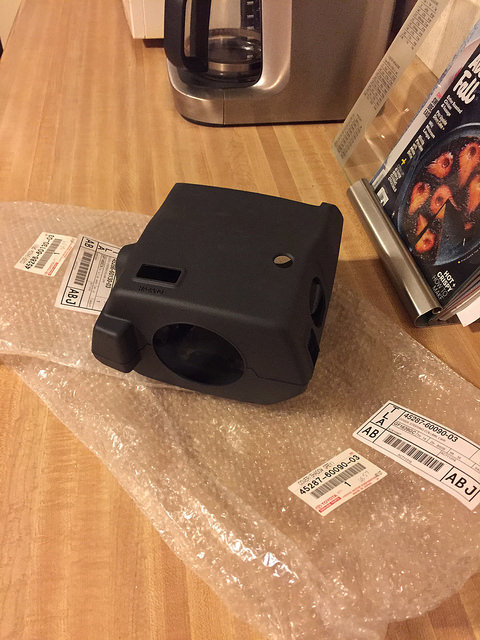

So last weekend I found something on ebay that I have been wanting for BeBe for a bit. Guy had it priced at something like $75 and new are still available (though his said new) at about $48/ea. So I took a chance and made an offer of $55 (had free shipping) and little more than an hour later he accepted. The price and quick acceptance of the item made me question whether it was a) true OEM, or b) in "new" condition. Well it got here today.....
In an OEM box... ok that doesnt necessarily mean anything right....
Well I ended up being VERY surprised...
And #$%@ are these things the sexy new hotness!!!
Man, I almost don't want to install them they are so pretty! You can definitely tell the color fades over time as these things are so dark they almost look black. Color shows as SHADOW GREY on the labels.
