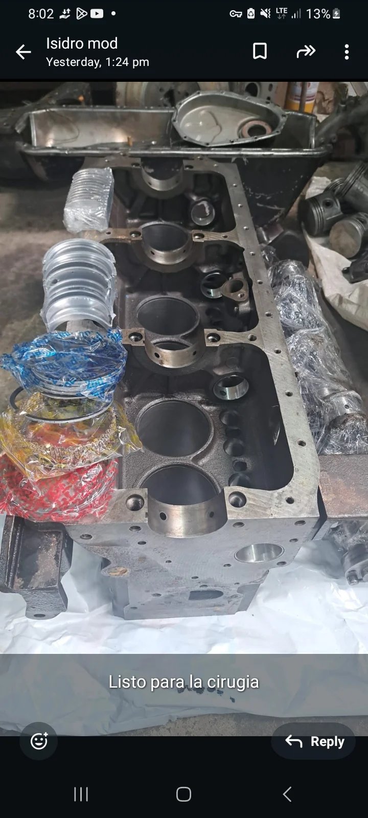

Final 2F build
May 20, 2023
34
248
Bogota
...ready for open heart stuff...
Well i got the sound i want but that damn Aisin carb is still boggy at low RPMs.
What is your ignition timing set at, and what is your elevation above sea level there?
...about 8,600 feet above sea level. Haven't adjusted the timing yet. I'm confused about elevation, it's the air pressure that counts, not the O2 level they say. Might get a snorkel...
I really hate how these 2Fs sound so decided on some mods when did the rebuild.
At that elevation, you will need more advance than the stock timing marks at 7 degrees BTDC. From my previous experience living in Colorado, I would guess you will want 10-12 degrees BTDC base timing at least.

...great, thanks a lot amigo...!
