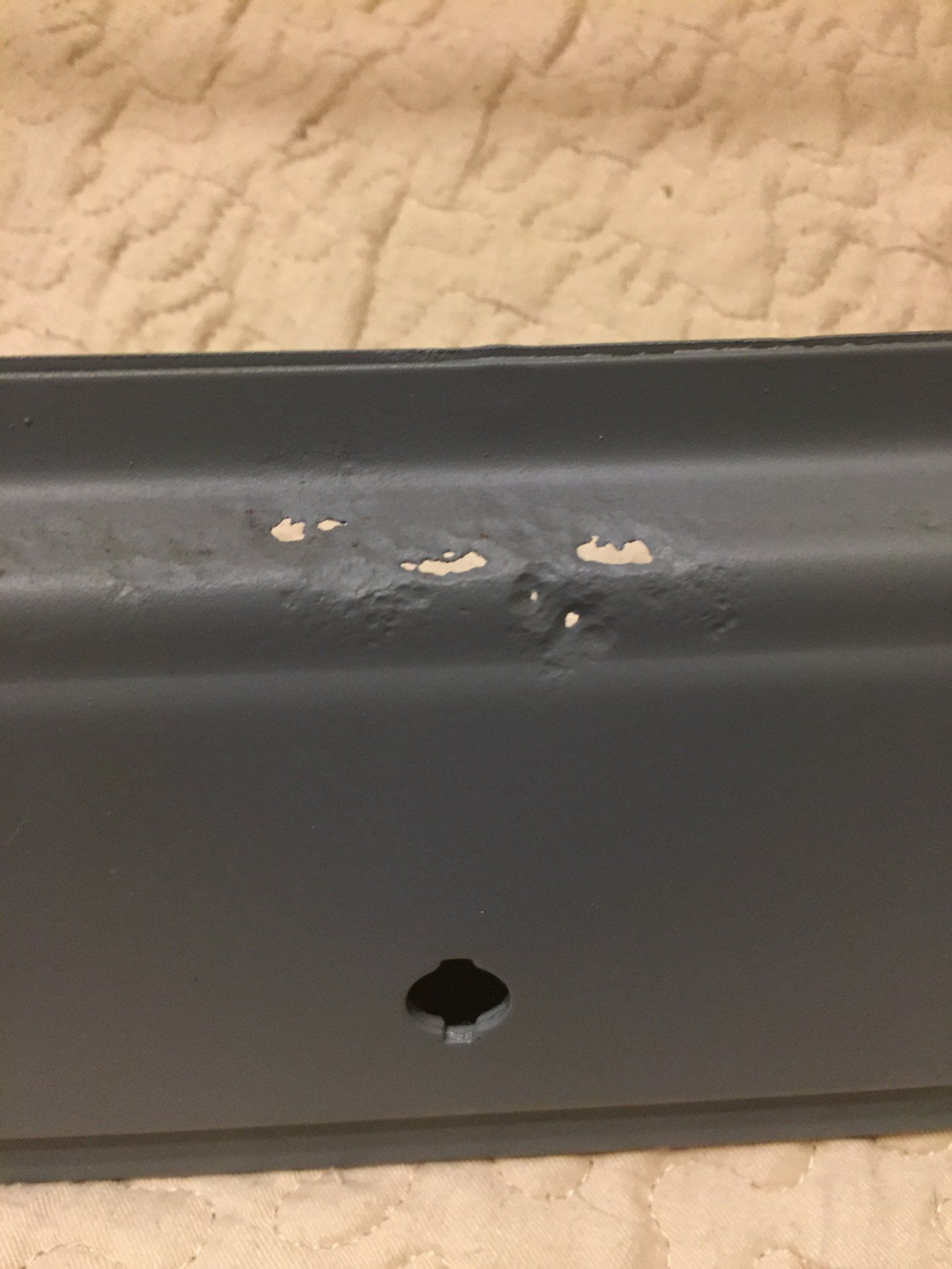

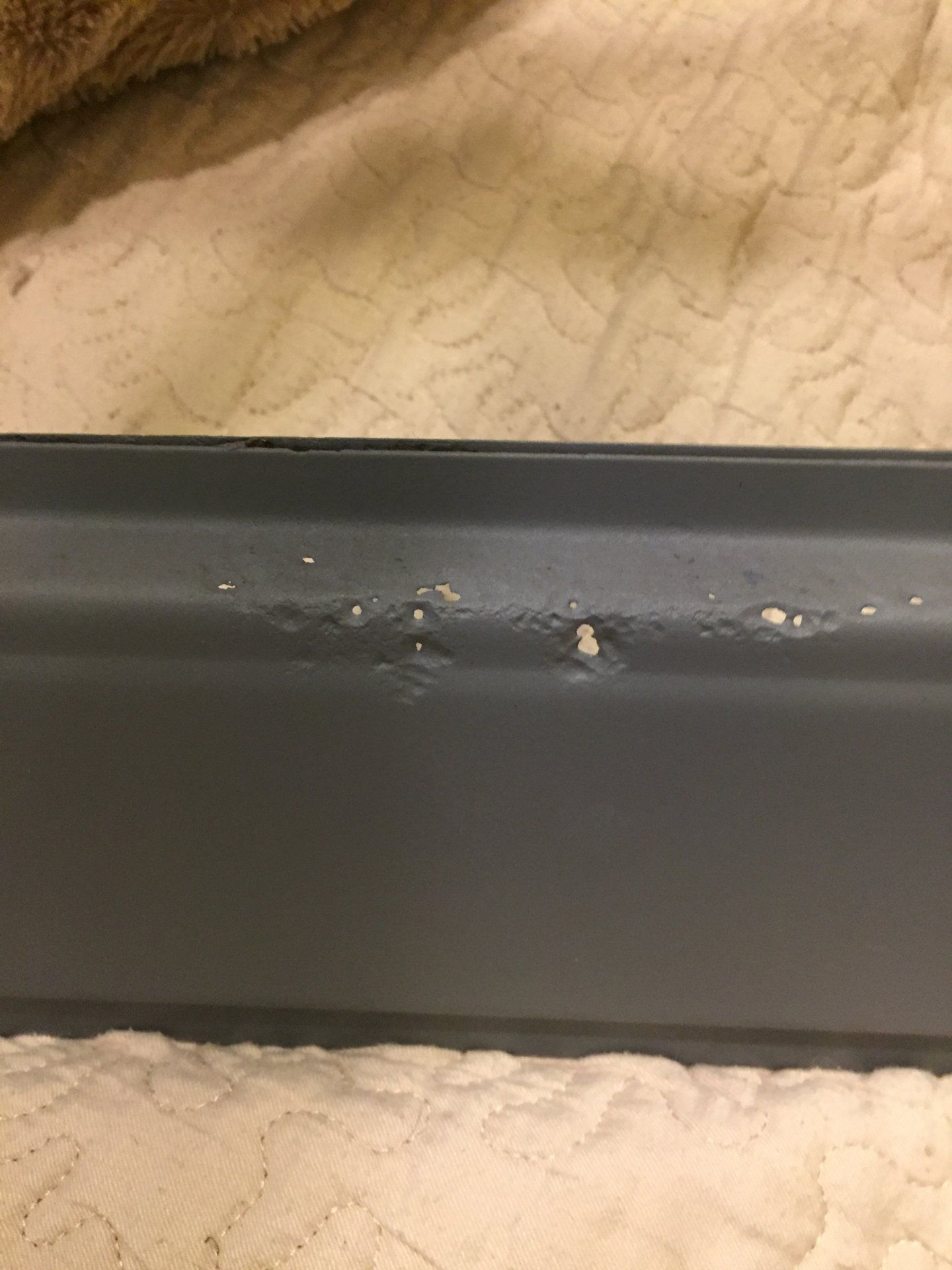

The attached photos are of the windshield frame from my 40. Viewed from the exterior / bottom. The holes were under the weatherstripping. Will the method you describe be a long term solution? Or use JB weld? Purchase another frame?

I Would try it on that. What I always did were round holes drilled in good steel but I bet it works ok and can fill the pits like the body guys do the dents. I'd be watching youtube quite a bit before tying long areas on the surface though. Can Try brazing if you have oxy acetylene and can do it . It fills fairly well. hard to WELD with steel so thin as it melts away. soldering and brazing don't require you to melt the base metal. CLOSE to melting if you aren't careful WILL melt . Kind of like when I patch up my junk exhaust with a mig.
