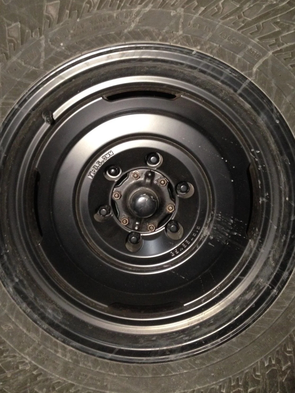

A photo:
The smaller countersunk mounting holes require "tuner" style lug nuts - which have a smaller diameter and also include a low-profile splined socket. A regular nut or socket will no longer fit.
The wheel thickness requires an extended shank lug nut to engage enough threads on the stud. Here's what I used:
Gorilla Automotive 21133ETBC Black 12mm x 1.50
Gorilla Automotive 21631BC Black Chrome Small Diameter Wheel Locks
Hope that helps.
