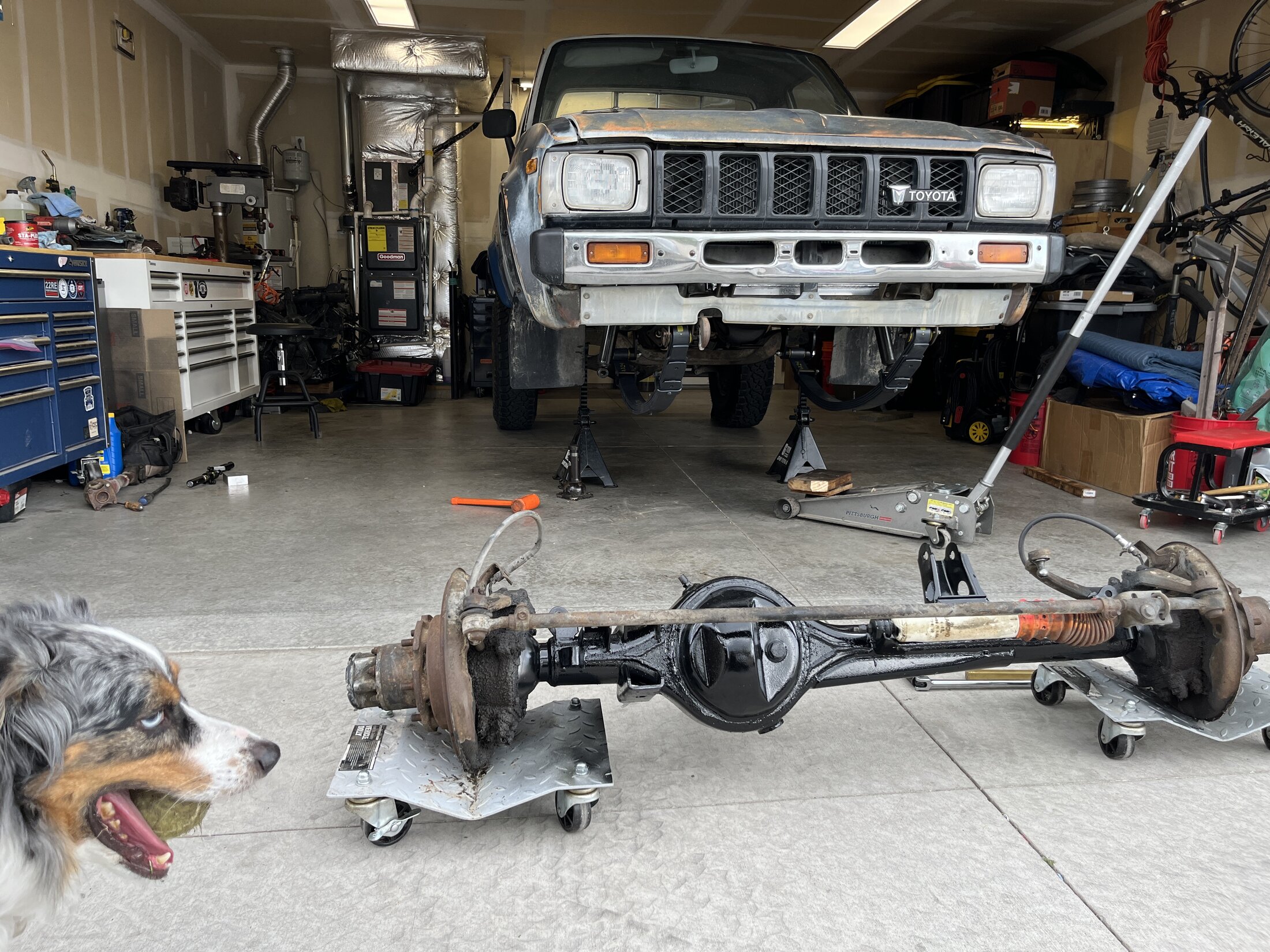

Got a lot of work done on the truck this week. Pulled the front axle out and cleaned and painted the housing. Removed the old, very worn out stock springs and swapped in a set of OME rear springs as a "rears up front" setup. Used a set of "boomerang" shackles from Sky's Offroad to help everything line up correctly. I tried three different combinations of leaf packs before I found something I was happy with, ended up removing the third full length leaf and adding a short overload leaf I took from the rear springs. The overload is there to keep the springs from deforming too much under compression, not for weight. Ride height was better without it but I don't think the springs would have lasted very long.
The rear springs are sitting a lot lower than the front now and they are too soft to carry any extra weight, so I'll end up playing around with adding leaves back there in the next week or two. I initially removed a long and short overload, but I think a full length add-a-leaf would be the best option now. I kept the stock shackle hanger location and made a set of test shackles with a bunch holes at different lengths to test things out. I eventually settled on an 8" eye-to-eye shackle and made a set of temporary shackles at work. I'll make a stronger set sometime this winter.
The leaf packs I started with were:
Fronts: ARBCS010R
Rears: ARBCS019R

Supervisor checking in on my work.
