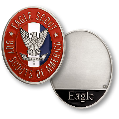

I searched on gunbroker for about a year, and found a Mannlicher full stainless 10/22 from late 1980's.
attachment.php
This has the polished aluminum lower. This thing was perfect and looked like it had 50 rounds ever fired. Tore it down and cleaned out the cobwebs basically. I found the Eagle coins online, and purchased through Amazon.
Then, had to make up a router jig to cut an oval shape into the stock. This sounded easy; however, given that the stock is not flat, ended up being quite the challenge. Thanks to a good friend Kyle, and my other good friend Mark (actually Maker's Mark), we were able to get it cut in so that the coin fit perfectly.
End of the day, I wanted a 10/22 that he will take out of the case and take for a day of shooting.
attachment.php
