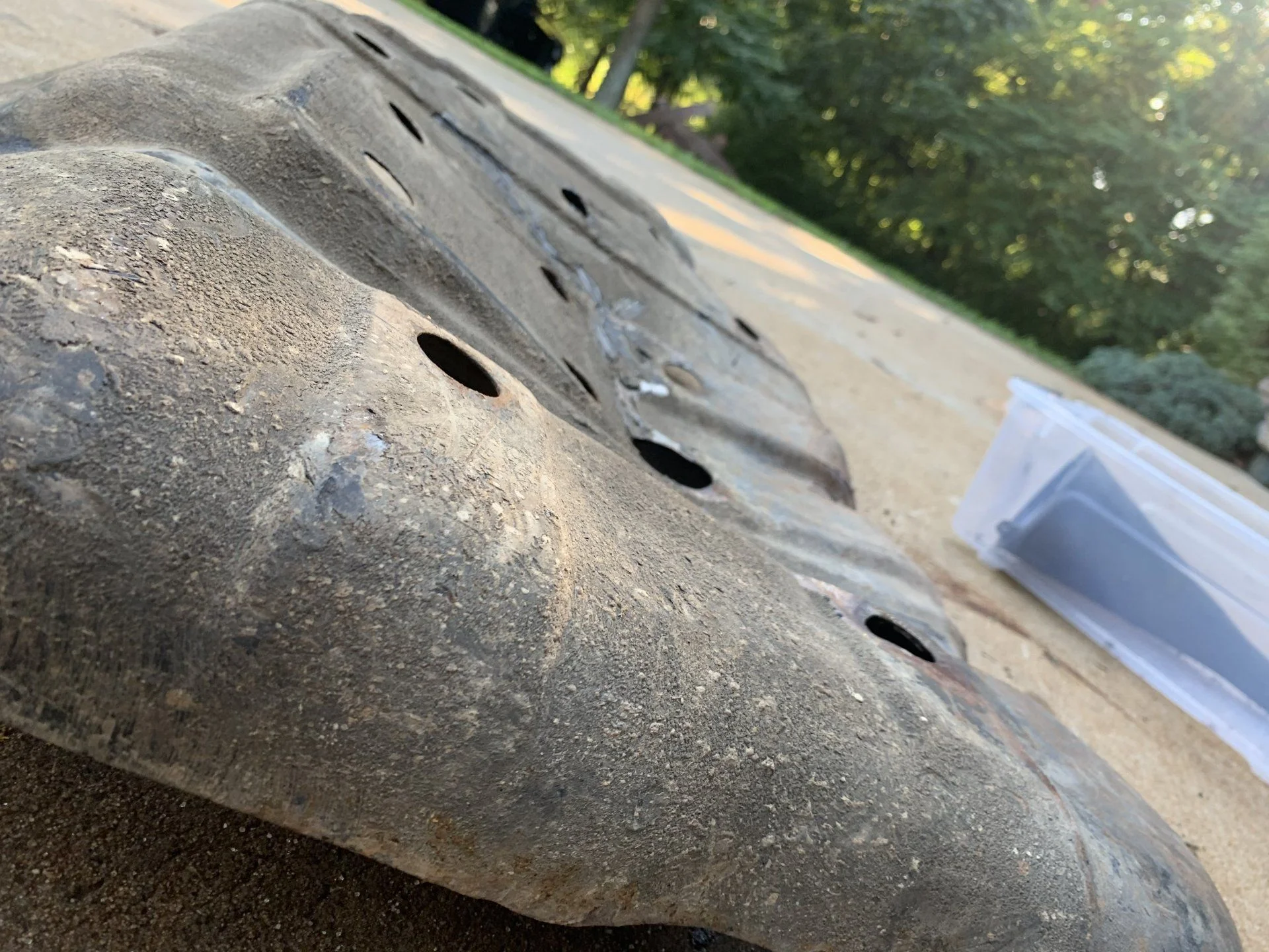

Only problem was on Taylor Pass found a big rock that reduce the volume of the fuel tank by quite a bit..... The factory armor did it’s job and were able to drive 10 hours home. Caveat is without a fuel gauge as it was in operable with the newly redesigned fuel tank

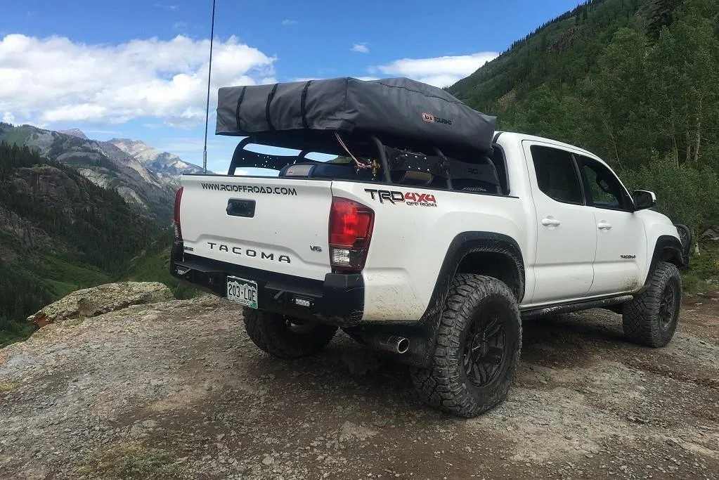

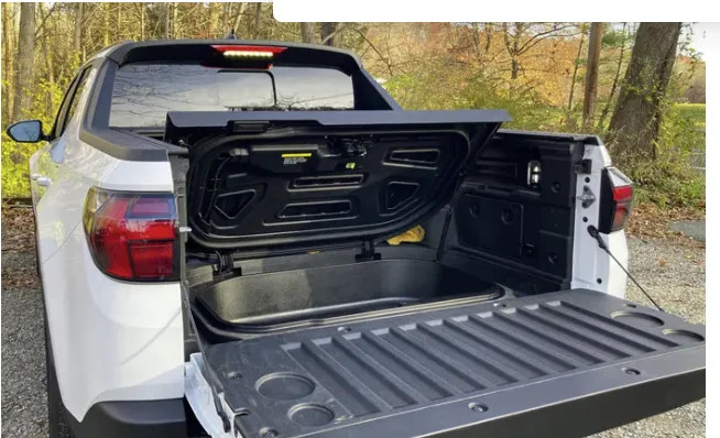

Josh is wanting to add a rooftop tent to the back but not have the elevated surface up to high…. So that means to be able to put a cover on the bed we need some sort of retractable or roll top. Any suggestions? something like this high from Bed surface.
Heather doesn't want to climb up on one of these either, but you get access from the bottom and side access vs a camper topper. But . . . $$$$.
You could find any good used tent and put it on one of these or something less expensive:

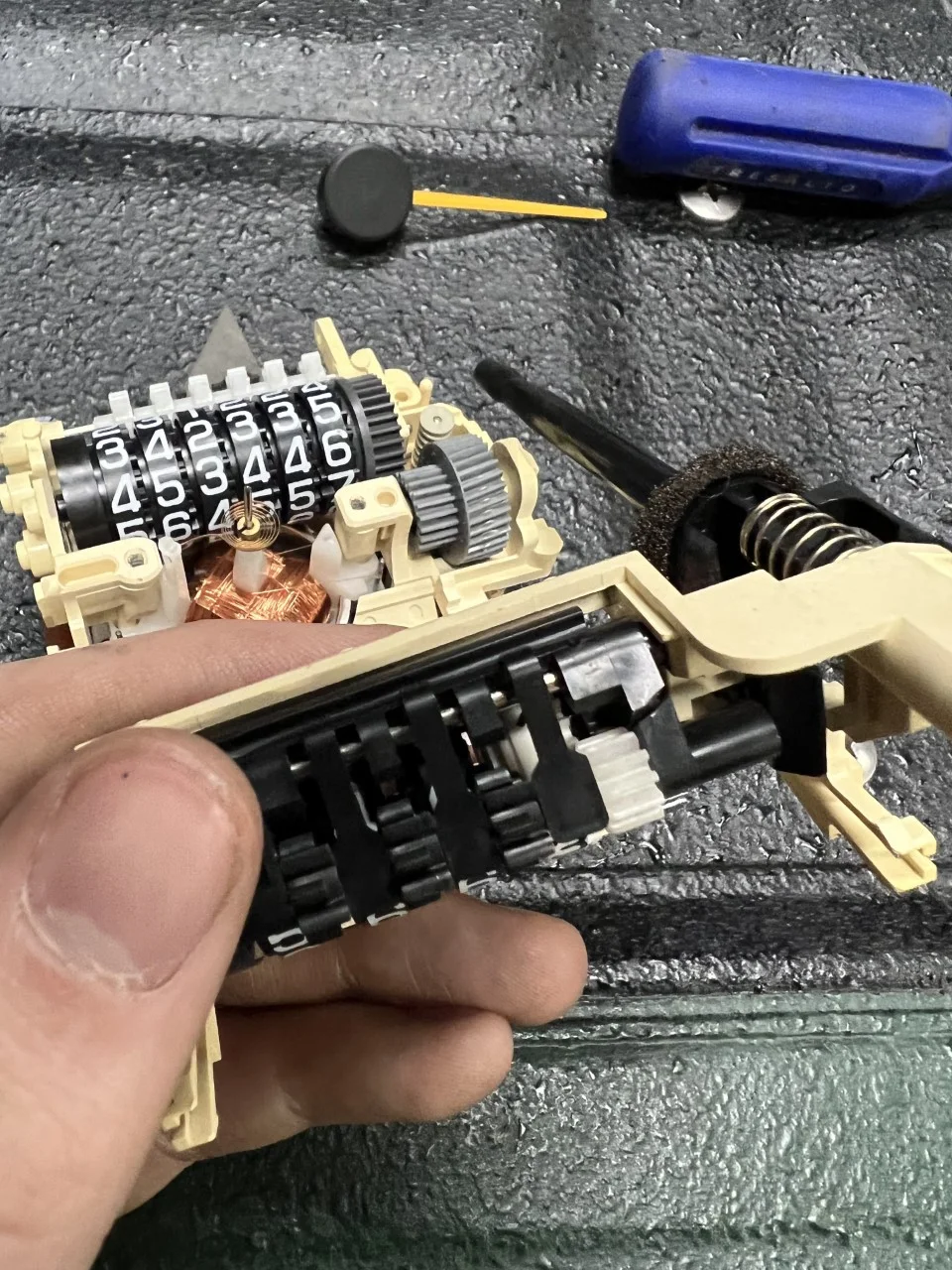

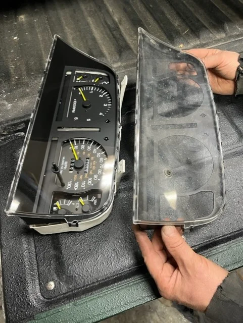

I also went about fixing my cluster. I haven't been able to visibly see oil pressure for a little over a year and a half, along with the resettable odo not working at all. Tacometer would randomly decide it didn't like working and the gas gauge stops at halfway so it was time. @2fpower had some spare casings (to the surprise of no one) and to this day it looks like nothing is there...it's unreal. Swapping it out was easy enough, took a few tries because I severed a ground connection in the membrane but it is amazingly nice, and we can confirm Yoda has visible oil pressure once more.
Also on this swap, we ended up taking out the odo portion you can reset and swapping it with my old overall mileage gauge, so that number is still nice and proper. It's nice to not have to go on gut feeling for when to refill because neither your gas gauge or odo shows you. Apparently this is a pretty common break, the plastic gets stress due to the torque of how the reset pin works, causing it to fracture and the gears don't link back properly.

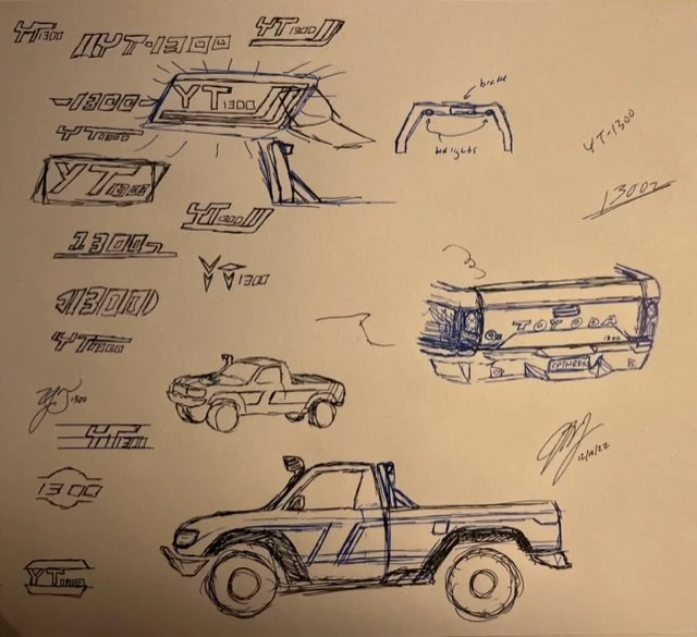

For future work, we're eyeballing re-doing the entire rear section. It's having some rust trouble, so sandblasting and repainting seems like the best option before it gets worse. However, while we're there it doesn't hurt to make some modifications.
Due to the nature of this vehicle, there is a lot of empty space under the bed between it and the frame. Due to this, we already had plans to expand the gas tank capacity by about 150% percent. However, we're eyeballing a bed trunk system, we're working out the ideas but for a prototype we're thinking cutting a hold and adding in a lip. The lip will function as a channel with holes for water leaks, and a tub can slide in from the top, catching the lip. Adding in locks and hinges and then we have a closable trunk. Think along these lines but nowhere near as fancy.
Also, we plan to add some piping to the front of the bed against the cab. This will not only bring out the silhouette a tad, but will also allow the addition of some new lights. Along with brake lights, I'd like to place some flood lights to turn on at night, so when camping the lights can come on and flood the contents of the bed, making it much easier to unpack. Also, with our expertise in spraying paint (and dad's new paint gun), we should be able to finally spray in the "TOYODA" text on the tailgate.
Here are some sketches of what these additions may look like, along with some designs of a custom "YT-1300" badge would look like to install on the tailgate. The final one (circled) uses some classic Toyota influence. Don't know if I'll continue with it but it was a great exercise.
