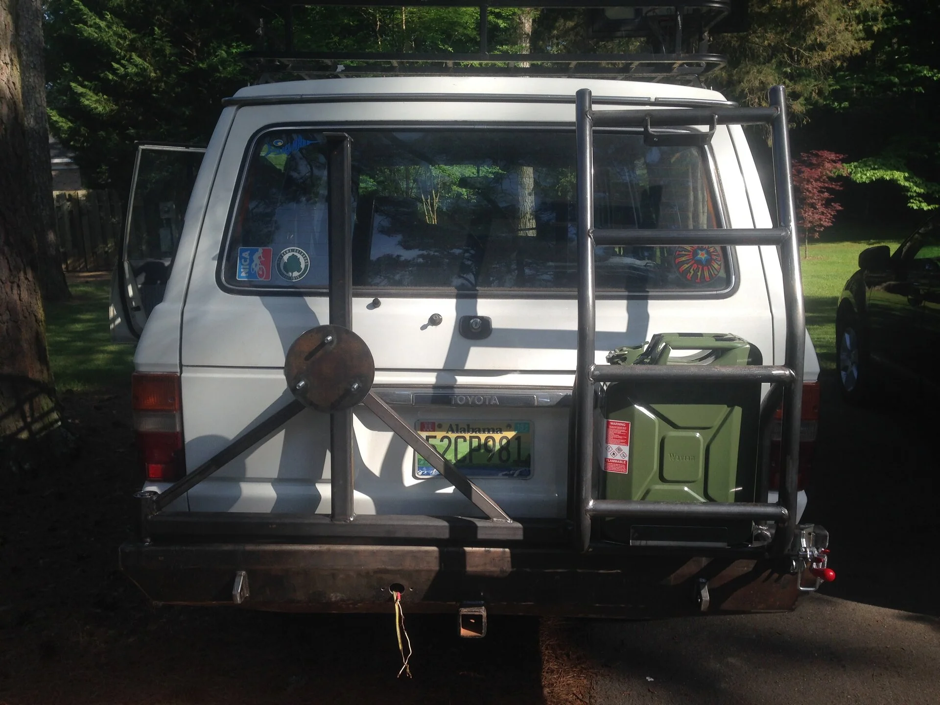

New bumpers fabricated by a local shop in Decatur in 2015.

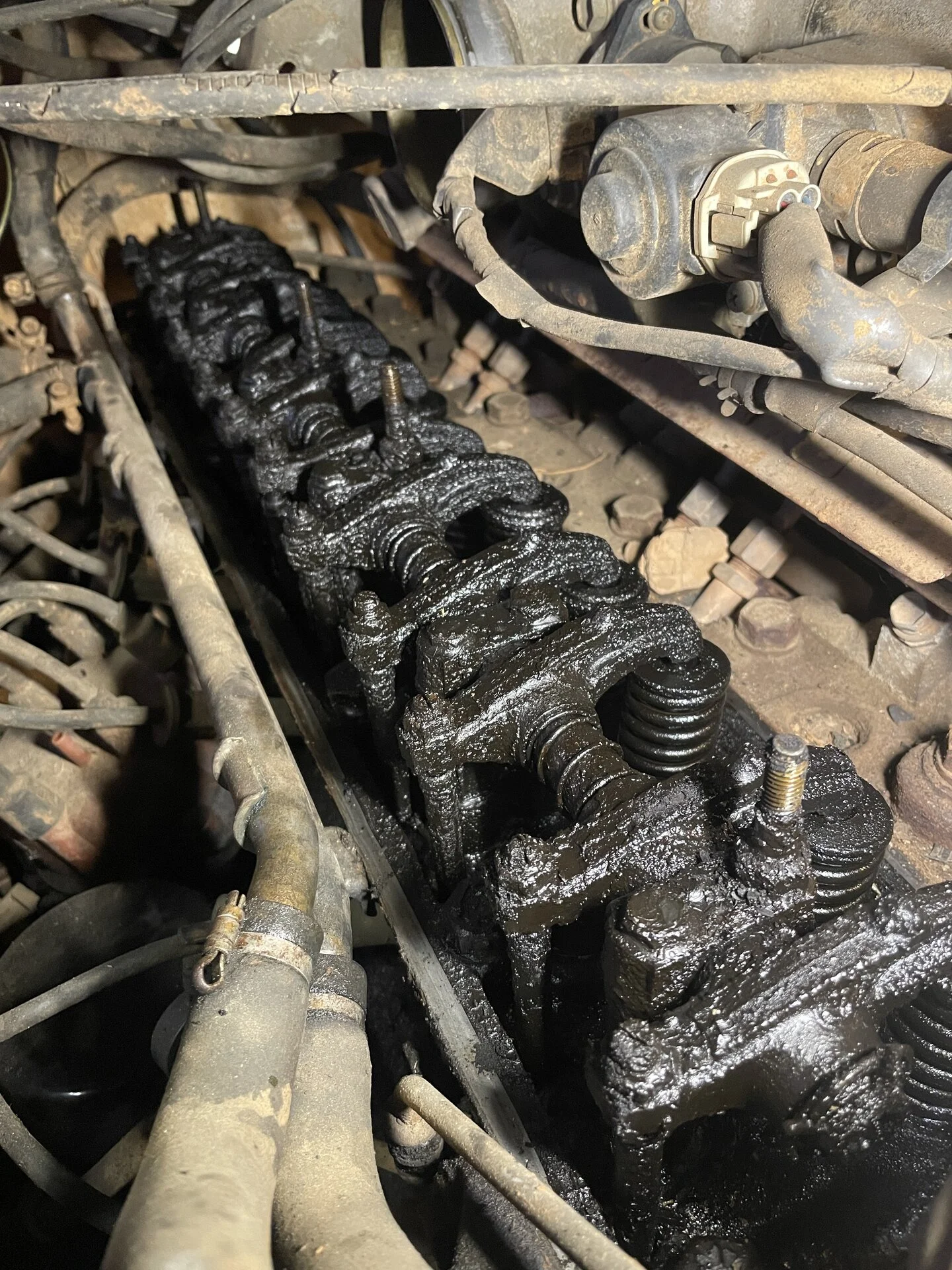

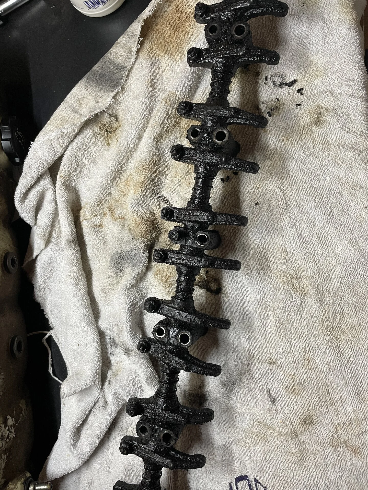

That brings us to the current day. Over the weekend, I started on a trial run of getting the valve cover off to adjust the valves and found some serious gunk on the valvetrain. My gut feeling was that I was headed for a rebuild, but after some research today I'm leaning toward removing the valvetrain and giving things a good cleaning.
This post seems to have some good advice Oil Sludge Carbon 3FE - https://forum.ih8mud.com/threads/oil-sludge-carbon-3fe.38061/post-413266
The truck has Rotella 15-W40 in it now, so I'm hoping frequent oil changes will help clean things up. Does anyone have any advice on this?
This will be a learning experience for me, so any advice is appreciated and nothing is too basic to be helpful.

Clean the valve train and keep driving the 3FE. You can easily pull the valve train and clean it out of the motor, run the Rotella and regularly change the oil.

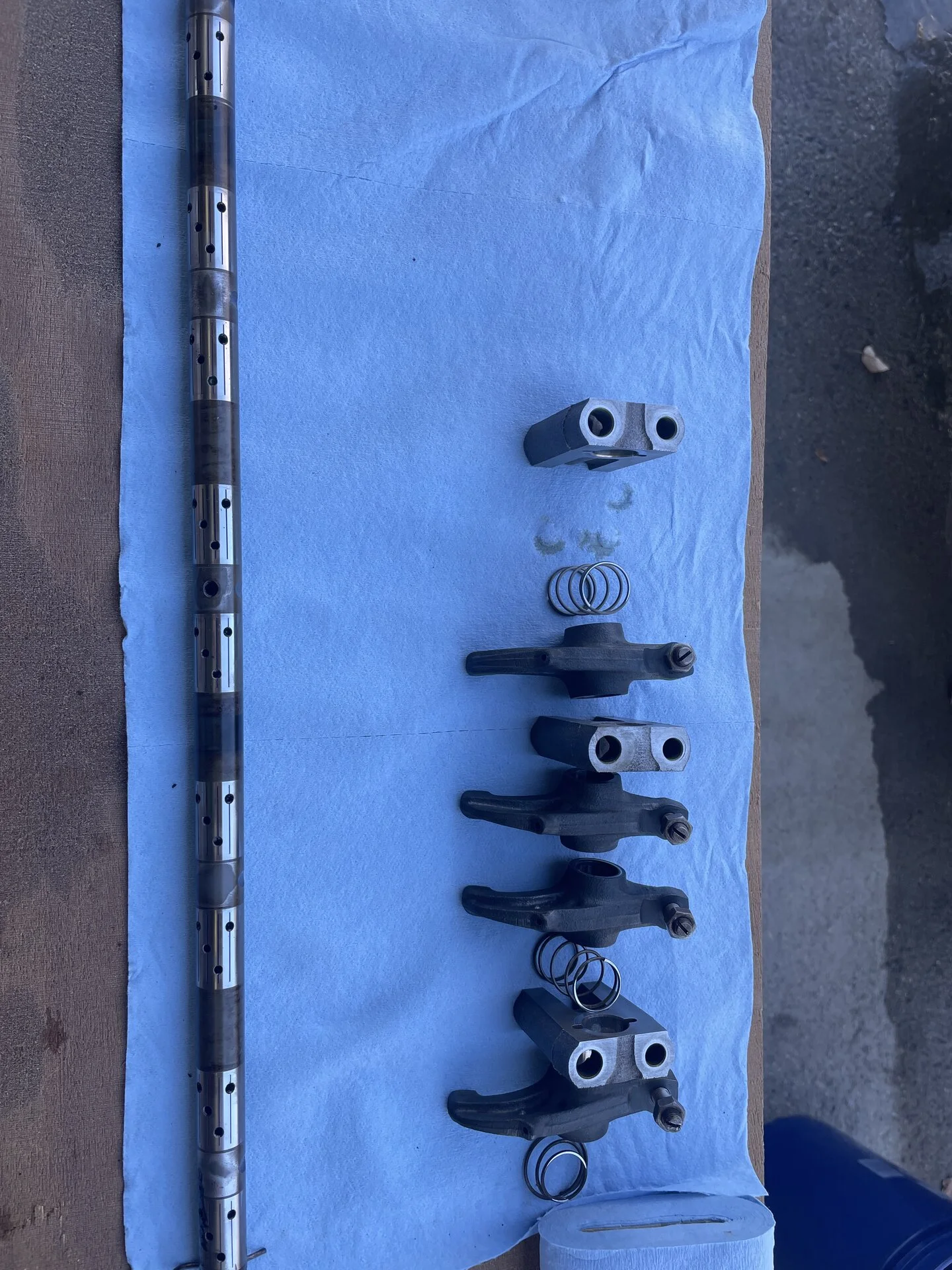

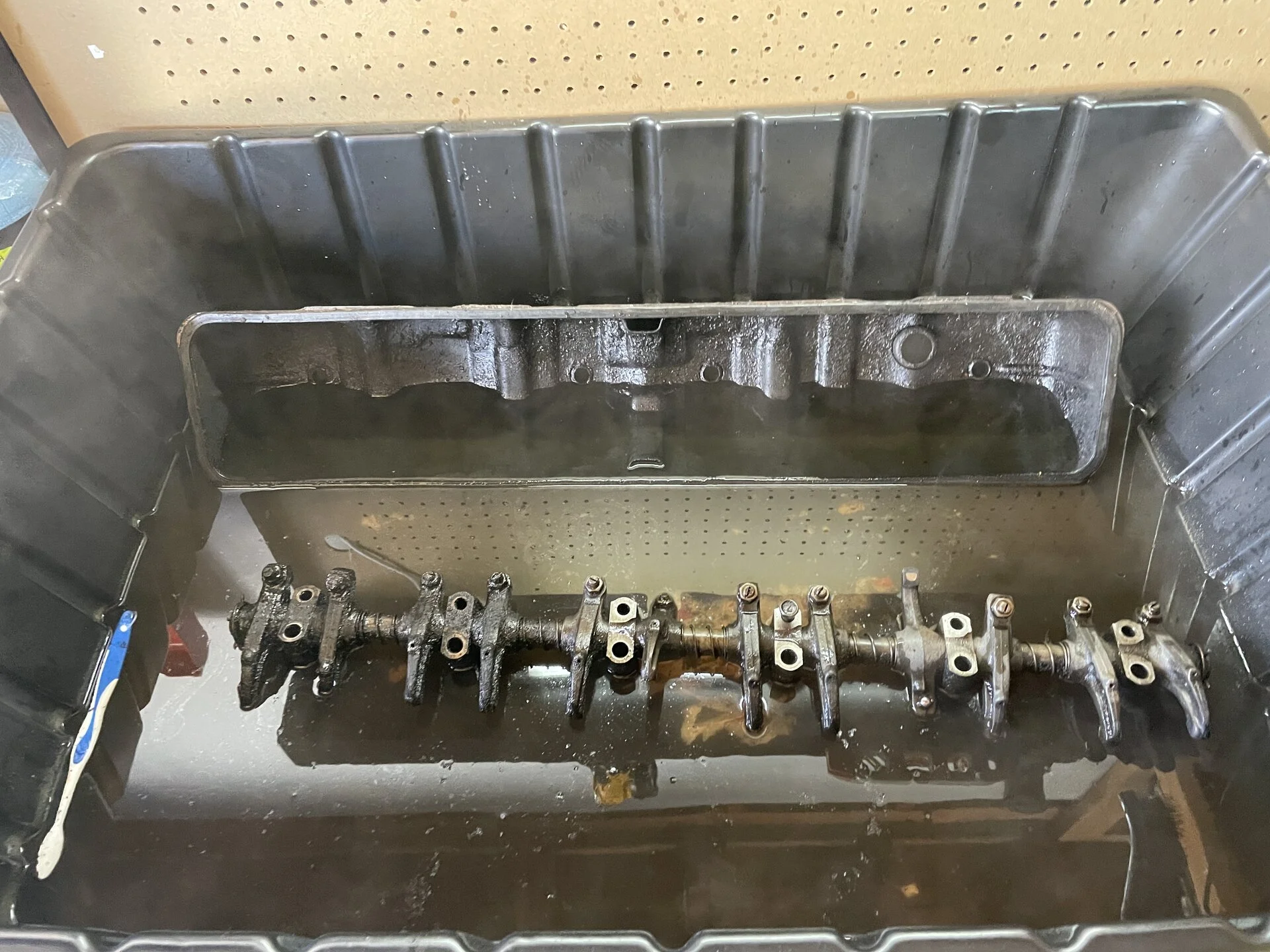

Making good progress on getting things taken apart and cleaned up
Dirty parts are becoming clean parts
Any advice on how I should far I should take this? I’m thinking clean the valve cover, rocker assembly, and push rods, and hope that frequent oil changes will clean up the top of the head and valve springs. I’ve also seen adding a quart of ATF to the oil suggested to help clean things up, so I’m thinking about trying that as well.

Valvetrain got cleaned up and reinstalled, and valves adjusted.

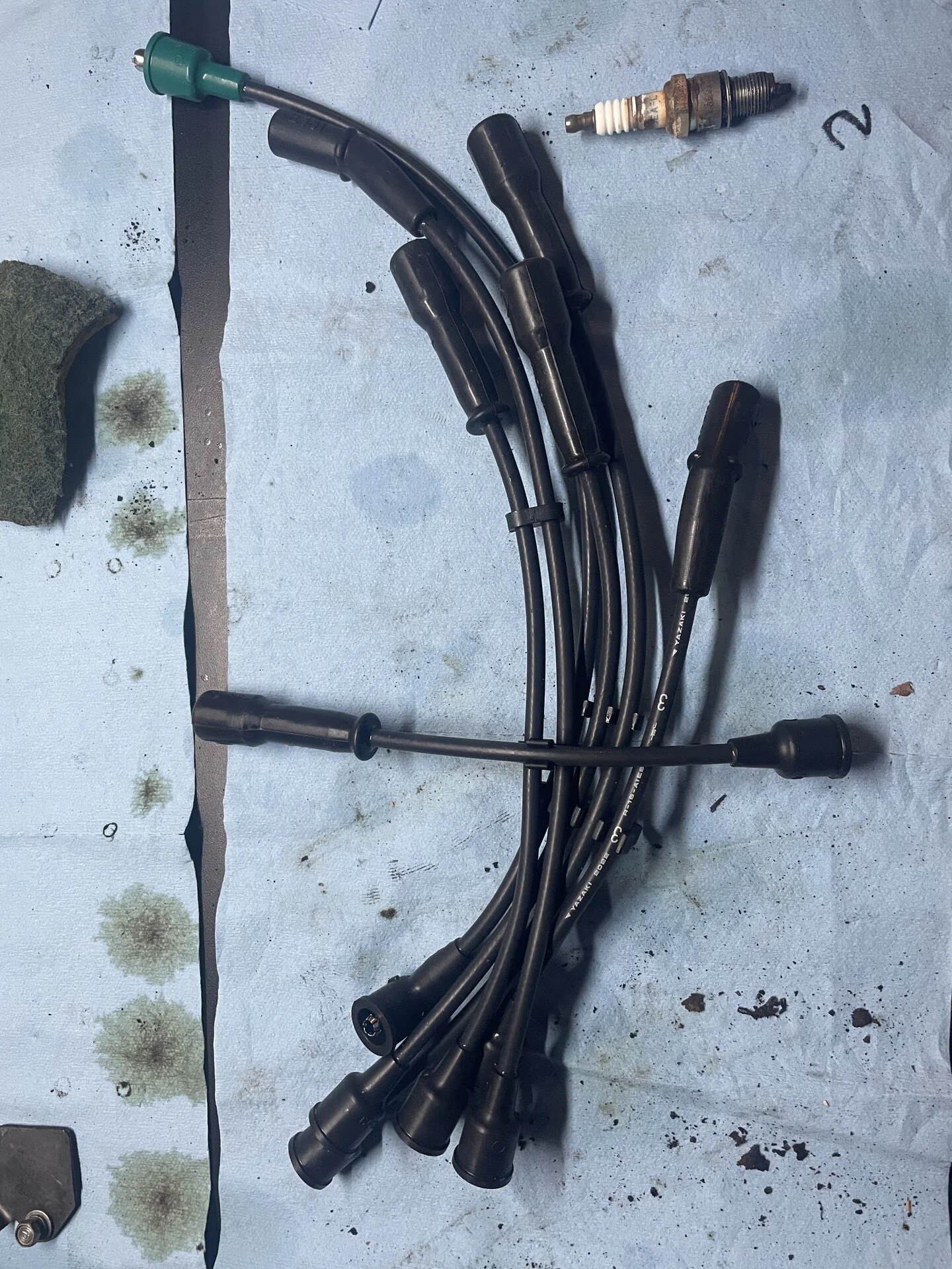

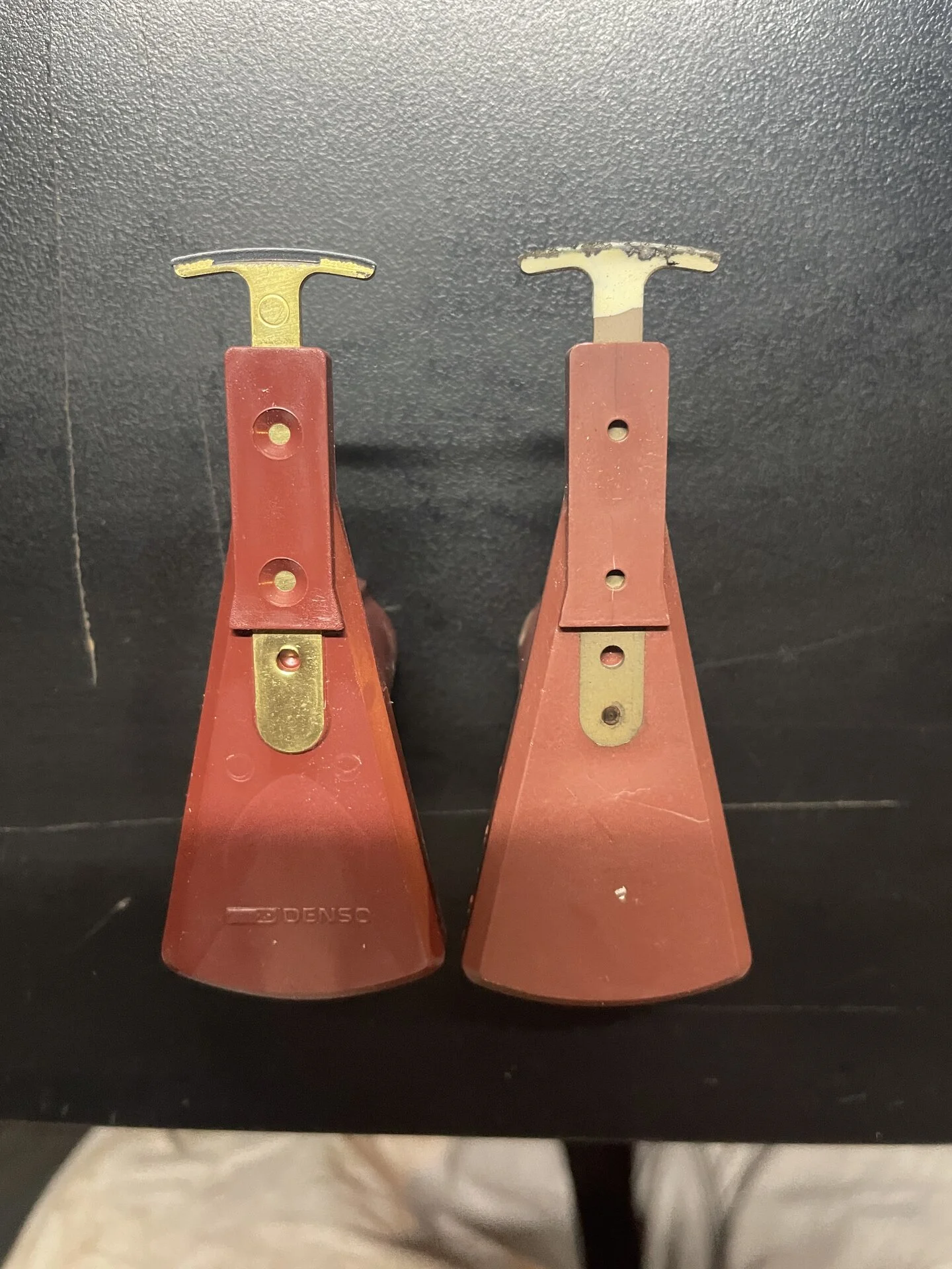

New spark plugs, wires, and distributed cap and rotor.

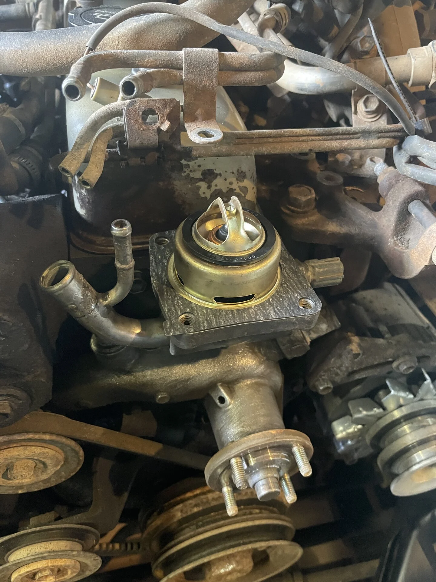

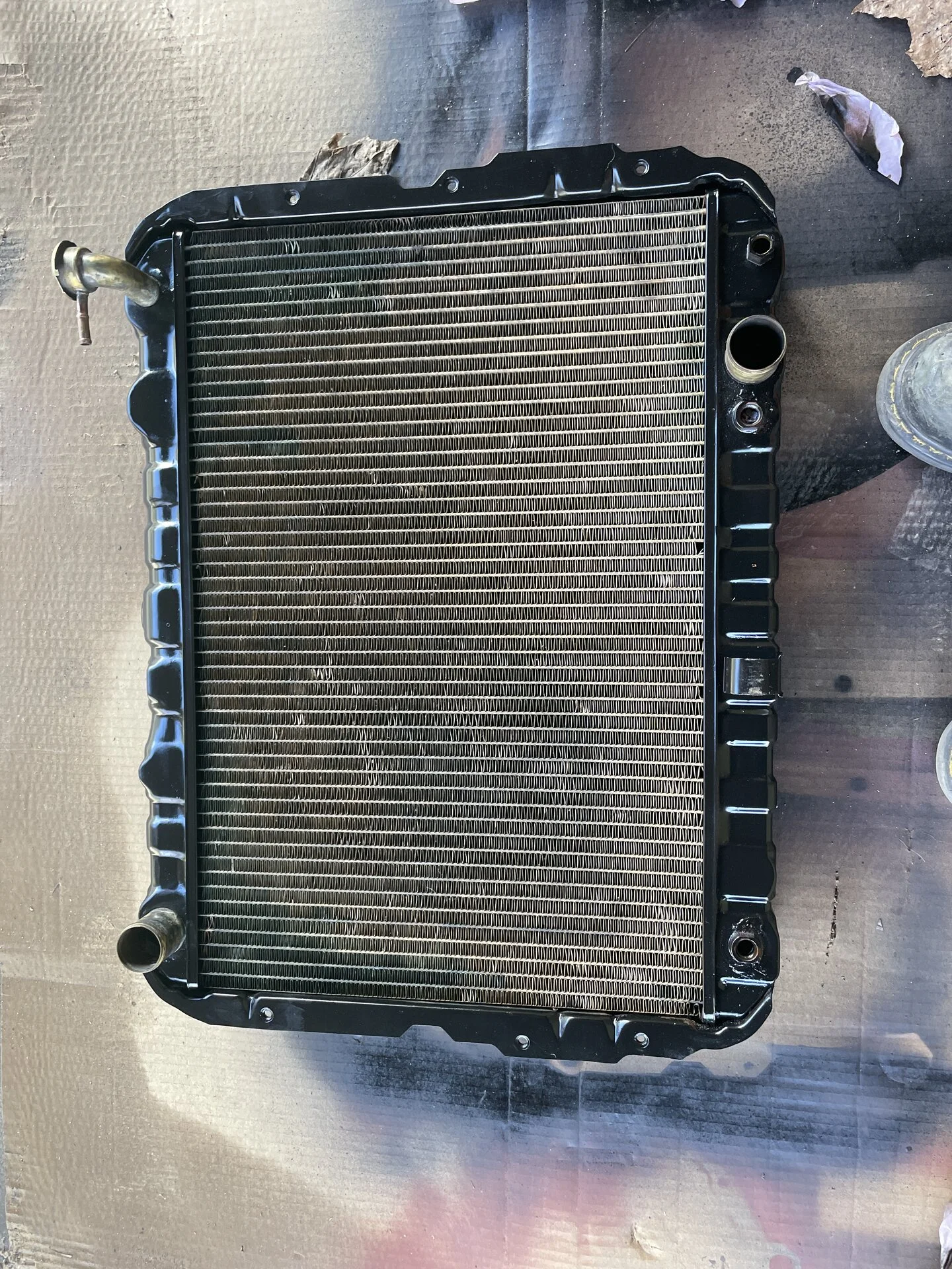

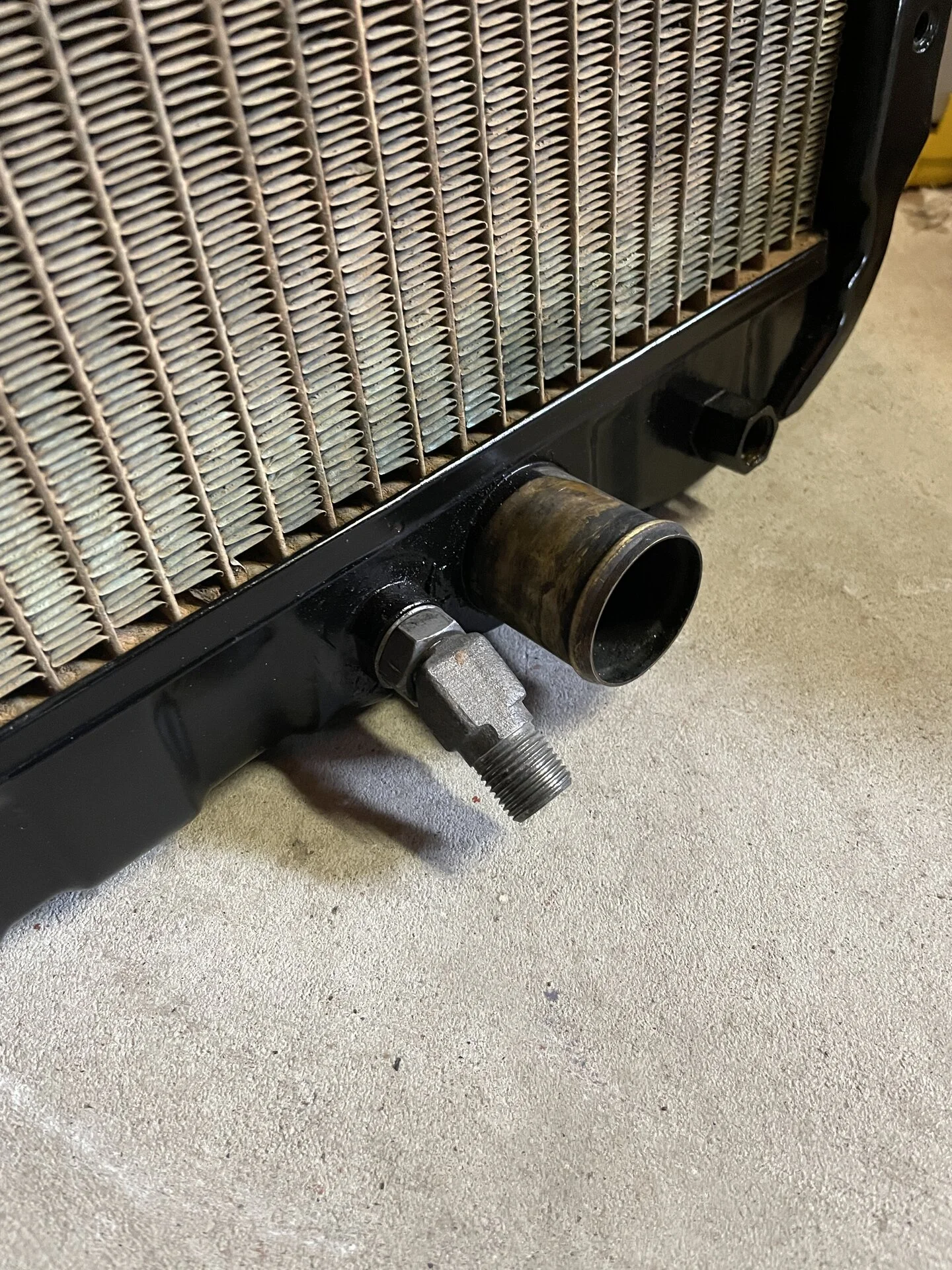

The thermostat gasket was done, and the thermostat itself had a crack in it, so both of those got replaced. Also replaced the temp sensor and got the gauge working again.

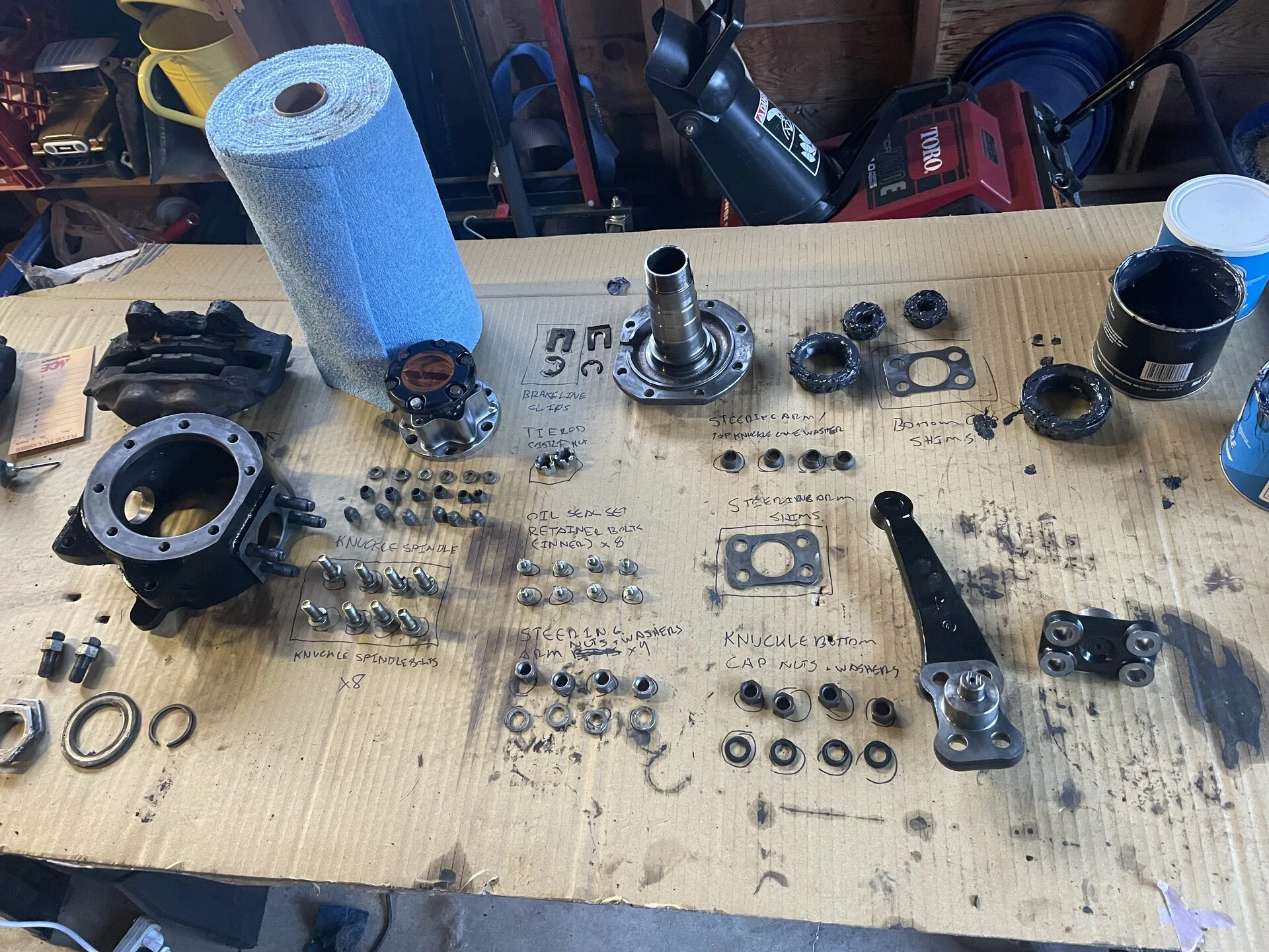

The knuckles had a significant drip going, so they got a rebuild. Some nasty soup came out when I cracked them open.
Lots of parts to clean, paint, and organize.

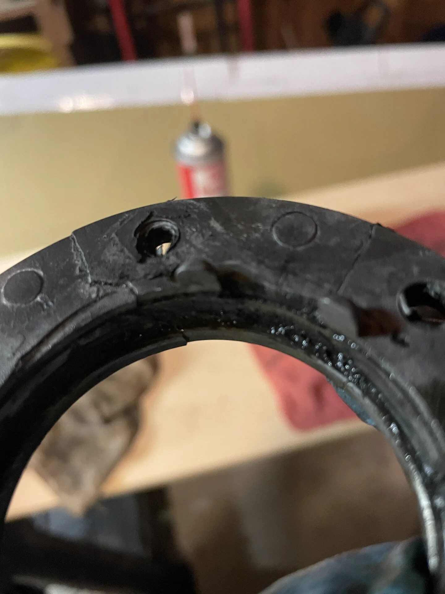

The driver side hub cracked a while back, and a shop patched it back together with JB Weld. This got replaced with a new Aisin unit, and the old one will be a trail spare.

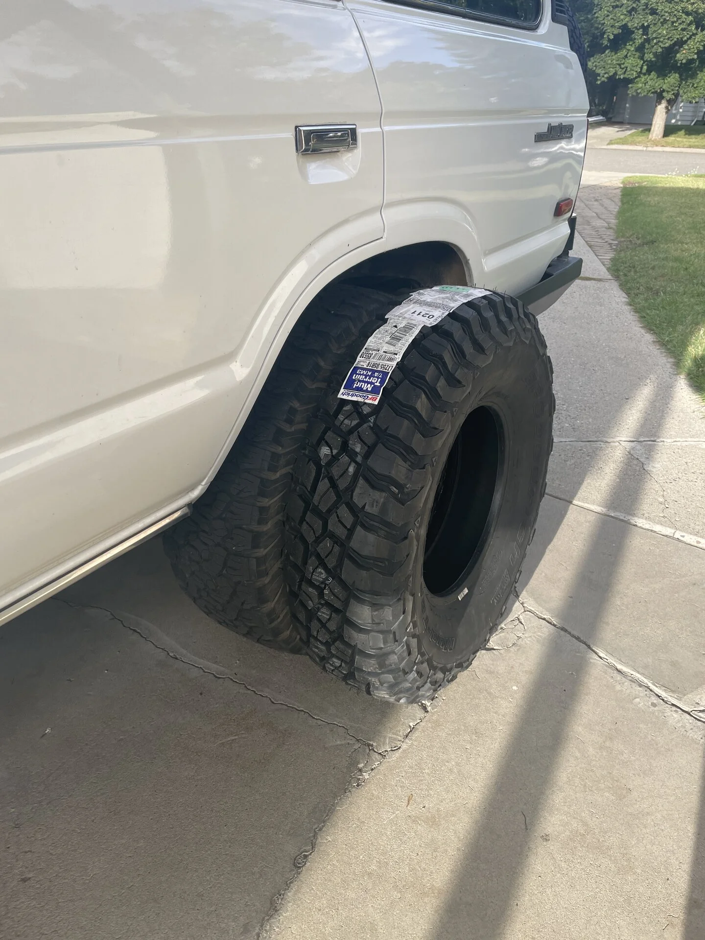

I ordered a set of 70 series wheels earlier in the summer, but they sat in the garage for a while while I waited for tires to arrive.
Tires finally got here this week, and a local shop mounted them.

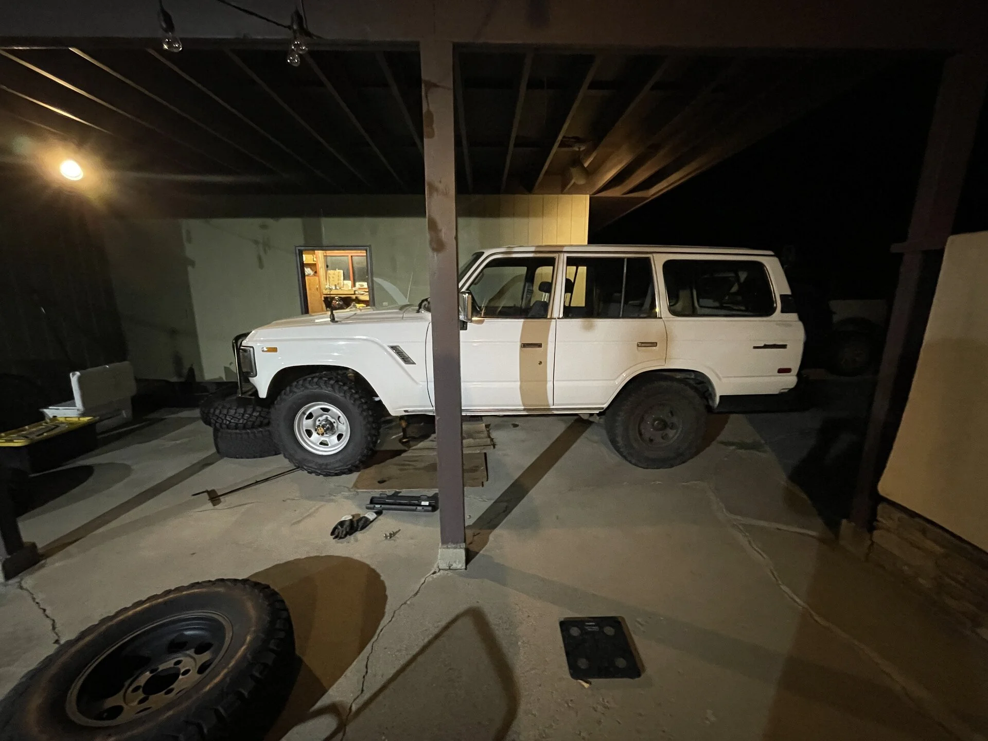

I got them on the truck today, and installed new calipers at the same time, to replace a pair that was sticking.

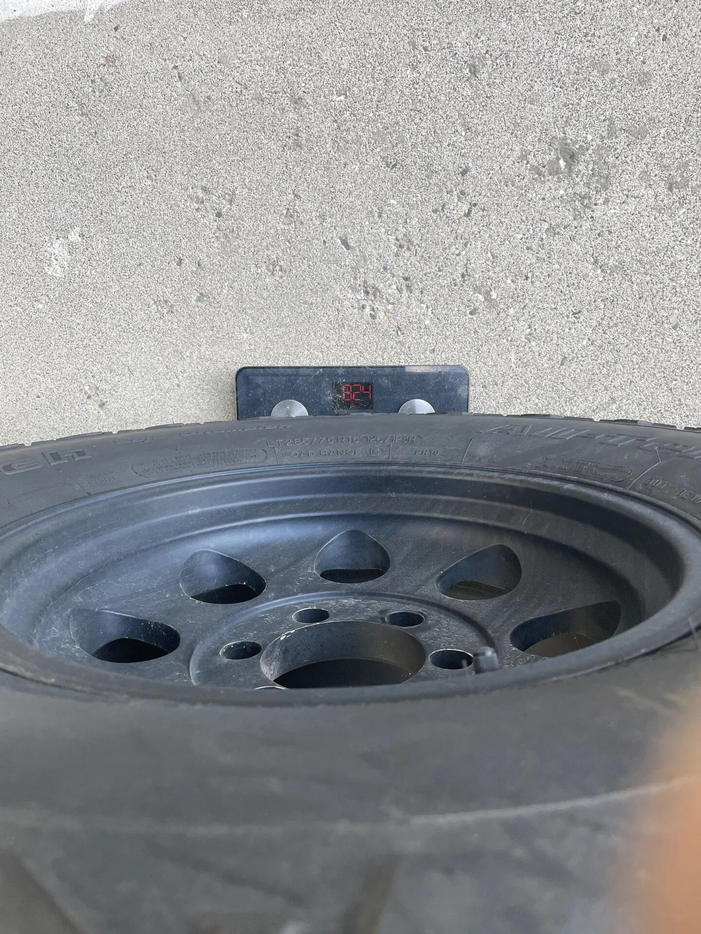

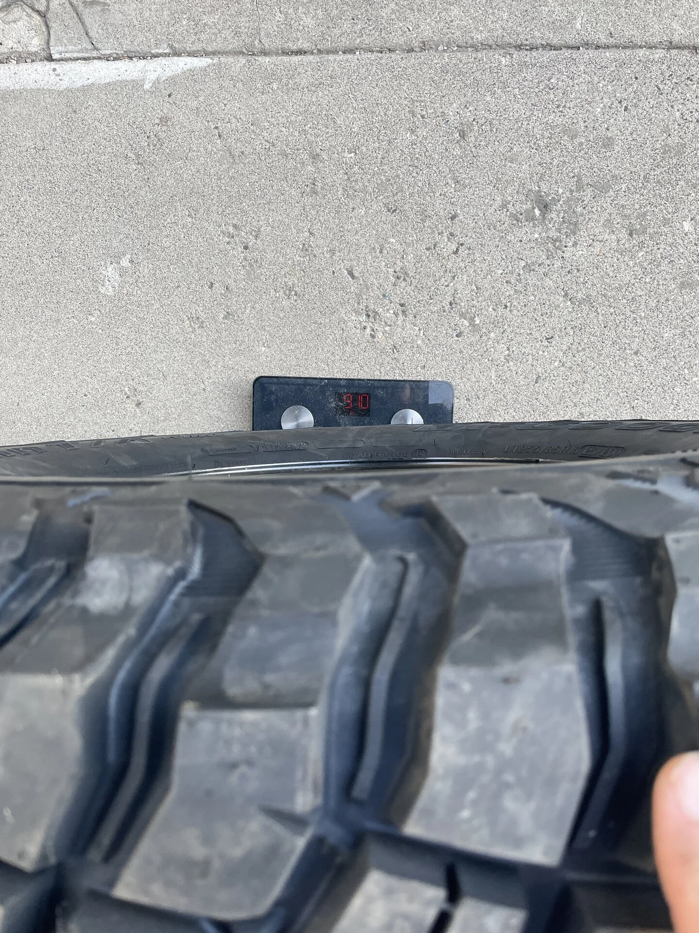

Km3s on steel wheels definitely aren’t light. 91 lbs compared to 82 lbs for the km2s on aluminum wheels I was running before.
