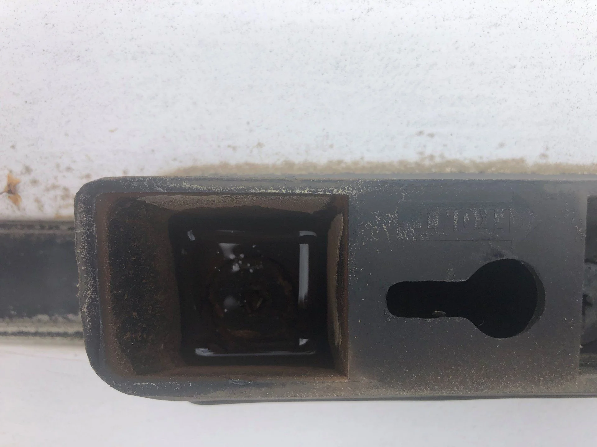

Factory roof rack removal
For that center section if you have a rusted bolt, instead of an extractor take a Chisel or drift (as sharp as possible). Hold at a 45 degree angle to the face of the bolt and hit it with a heavy hammer. It will bite into the bolt face and eventually start turning. This is how I take off the big lock nut on the axle hubs also without buying an $80 socket that I will never use for anything else.
I'll give this a shot later today, thanks
If that doesn't work, what I'd probably do next is just get a cheater bar and break the bolt. then remove the rack piece and drill out the broken bolt ultimately cleaning up the hole with a tap. I've got a video on this if you've never done it before... not that difficult of a job to restore those threads to workable again.
Unfortunately the “bolt” is actually a screw that takes a Torx bit so I can’t really get any purchase on it.
So you already soaked this with PB Blaster right? You should be able to get a torx driver that mates to your socket set. Push down super hard when you twist it so it doesn't slip in there and strip it out. But if you strip it, not a big deal as that wallered out hole is perfectly on center for your drill. Once you drill through the head of the bolt you should be able to lift the part off, then deal with the rest of the rusty bolt.
Yeah I let it soak overnight and will try it again this afternoon. I have the Torx driver but the screws are badly stripped. I may have to try as you said

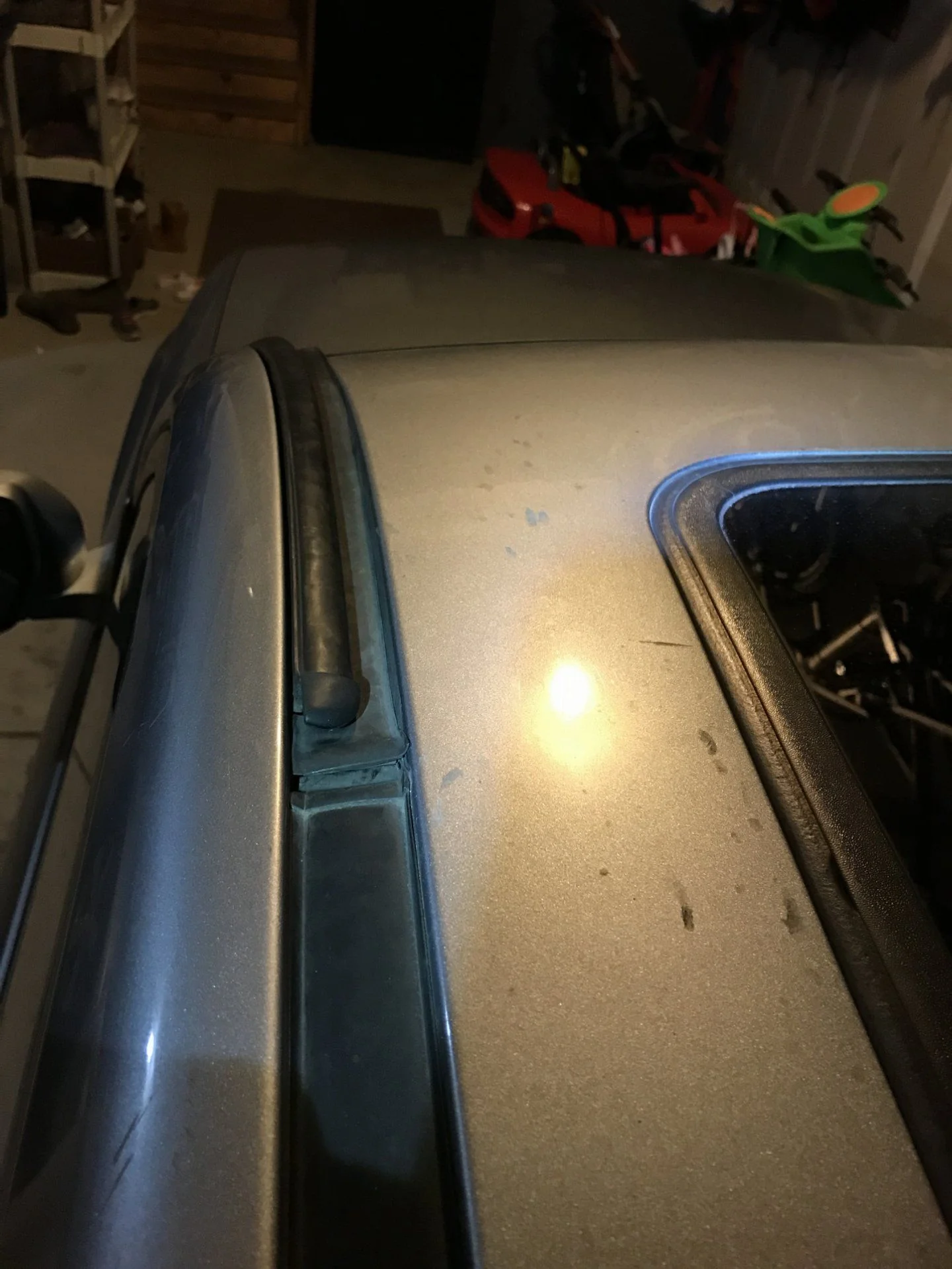

Doing a roof rack delete. Read some threads, got my 75557-60010’s and found these huge gaps up front. WTF? What to do now... Put the rack back on or continue with removal and leave these gaps open until I figure out what is going on here? I *think* either the roof molding or the windshield side moldings have been cut?

It looks like the $150 ones were cut short by a windshield installer? Usually, they don't terminate that abrupt.

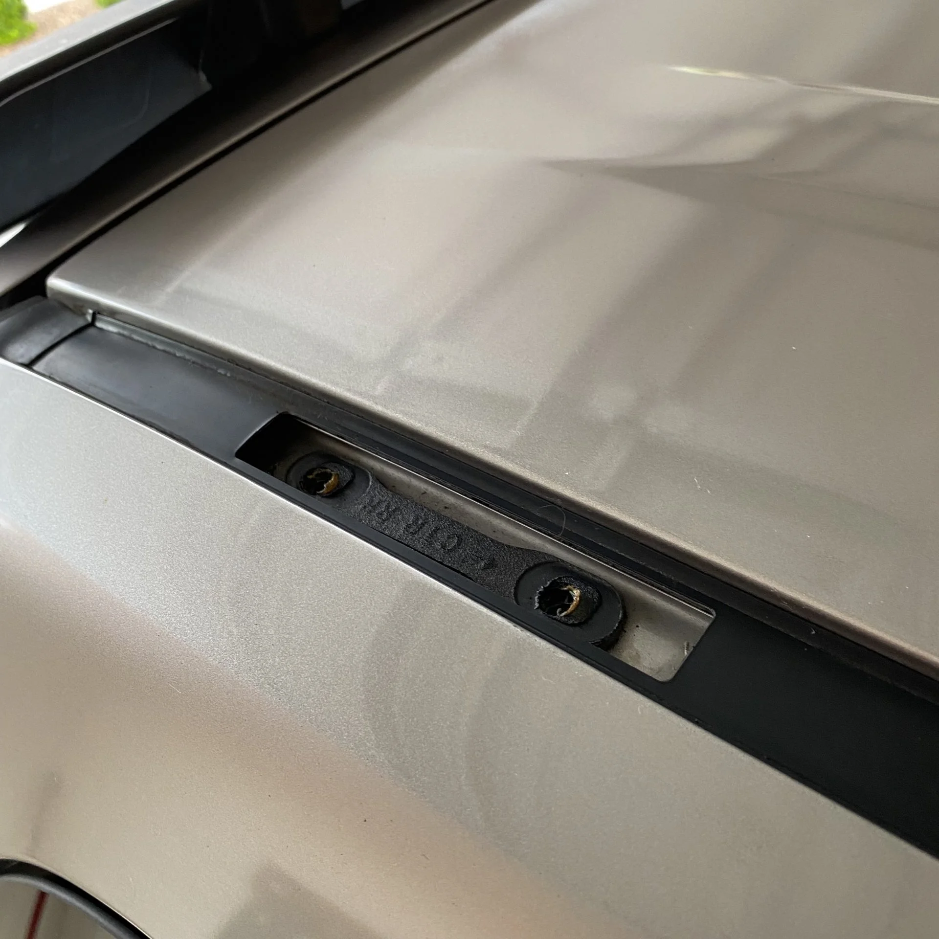

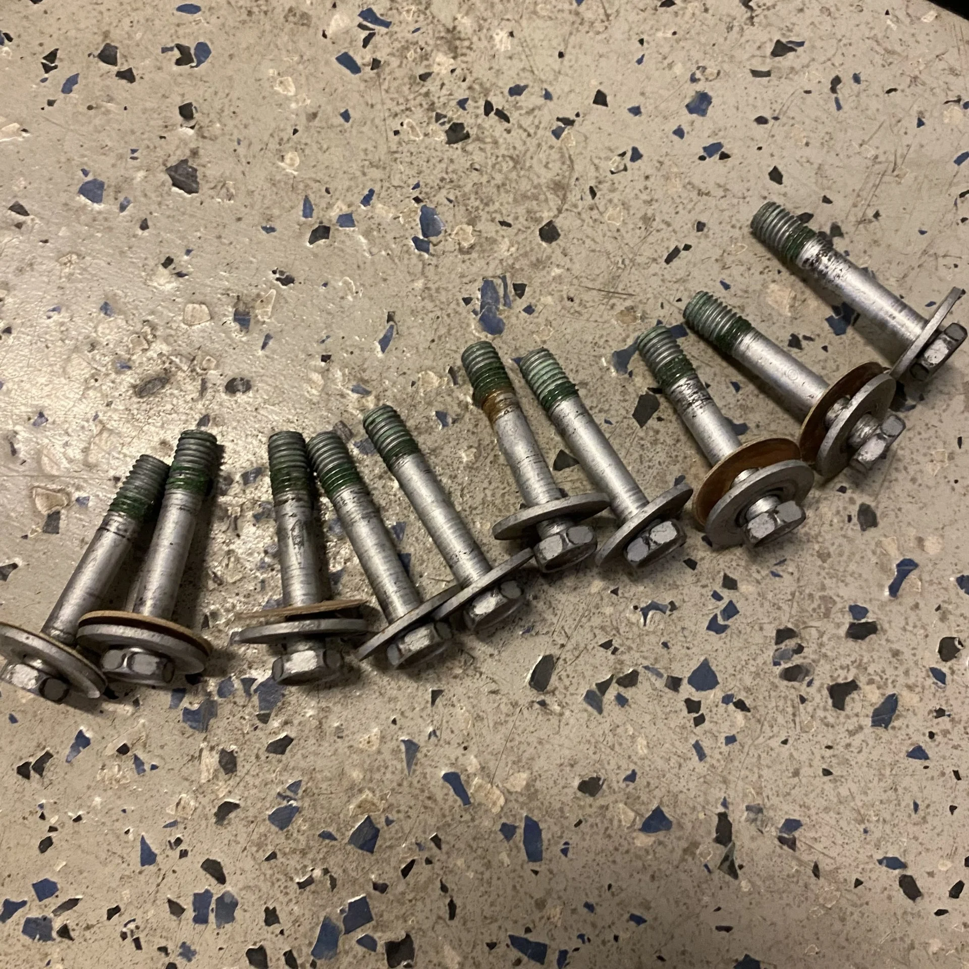

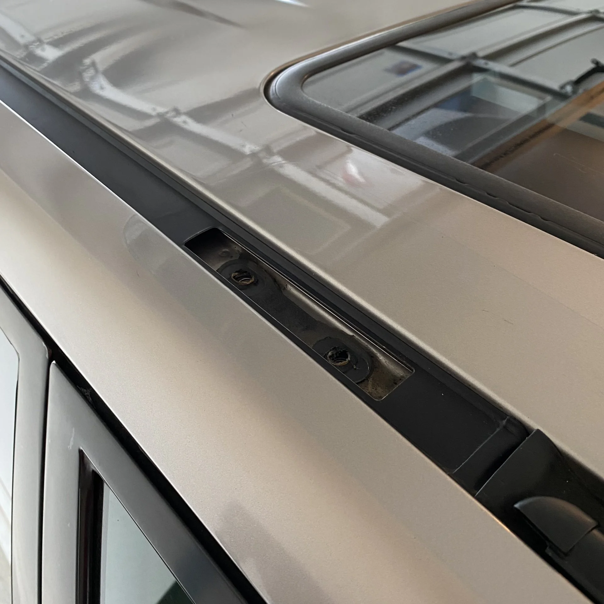

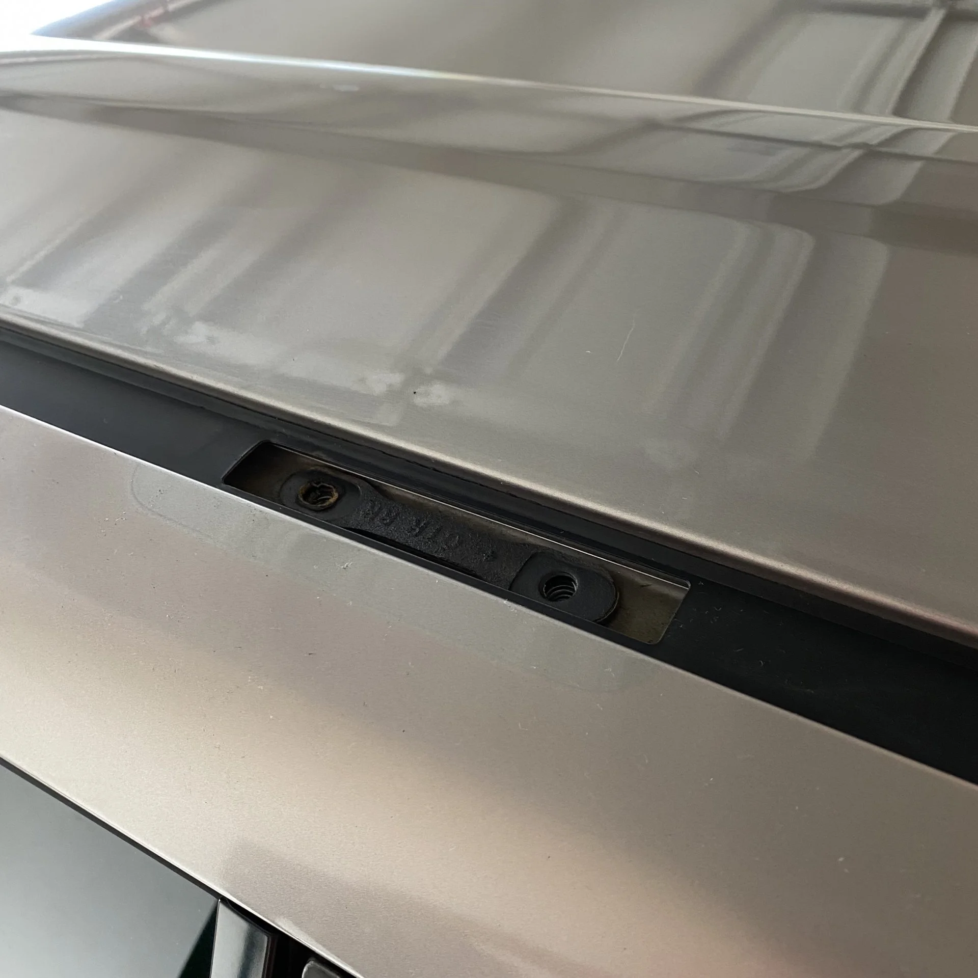

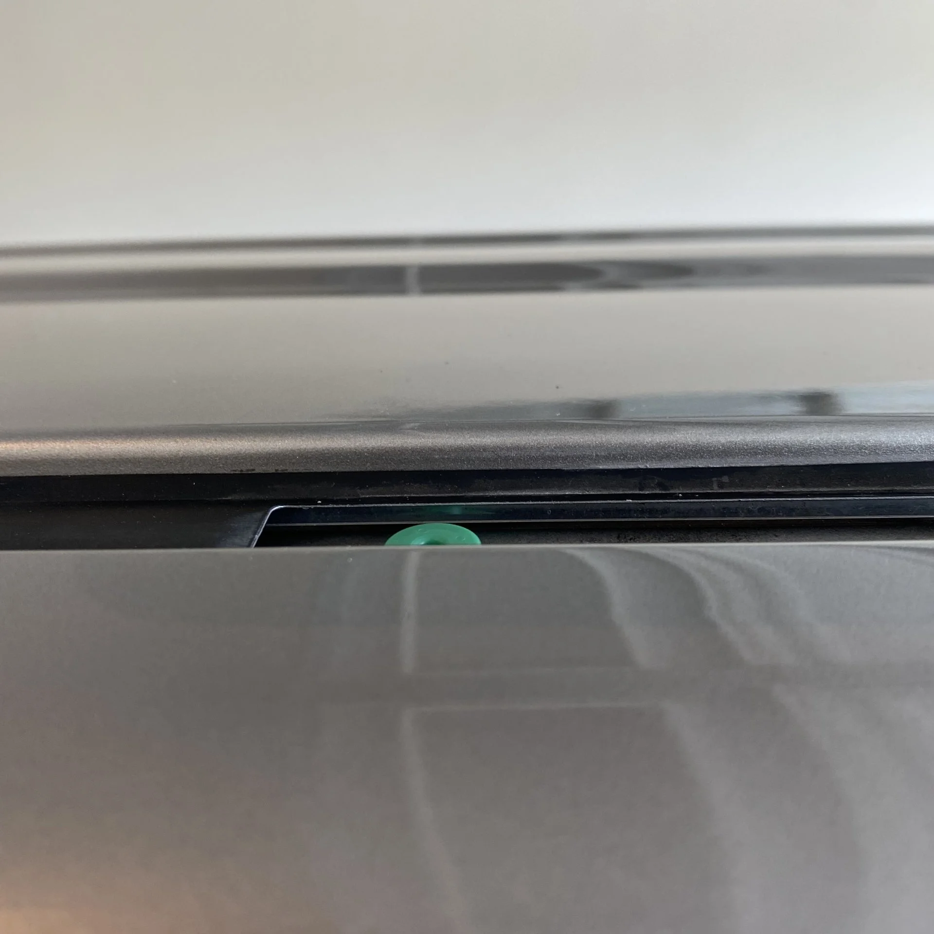

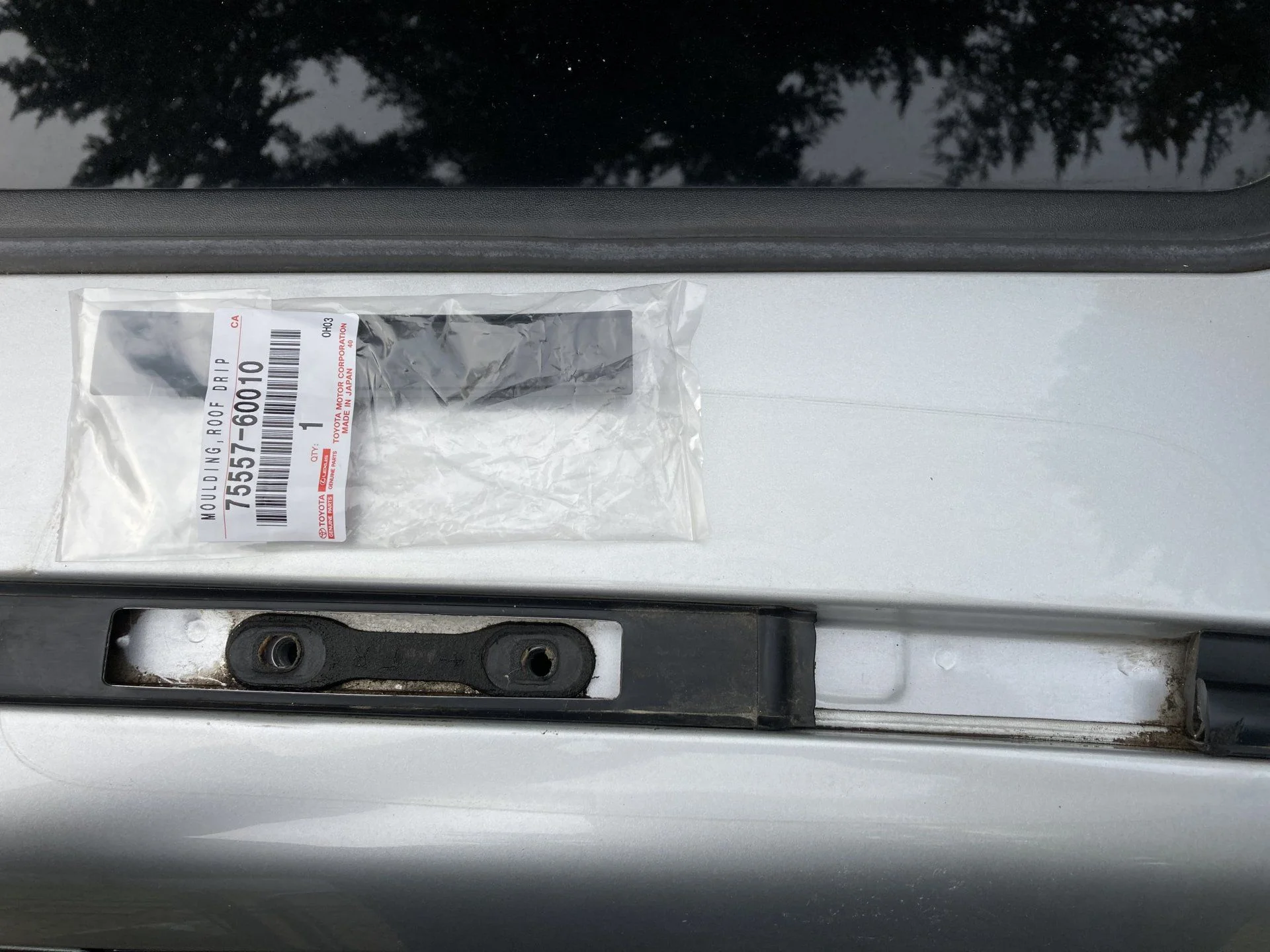

Resuscitating an old thread. First, thanks for the guidance throughout this process; it made it super easy. I have a 2004 with three mounting points per side and non-Torx head bolts (req'd a 12mm socket). Here are pics for reference. All bolts backed out easily. All my moldings are in-tact and seem to be the correct length, so looking to pick up some new bolts to reseat in the holes and then six 75557-60010 covers to close things back up. Lastly, I'll need to clean up the paint where the rack mounts sat for 17 years.
Just an update.

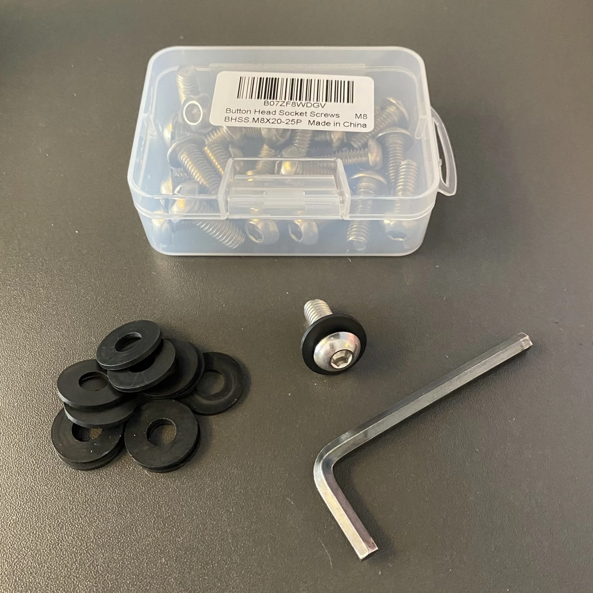

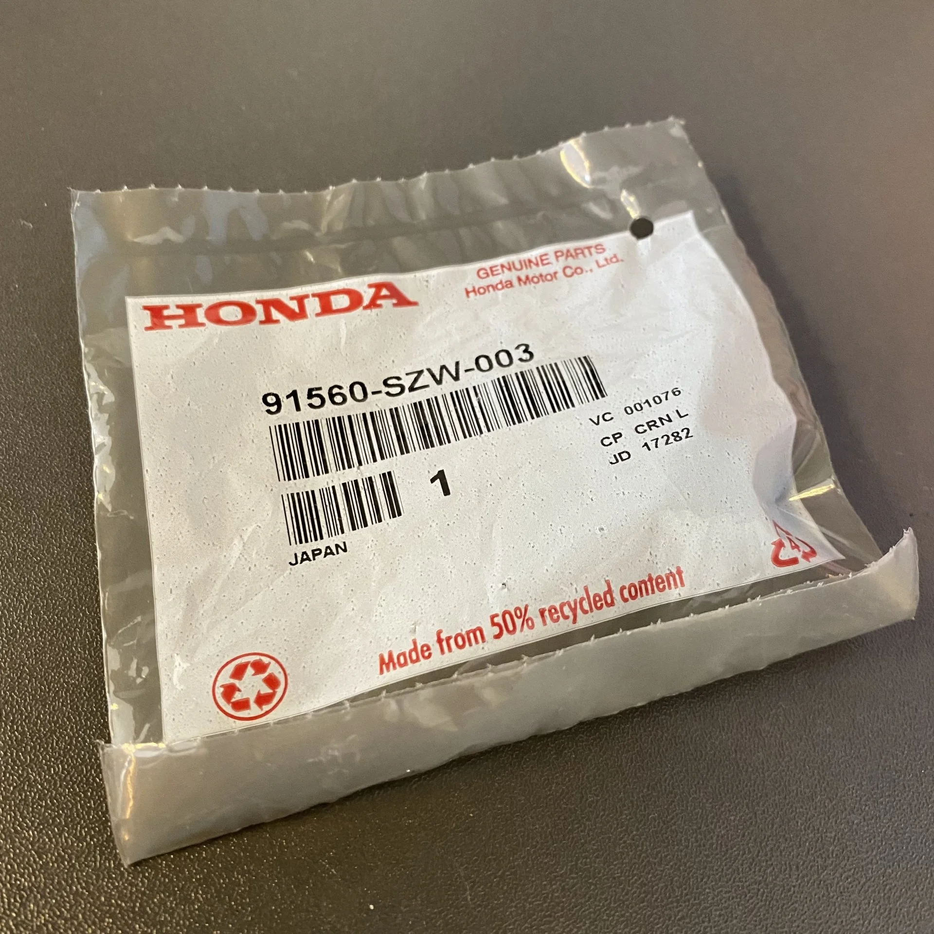

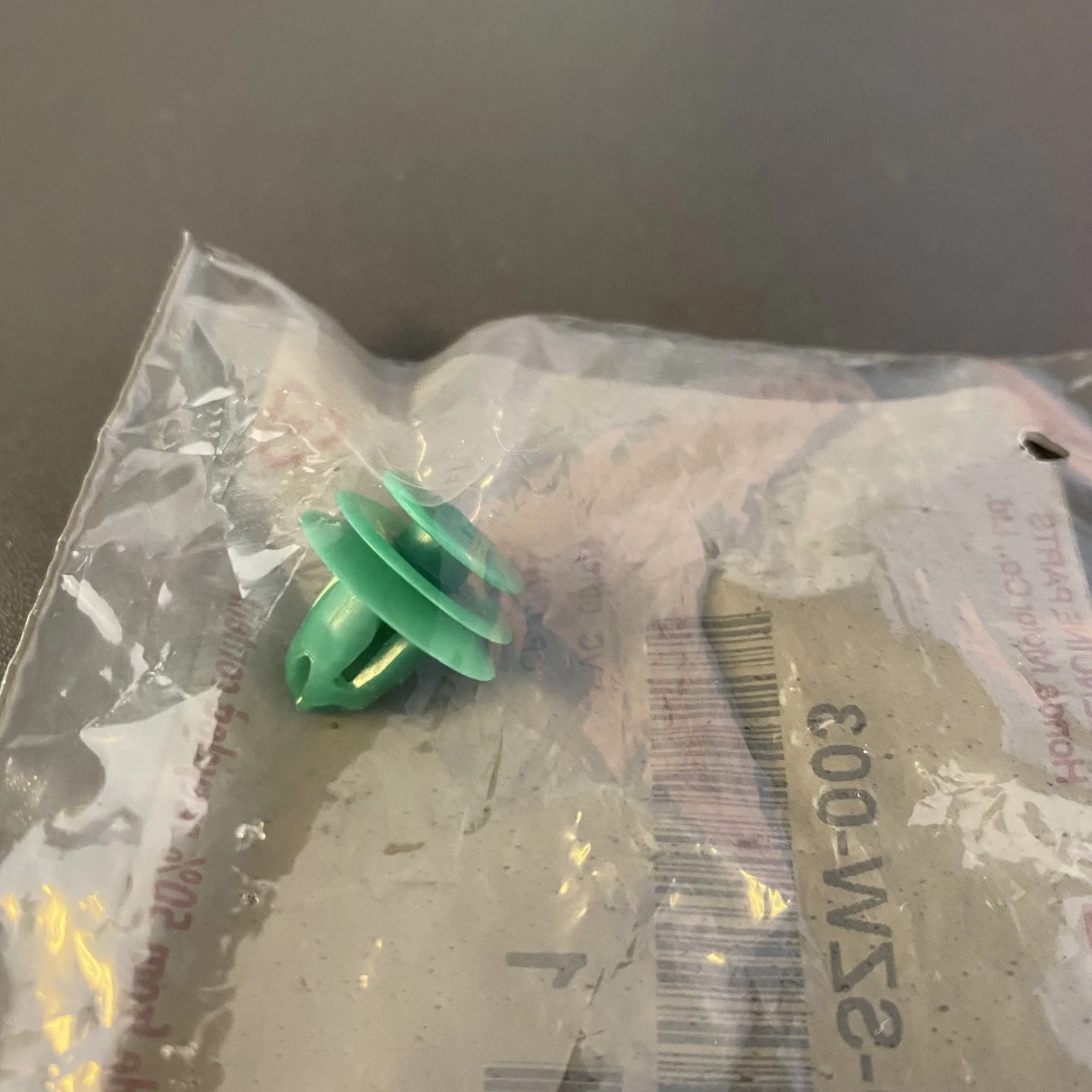

I ordered stainless steel M8-1.25 x 20mm button head socket cap screws for their lower profile and combined these with rubber washers to fill in 10 of the 12 threaded holes. A 5mm allen wrench is what you'll need to tighten them down. For the remaining two holes (middle mounting point, forward-most hole), they're threaded, but nothing seems to actually thread in fully. I just so happened to have something on-hand that I thought "what the hell, I'll try it" and it worked like a charm. They're Honda part # 91560-SZW-003, CLIP, DOOR LINING. Seriously, they work so good that I almost wish I just bought 12 of them and used these instead of screws. Fitment was great (tight and secure!), they're low profile for clearance purposes, and they have enough of a head on them that you could easily remove them with a trim removal tool if you ever decide to go back to the OEM roof rack.
Link to button head socket screws on AMZN.
I would worry that the plastic will crack and get brittle in the sun, it will also shrink in the cold. It might work well today but I don't think that's a good long term fix if your goal is to just plug those holes. The rubber washers & bolts should be much more long term.
All fair points. Note that they will be covered by the fitted inserts from TOYOTA, so not exposed to the sun. The trouble is that a bolt won’t thread into that hole on either side; the factory roof rack has a peg more or less that fits into that hole whereas all the other ones had bolts threaded into them.
Ok I know what you're talking about. there are actually threads in that hole where the peg was, you just have to run a tap down there to clean it up. And then it will perform just like all of the other threaded holes on the roof. But it's really difficult to get a bolt started in that hole without chasing the threads first with a tap.
