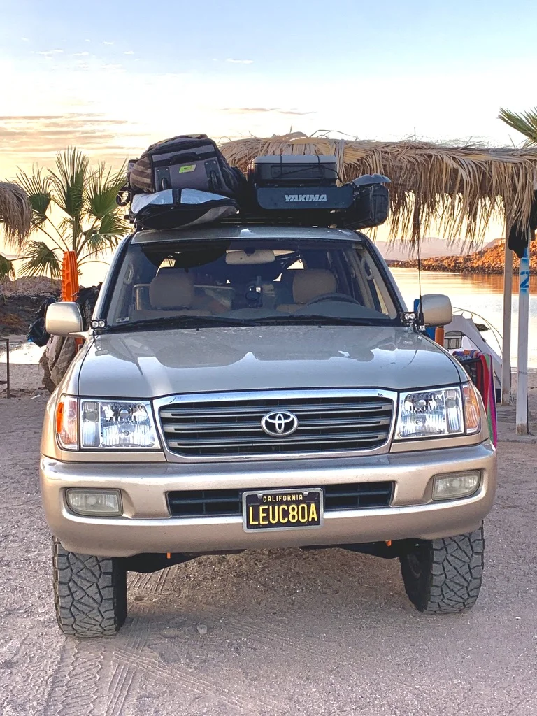

I was never able to make any use of the factory rack so I ended up going with the Rhino Rack Vortex cross bar kit for the 100 series. Three cross bars bolt into factory mounts. I use a Yakima Box (it's the skinny Carbonite one- can't remember the size), Yakima Skinny Warrior or board bags - whatever the trip requires. I am eyeing a pair of these Feldon Side Stackers to carry couple boards as well as the box and basket. They bolt onto the Vortex cross bars. Not cheap, but Baja washboards are brutal and you only lose a board bag once to make sure that never happens again. Hopefully we'll make it up to Tofino one of these years. Good luck!
