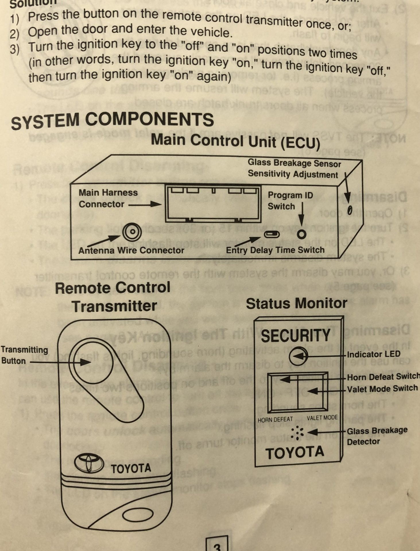

Because I don’t know how to use it properly. It automatically sets if the keys are in the ignition for more than 30 seconds even if the doors are unlocked.
There is a manual floating around on here that details how to disable the auto set feature on the alarm. I would do that before removing it.
If you have this ECU under driver seat & status monitor to the left of your locking diff dial ;) , let me know
I’ll send you pics of relevant pages from the manual
Very helpful, thank you
