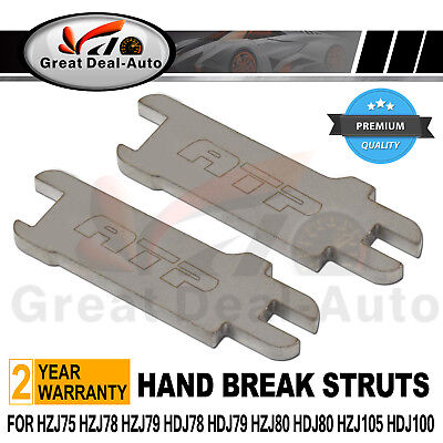

Extended handbrake dog bone/strut available from US seller?
Aug 15, 2016
66
1,799
Orlando, FL
I've only been able to find this from Australian sellers. I can't see spending $60-100 for shipping a part that would fit in an envelope. I've contacted several sellers, and they all quote the same price for shipping, so they must be getting them drop shipped from the manufacturer. Anyone know of any sources in the US for these? I'd make my own, but I don't weld.
Same part number on Cruiser Brothers listed on this website in Australia; at least you can see it and see the cross reference model years.
Picture & product description of the terrain tamer modified strut on Aussie retailers website
Somebody tell me what these do?
Said to improve e-brake shoe contact against the drum- resulting in a reduced handbrake pull.
