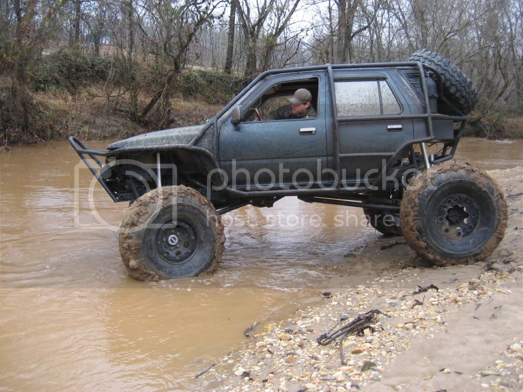

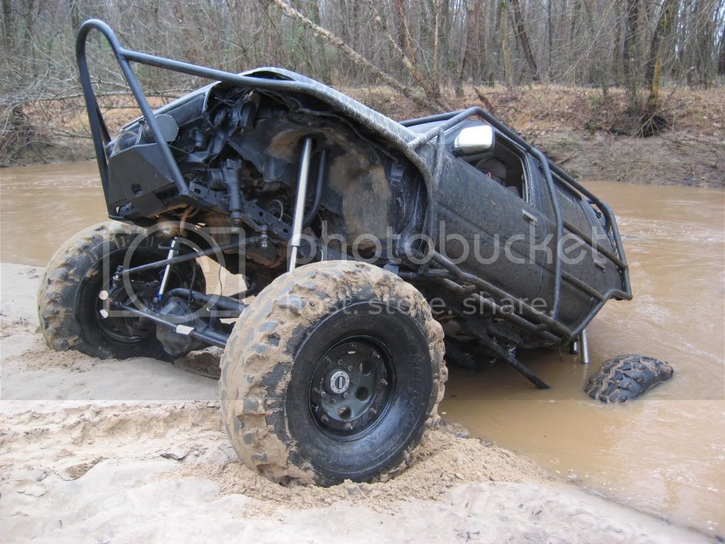

Here is the exo I did on my 4runner... If they hug & follow the body lines I think they look good.
The front was tied in under the hood into the shock mounts but I did plan on a crowl bar too.
I built this with a hand pump bender except for the stinger.
nice rig man. reminds me of a buggy but very well done.
