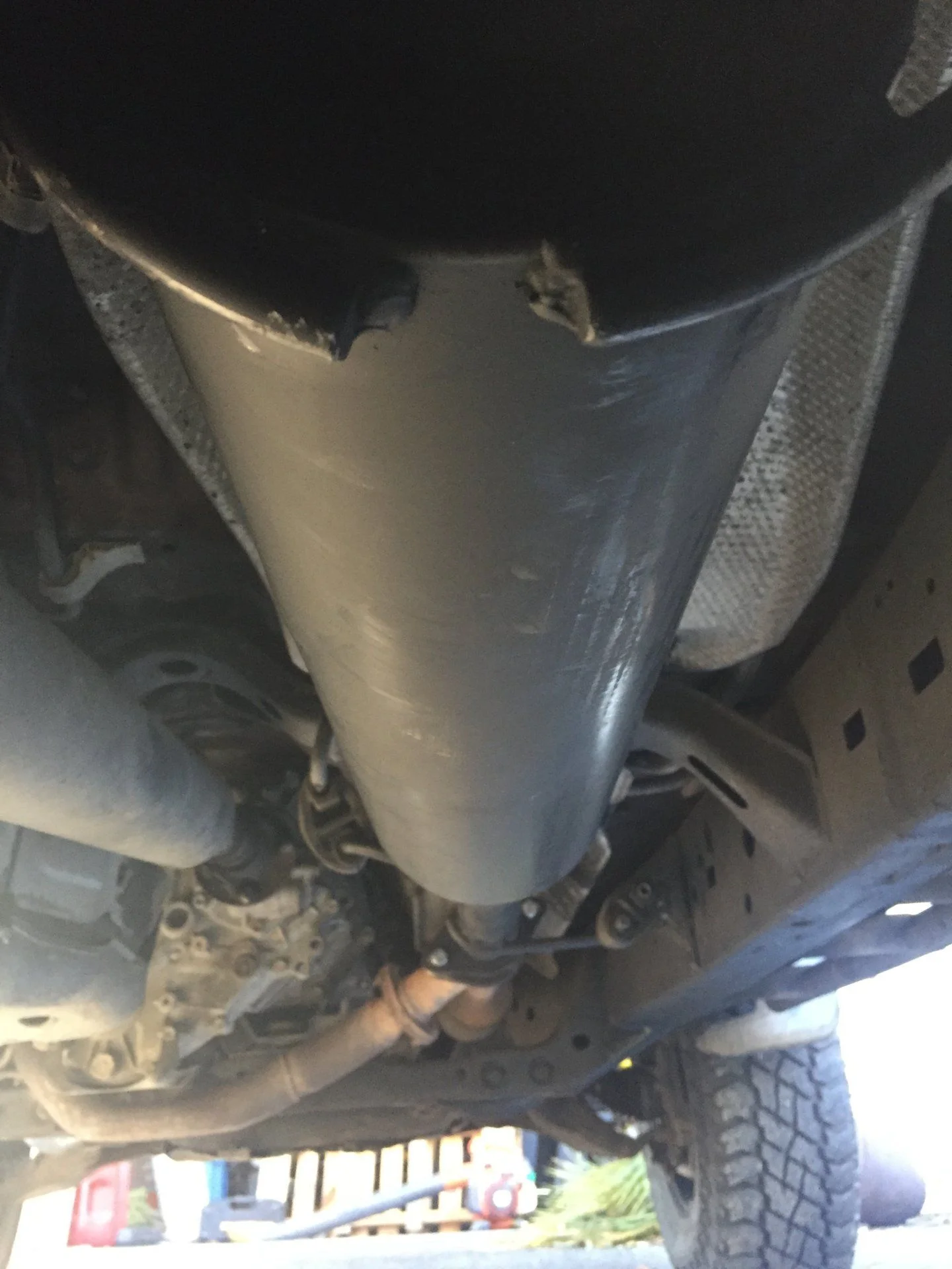

This was my setup

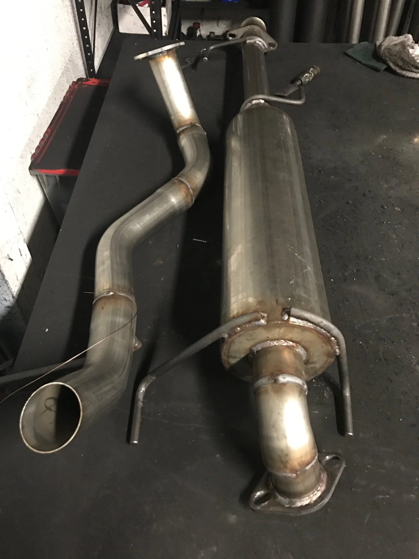

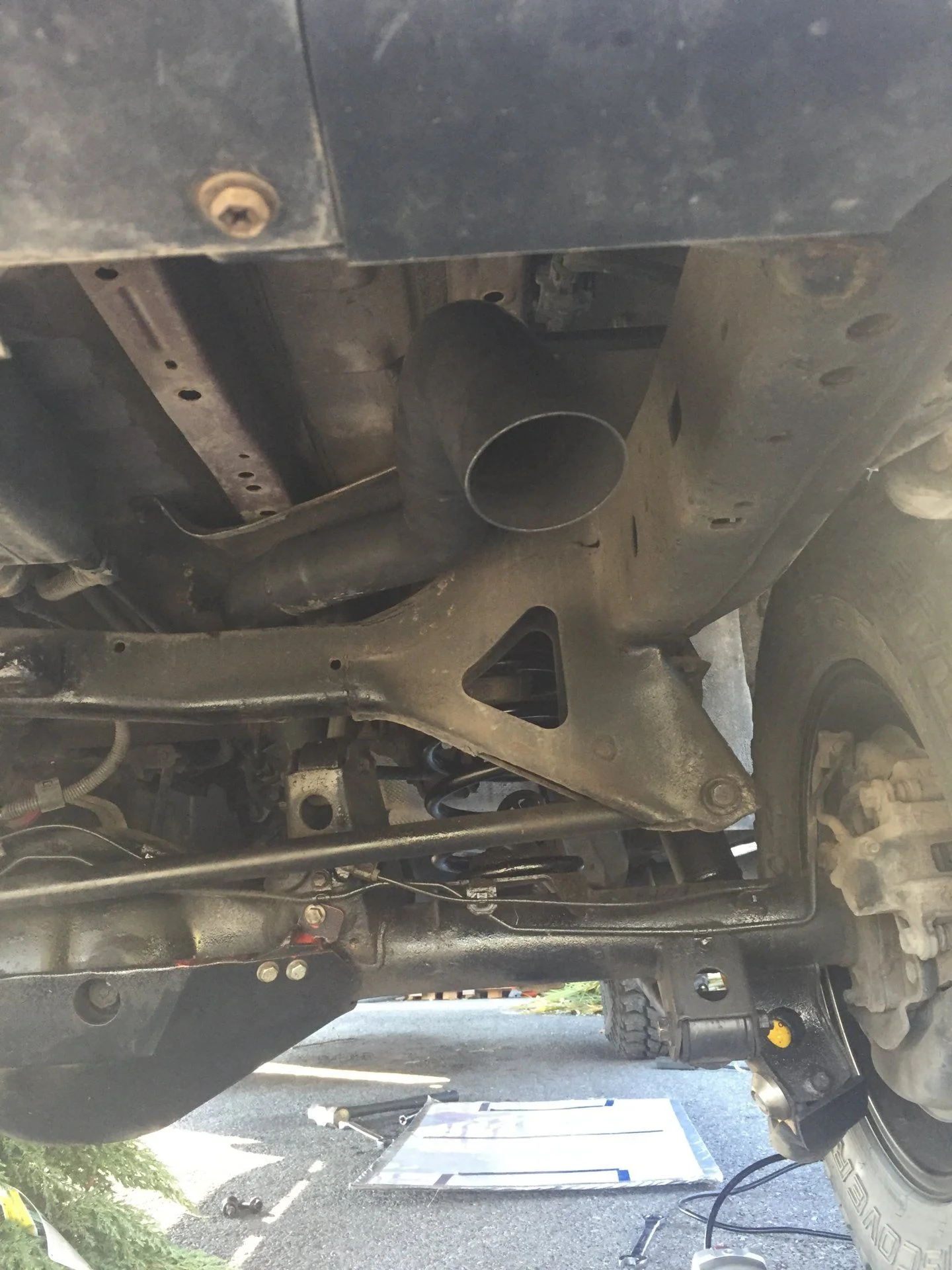

I put a straight through Magnaflow (2.5" in and out) on mine, cut off the resonator at the rear, and turned it out the side. Sounded great...just loud enough to know it was there, but in no way annoying.
Think it was a 22" long muffler, the part number is in my old build thread. I'll grab it and edit / post it here. EDIT: Part #12586

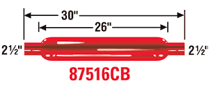

Looks like the Flowmaster FX straight trough which is what we need is a round canister. Says moderate to aggressive sound. Anybody try it out yet?
I guess I should have been more clear. I don’t want a round canister type muffler for the GX. Which is what the Flowmaster FX is that fits our vehicle.
