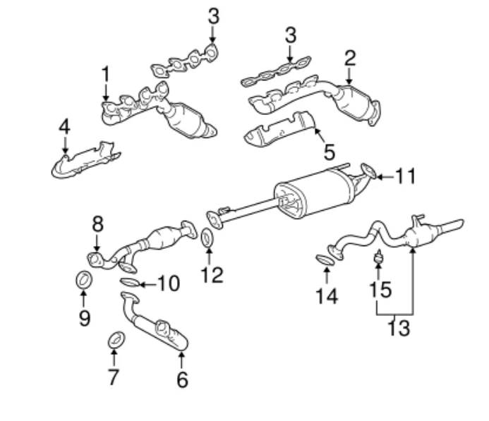

My real confusion and why I am here asking for help is that my exhaust system seems to have 3 catalytic converters. One for each cylinder bank and one downstream after a cross over pipe from the driver side ties into the combiner and right after that is yet another converter. What is odd is that that converter is not monitored by sensors and I looked up the PN (17410-50360) and on Lexus Kendall where the below diagram is from is shows as a discontinued part.
1. Should I not worry about that catalytic converter, maybe even drill it out if it appears to be clogged. That part is also by far one of the most expensive parts at over 1200 and it seems silly to spend that money for a cat that is not even part of the emissions test. I know at the smog place I bring this truck to no probe is used, meaning they solely rely on the OBD2 readout.
2. should I only buy and replace the cat for which the ECU is throwing a code or should I just bite the bullet and buy both. I can get them both from Bells Lexus in Scottsdale for about 1100 shipped.
I don't believe in patching this up with an O2 sensor extension, plus if the cats are really starting to fall apart I am also loosing engine power from increased back pressure.
Has anyone any idea how hard it is to get to the header bolts on both the driver and passenger side? Meaning is this something I could manage on my own without lift or am I better off to bring it to a local shop, hand them the new cat(s) and be done with it?
The 3rd cat is not monitored by any of the system, so it's can't throw a code. I would be very surprised if it was damaged. But, you can easily check by dropping out the Y pipe and seeing if the honeycomb is clogged/damaged with an inspection camera. If it is damaged, you might be able to fix it with a universal Magnaflow weld-in cat. But I'm not 100% sure if a universal cat is allowed in CA, or if you have to go OEM.

All GX470s have two primary cats attached to the manifolds. The cats themselves rarely fail, typically you get a stress crack and a leak in the manifold in front of the cat. The manifolds fail frequently. Does your engine have a ticking sounds on cold starts? Very common.
Some GX's have the third cat after the "Y" joint. Some have a third and fourth cat before the "y" joint. It depends what year/emissions configuration. Your ECM only monitors the primary cats. The models with 4 cats have a shorter pipe going into the muffler, the exhaust is the same otherwise.

In case anyone needs the part list for a 2004 GX470 for both upfront cats here is it (confirm by using the diagram in the first post this is your layout and if anything else, reach out to your preferred dealer to confirm directly against your VIN):
Left side manifold
1710550170 - Lexus Catalytic Converter with Integrated Exhaust | Bell Lexus North Scottsdale, Scottsdale AZ - https://parts.belllexusnorthscottsdale.com/p/62999276/17105-50170.html
Rights side manifold
1710450180 - Lexus Catalytic Converter with Integrated Exhaust | Bell Lexus North Scottsdale, Scottsdale AZ - https://parts.belllexusnorthscottsdale.com/p/63056734/17104-50180.html
Exhaust manifold gaskets order 2
1717350021 - Lexus Exhaust Manifold Gasket (Left). EXHAUST | Bell Lexus North Scottsdale, Scottsdale AZ - https://parts.belllexusnorthscottsdale.com/p/63016264/17173-50021.html
Donut exhaust gasket order 2
9008043036 - Lexus Gasket, exhaust pipe. Intake | Bell Lexus North Scottsdale, Scottsdale AZ - https://parts.belllexusnorthscottsdale.com/p/62973191/90080-43036.html
