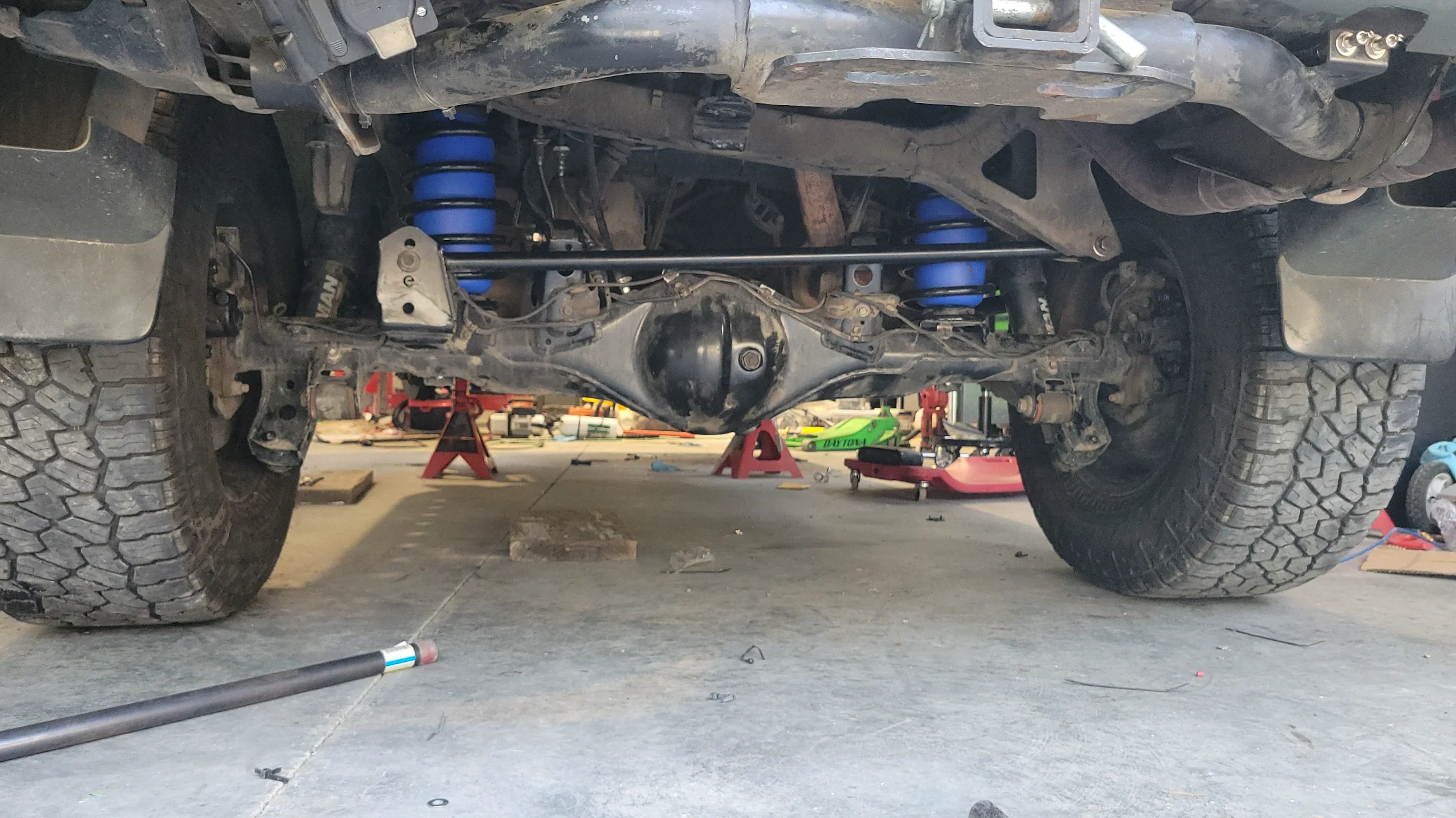

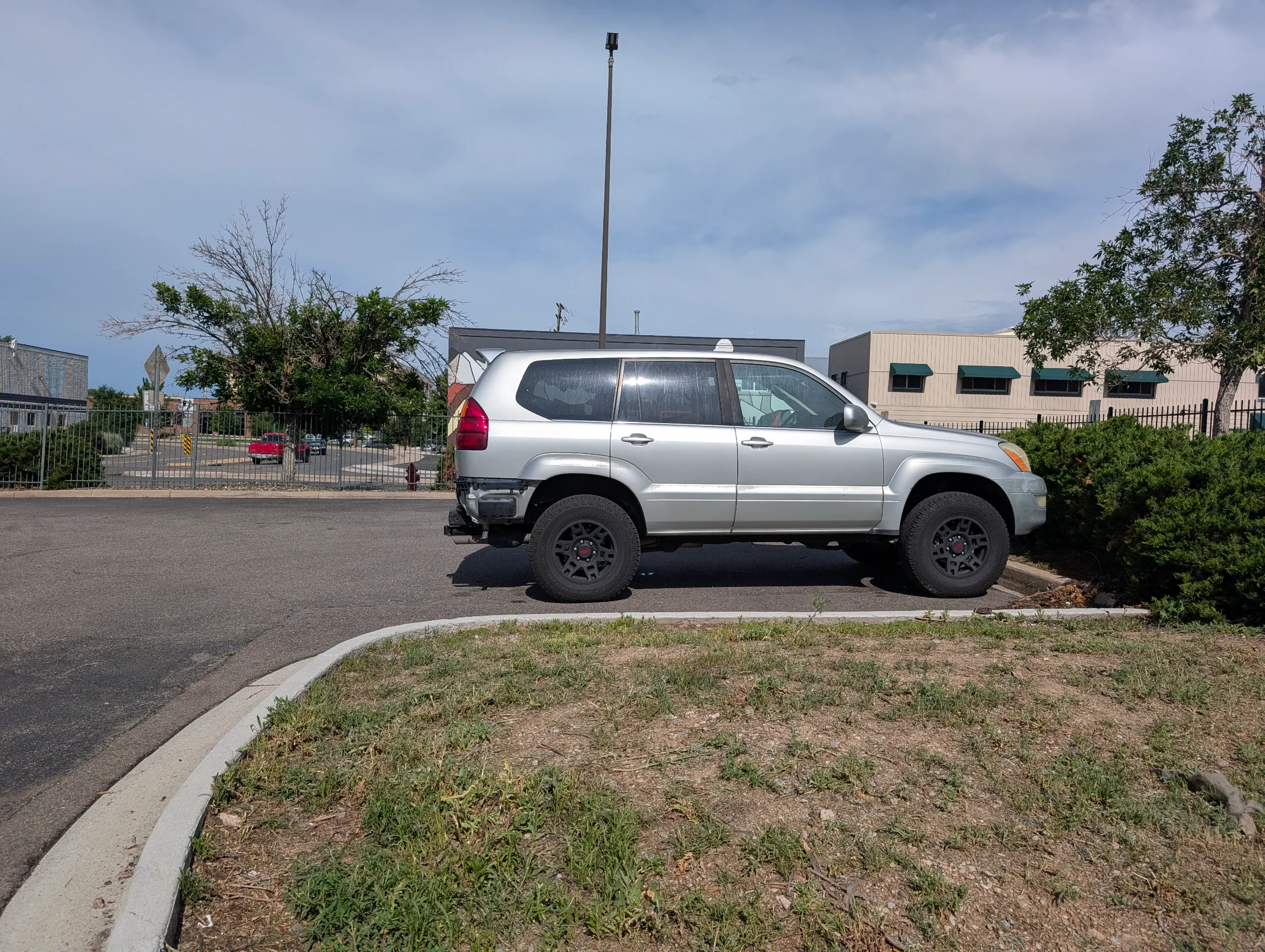

I'm running the Eiback pro Coilover kit in the front and their adjustable height coil system in the rear. Only gives about 1" lift on the lowest setting in the rear, that I'm on.
P255/75R-17 Yokohama Geolandar A/T G015 SL tires

Thanks for including the picture, any rubbing or any other issues of note? Stock UCAs?

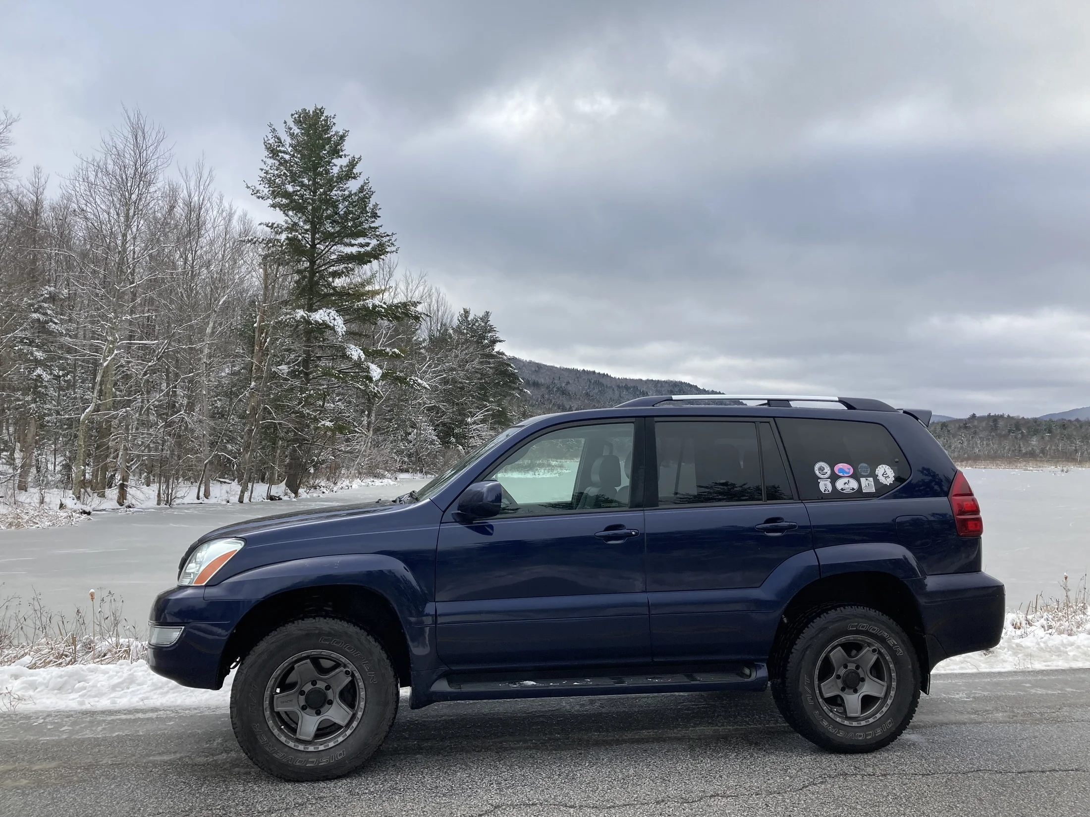

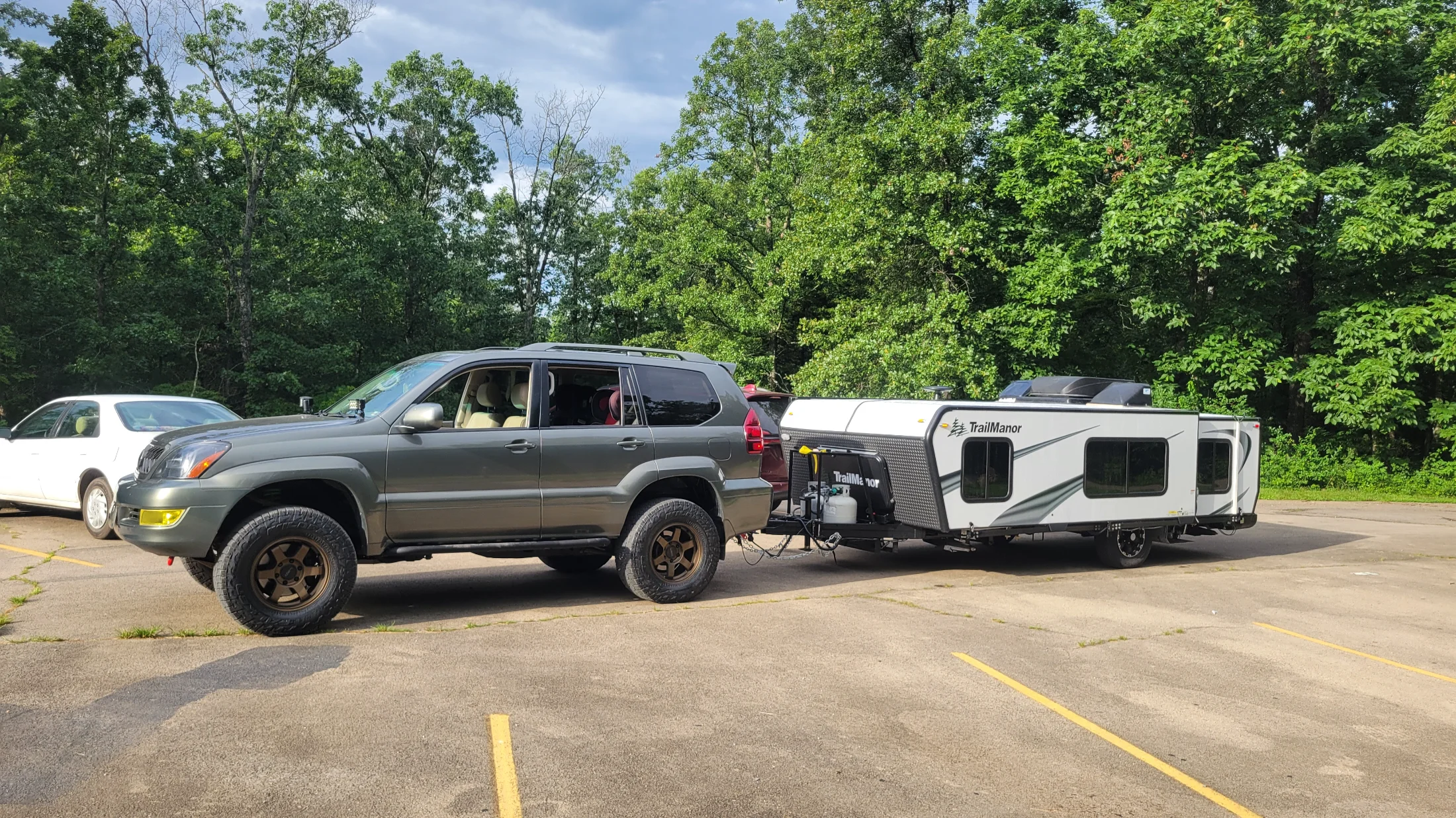

Rig looks sick! What size wheels and tires if you don’t mind? Good to know about adding the inner airbags, I’ll have to look into this more. Do you remove them when your not towing or just simply deflate them?

The bags are ran at 5 psi when empty (Firestone says not to totally deflate them). Tires are 285/70R17 Wildepak AT4Ws, wheels are cheapo Vors VE37 (17x8.5, 0" offset) that have actually been pretty good.
