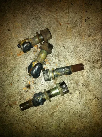

For the two that snapped on mine, I welded a new nut to the exposed end of the stud, using a size that would slip partially onto the end of the stud. And by welded I mean turned it to full blast and heated the nut/stud until they were glowing and starting to sag under the influence of gravity. HOT is the goal. That was the only thing that ever got them to break free, no amount of spray, pipe wrenches, or cussing moved them. They backed right out after that.
You might have to start the weld to the nut with a few tacks just to make sure that the current/heat is going to the stud too, otherwise you just make a blob insight the nut that does not really attach to the stud.

Welding a nut on them or just welding on them so the studs get red hot works. If you take it to a machine shop, it is what they will most likely do because it is fast and it works. If you don't have a welder, this is a good time to get a $100 Lincoln AC buzz box off of Craigs list and save the money you would pay the machine shop. Even a rookie can weld a nut on to a broken stud, but practice on a few first. Use 7018 rod as it doesn't stick as well to cast iron in this application as 6011 because of the heavy flux.

It isn't just heat; it is heating them to red hot so that the metal shrinks when it cools that makes it easy to get them out.
You need to heat it above the austenitic 1 (A1) phase transition temperature, which is roughly 1300F.
