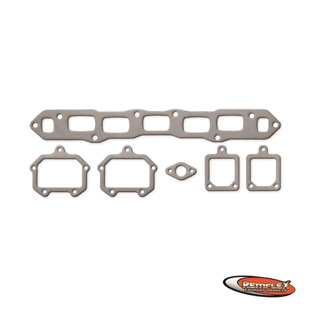

If you're using any gaskets other than Remflex, save yourself some headache and just get a set.
For the collector, I use either Toyota OEM, or Fel-Pro 23561 / 23591, depending on what pipe size you have.
I had flange leak issues until I switched to the Remflex gasket....never had any issues with the collector flange using either OEM or Fel-Pro.
Great tip, much appreciated, I’ll have a look
