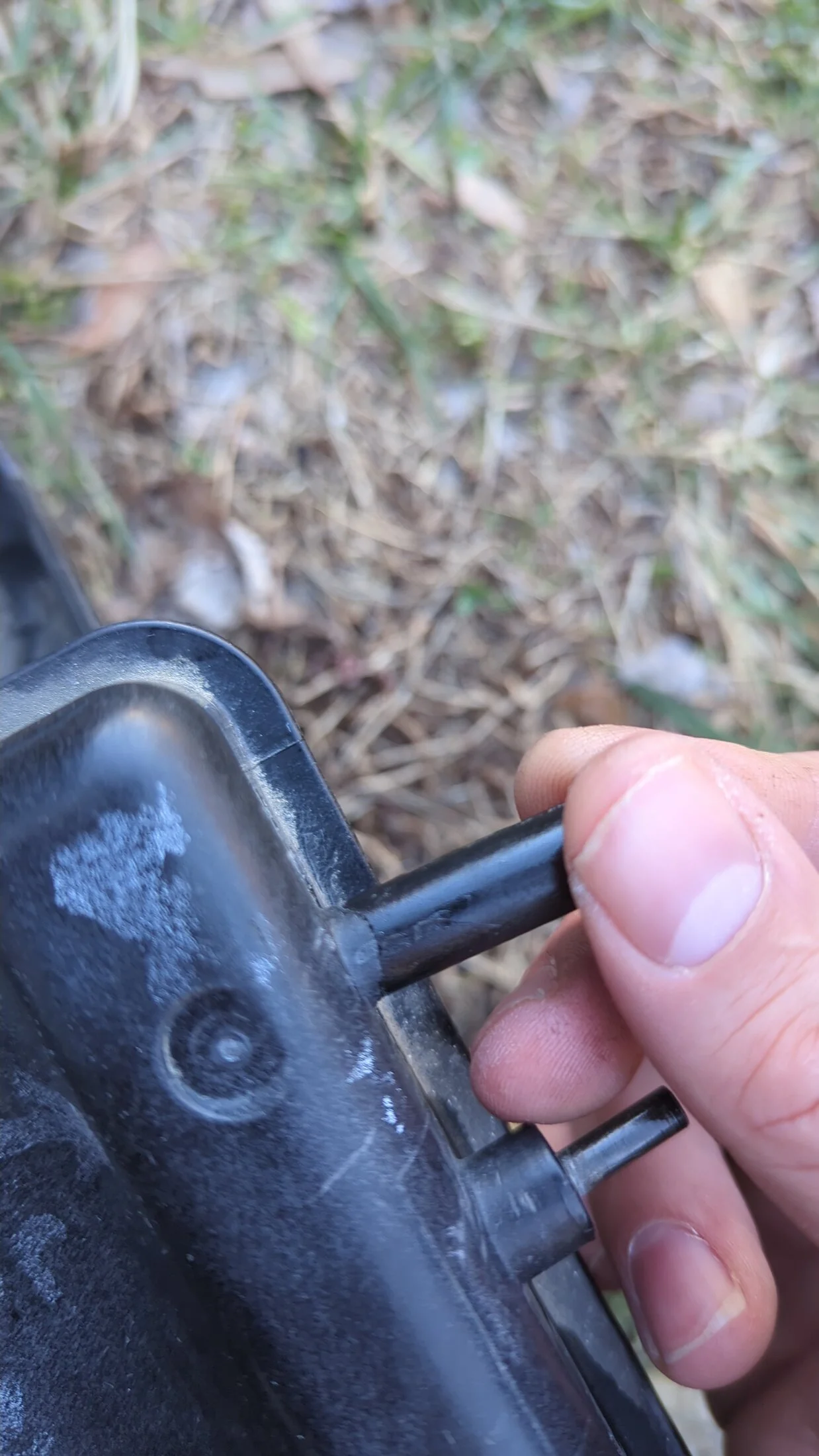

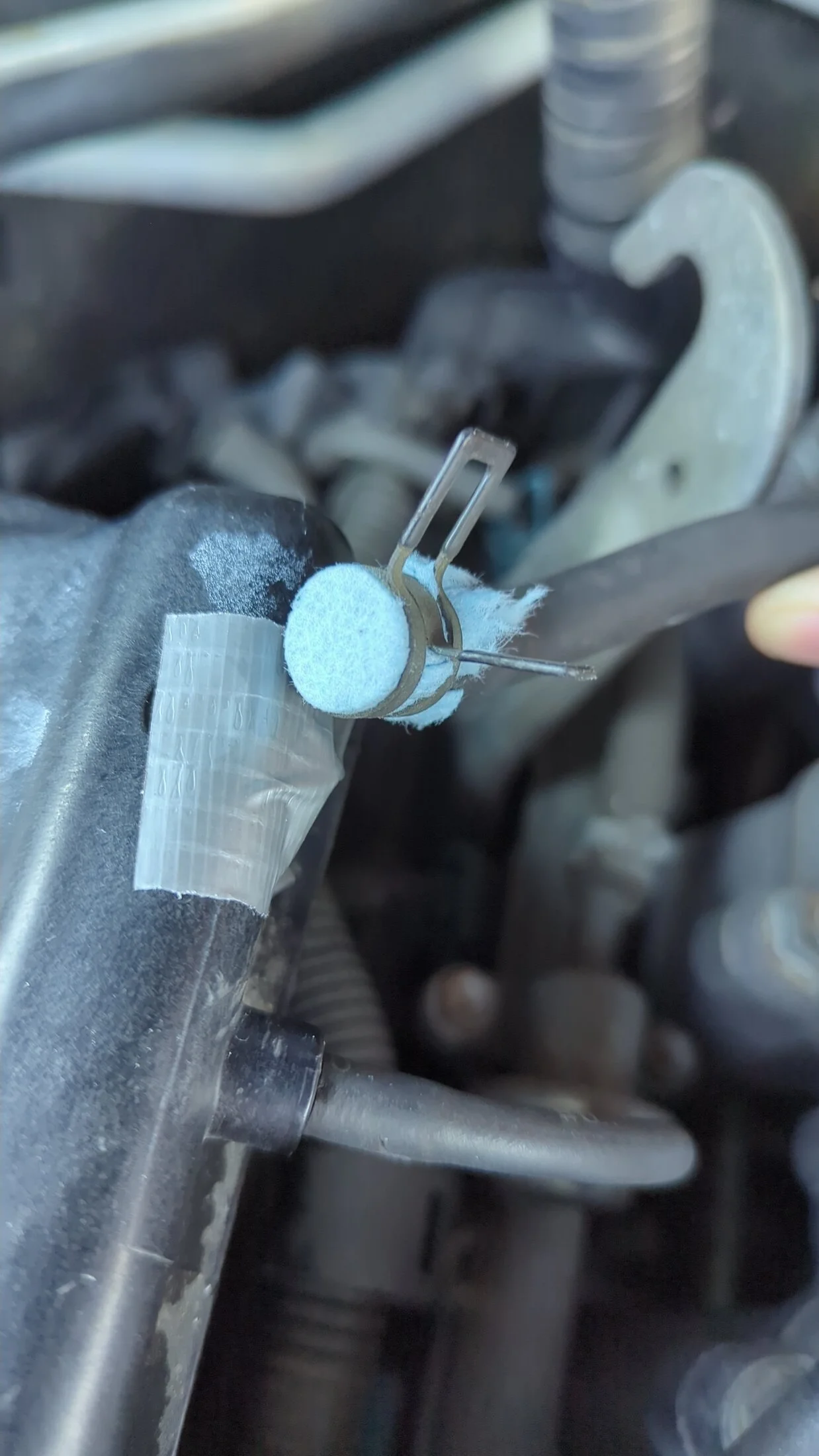

Recently I was checking on a squeaking pulley and pulled off the air intake to get more elbow room. Through an unfortunate series of events, I broke off the nipple that the EVAP hose connects to. See photos below. I tried gorilla glueing it back in place, which held and was air-tight, but it doesn't have the structural integrity to stay in place and attach both ends of the hose (breaks back off). What's my best course of action? Finding a used intake, or should I not wory about the EVAP making its way into the intake? For now, I've covered it with shop towel as seen in images below.

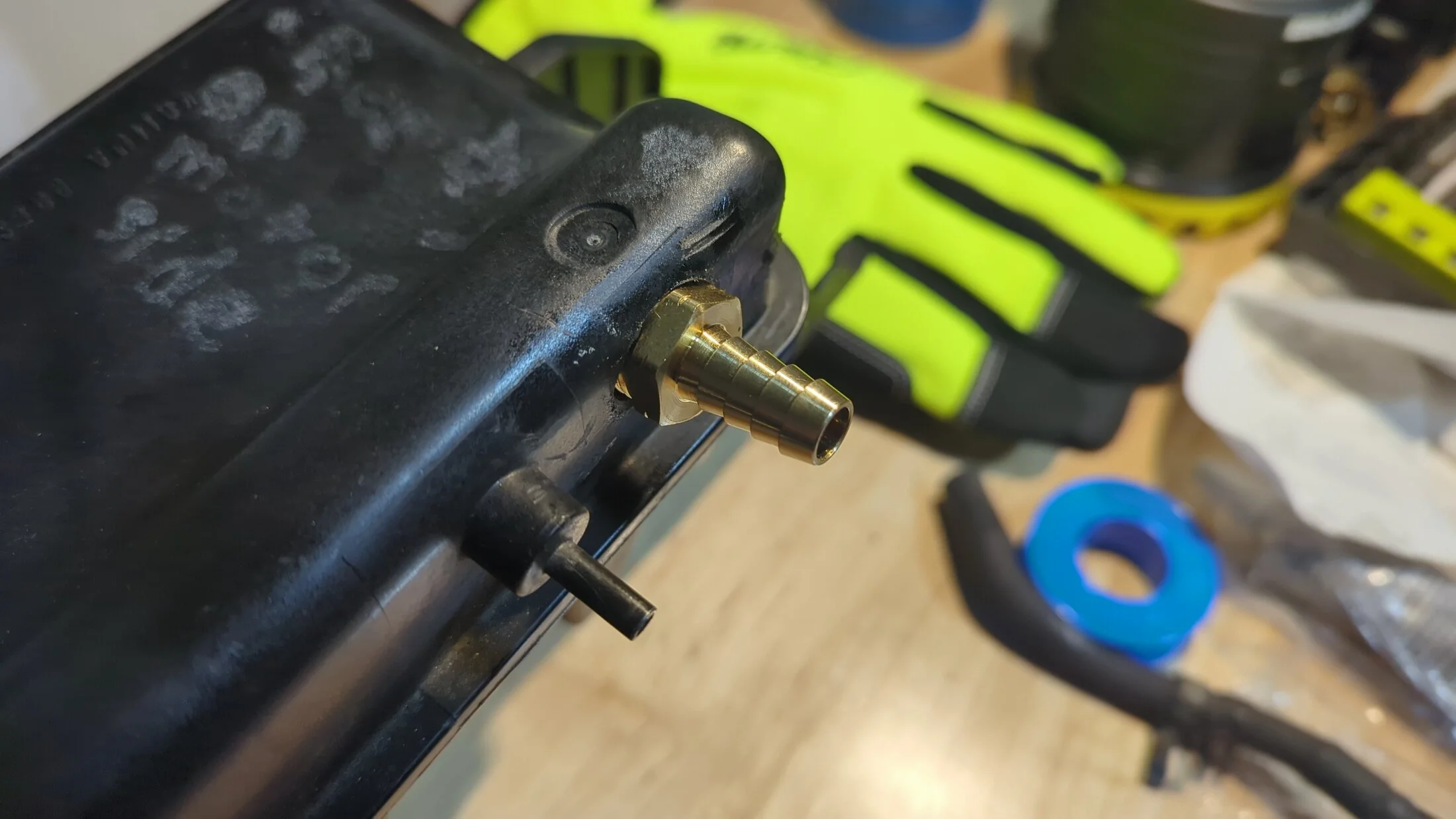

I've repaired two of these in the past with great results. Go to the hardware store and get a brass pipe fitting with a barbed end that is the correct size for the vacuum hose. now drill the plastic housing slightly smaller than the threads on the fitting. I then threaded the fitting into the housing. I then unthread it, wrap it with some tephlon tape and put it back in there for eternity. Its much stronger than the original and you won't sweat removing that vacuum line every time you need to take off the intake tube.

@Bisho that worked like a charm. I did this the other night and it went smoothly. I may still add some some sealant around it to make it more air tight, but it holds strong and fit the hose well.
Notes for anyone who does this in the future:
  • I used a 3/8" -> 3/8" joiner from Home Depot. They didn't have any mismatched-size joiners or I would have gotten one instead -- e.g. 1/4" -> 3/8". Reason being that the threaded side of the joiner is very large and I don't think I could have drilled a hole any larger than I did for this 3/8". Ideally the threaded end would have been 1/4" or smaller.
    • The barbed end of your joiner will need to be 3/8". This is the diameter of the hose.
  • I used a stepper bit until it was large enough to thread the joiner.
    • You should use your girthiest stepper bit here. If your stepper bit is too long, you might start cutting into the plastic on the other side of the cavity.
  • Put lithium grease on your stepper bit. Clean it off after each time you size up. Go slow. And maybe have a second pair of hands to run a shop vac. I'm fairly sure I cought 99% of plastic shavings doing this. The shop vac wasn't all that helpful -- mostly the grease caught shavings. I simply used headlight bulb grease.
  • For good measure, you can seal off the main inlet and outlet of the intake with whatever you like and then vaccum out anything you can via your cool new brass fitting. This will force air out of the brass fitting by only allowing air to intake via the smaller fittings on the intake assembly. This was my best idea of how to double check that I'd gotten as much shavings out as possible.
