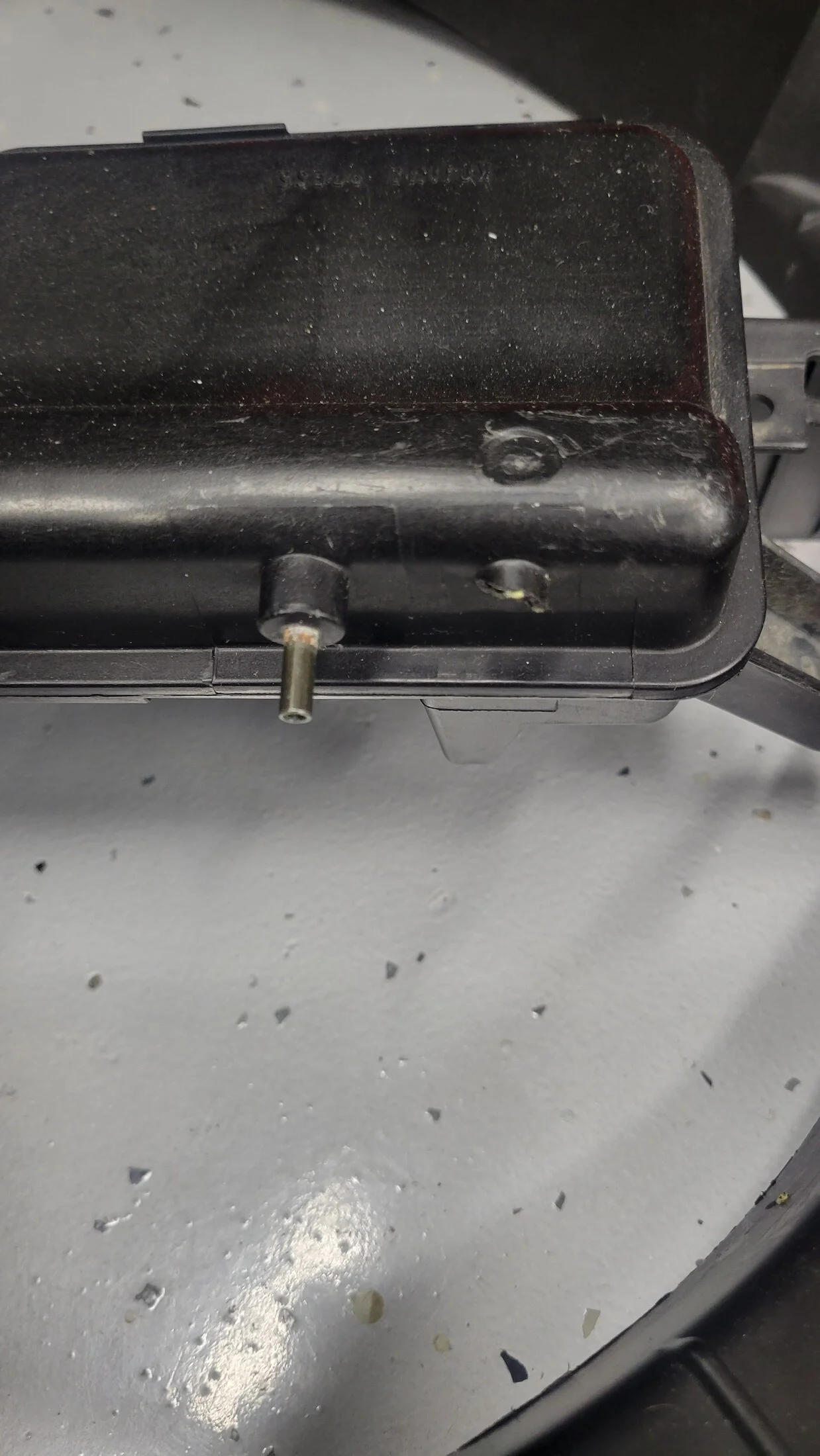

Hi folks,
Looks like someone broke this vacuum hose fitting off the intake air plenum. Can someone measure what OD the metal/barb fitting should be? The intact one next to it is 4.75mm, but with my entire engine out of the vehicle I don't actually know what hose attaches to the broken port, haha. If someone could grab a quick measurement so I could order the appropriate fitting to retrofit it, I'd appreciate it!

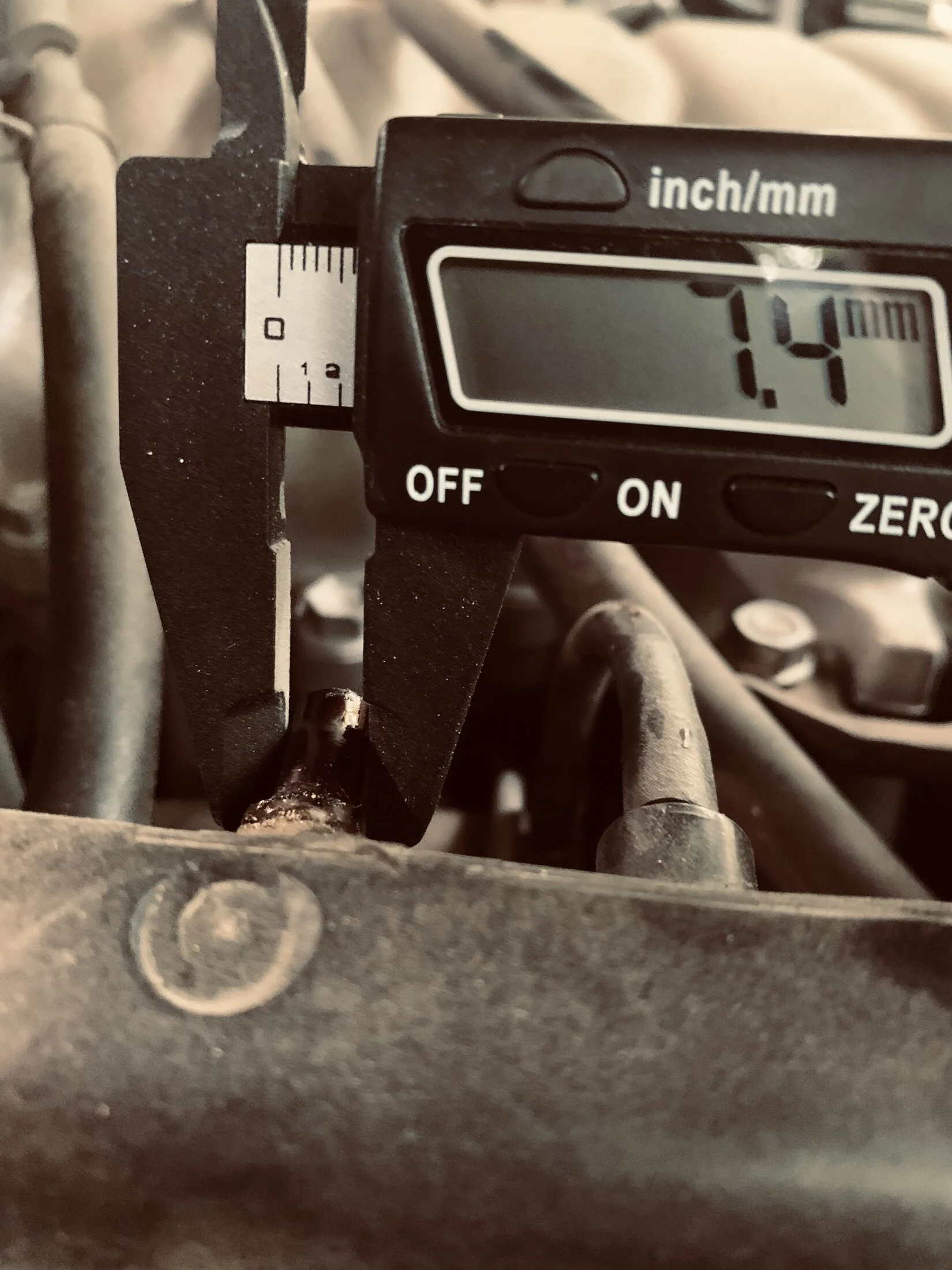

I used an aluminum arrow shaft that fit perfectly then JB Weld to secure. This shows it about 7.4mm.
