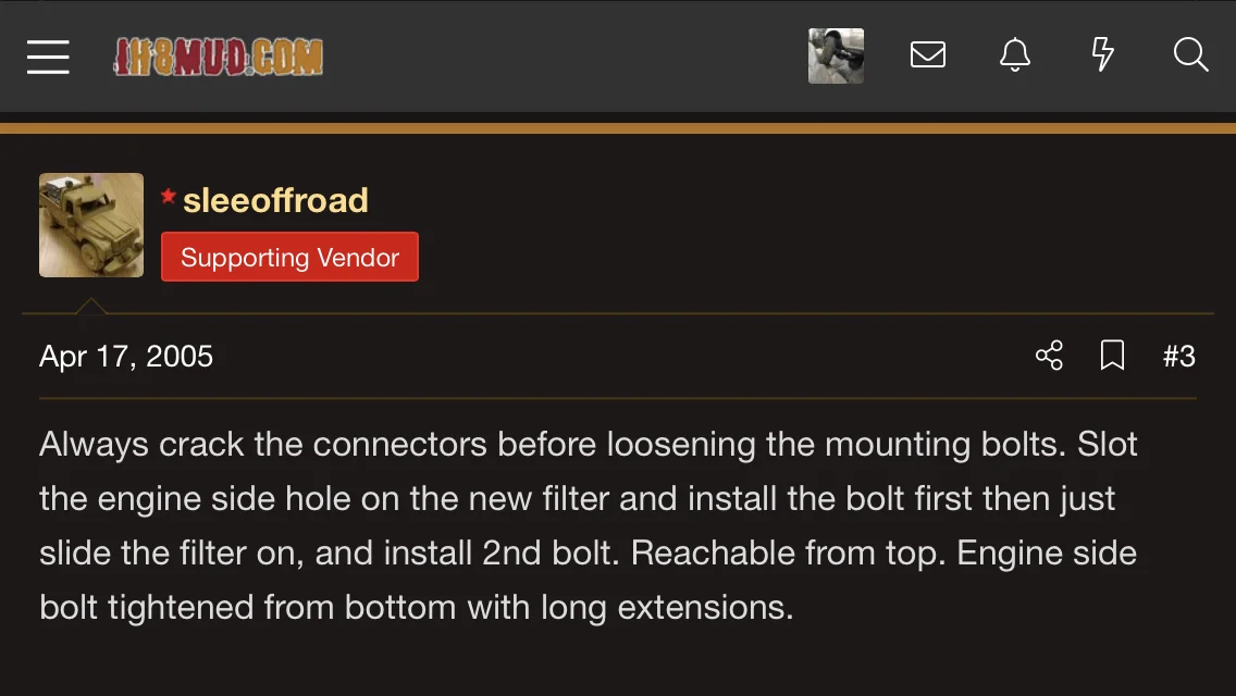

New fuel filter and all the bits needed are on the way. Went ahead and ordered a new fusible link and the box because it was cheap enough and why not. I'll get the filter switched this weekend and then use some elbow grease and patience to go through all the connections and make sure everything there is good to go. Hopefully will be smooth sailing from there. Thanks everyone who helped out!

There are two filters. The in-tank "sock" and the inline under the intake manifold. Do both.
You may find a bare wire grounding out on the fuel pump frame when on an incline or it's rusty as can be with bad connections.
