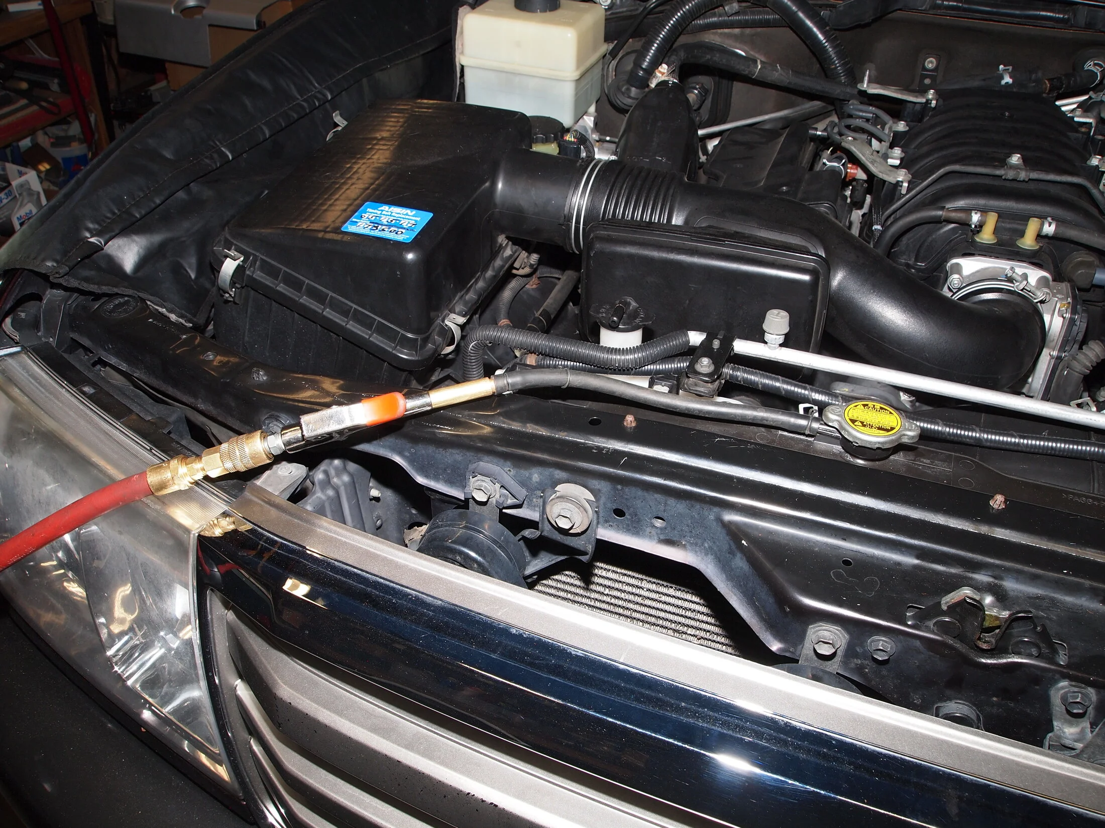

Pink (pre mix), which states never add water. If I must add D-water, after a chemical flush. I'll blow out the system. Which I can then, get ~3.7 gal. Add back 3.7 gal pink, but flush again 2yr 30K for next two flushes, to get D-water out. Then pick back up, the 5yr 50K mile flush of SLL pink schedule.
Shop air pressure set to ~17PSI.
Catch can, must have air pressure relief hole cut in it.
The 100 series has a glitch, in expansion take (reservoir) system. Where it's reservoir will not function as designed. Unless, radiator fill to the cap so no air in system (top of radiator). If air pocket devoples, which they often do, when block drained. We come out the next day after 8 hour cool down. Check under radiator cap and top. Repeat until no air gap found. Vehicle needs to be level. It's, best if front end higher than rear, and done before sun up (OAT raises). This puts high point at top of radiator, which air travels too highgest point.
