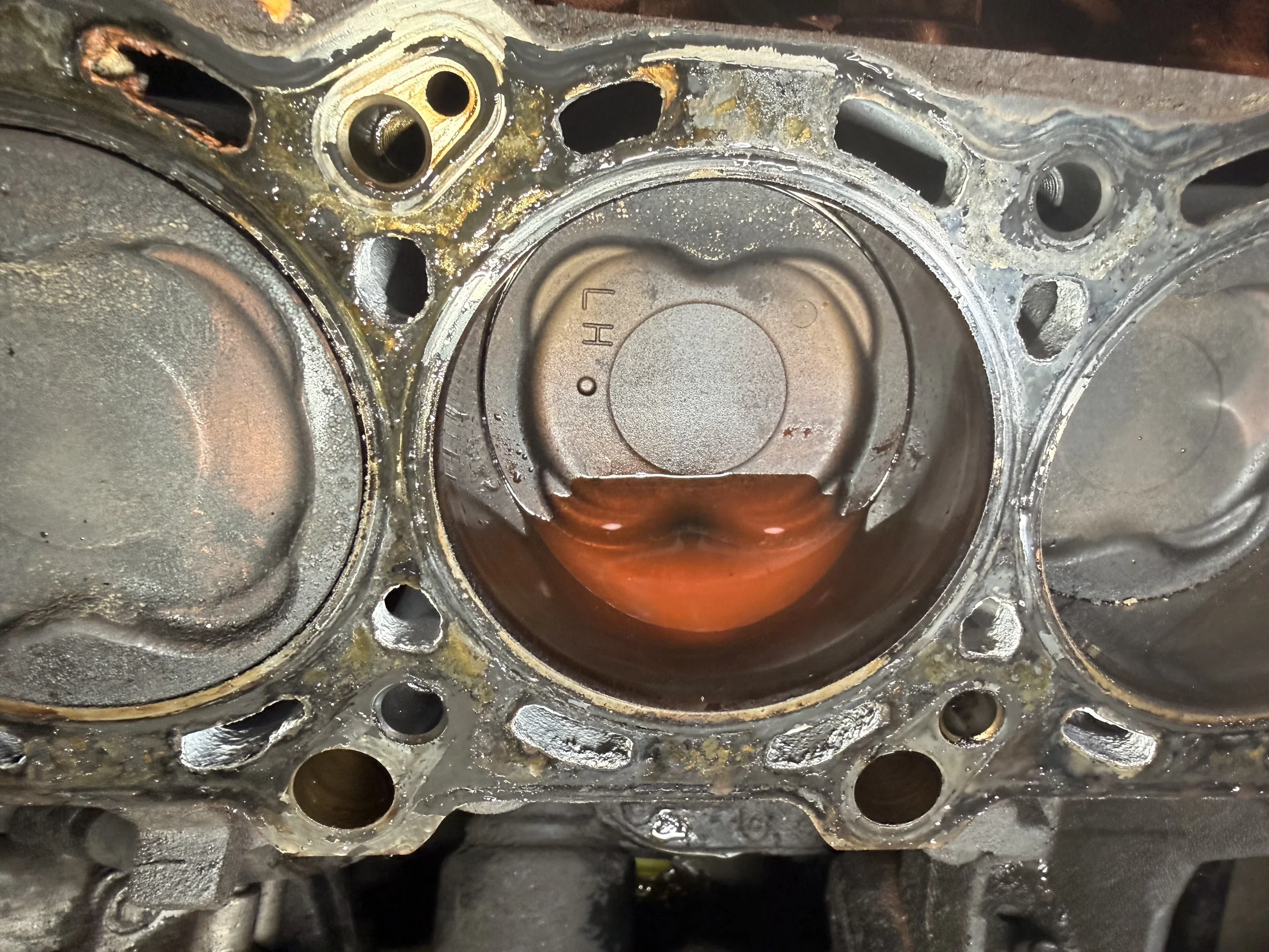

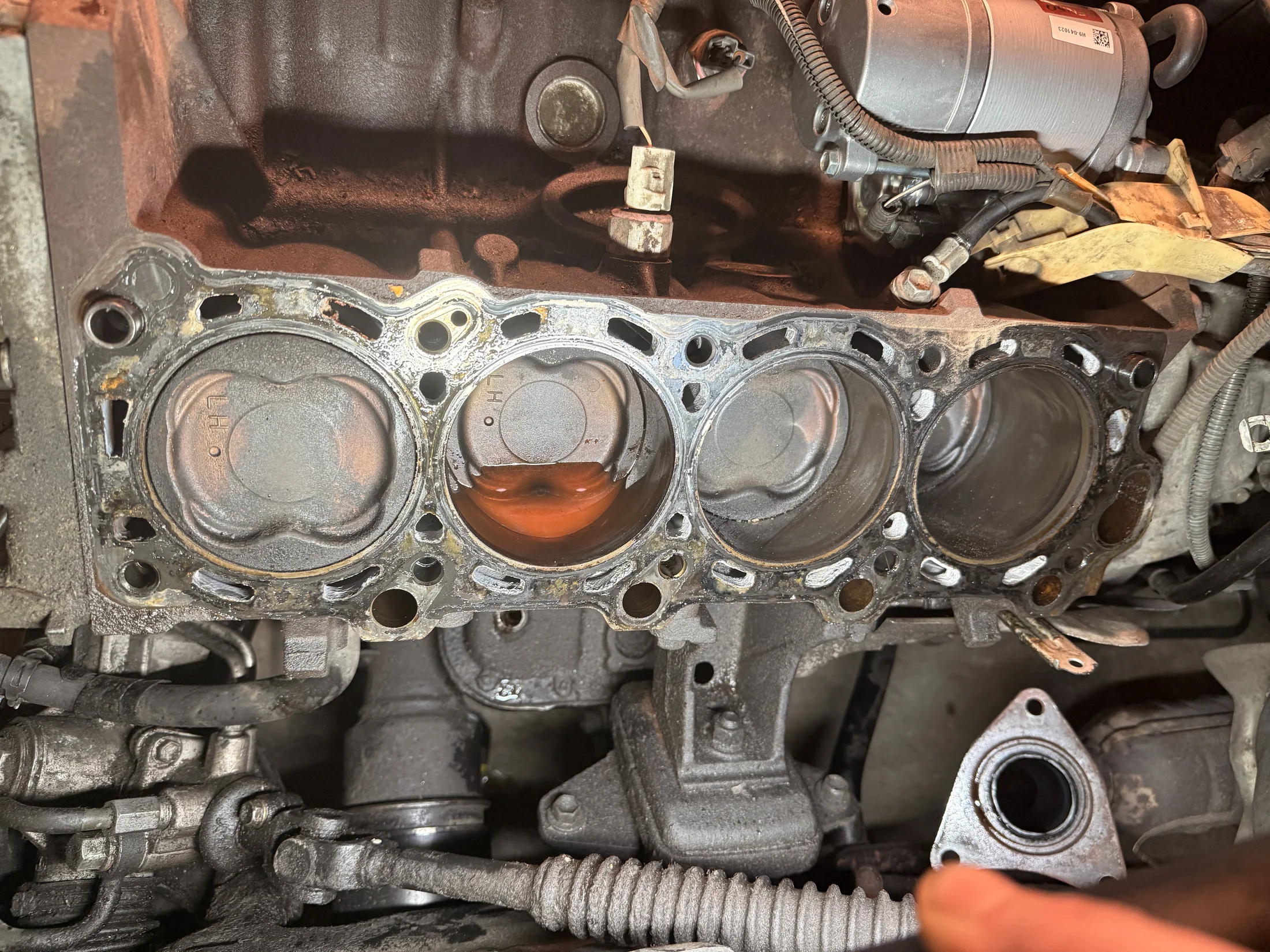

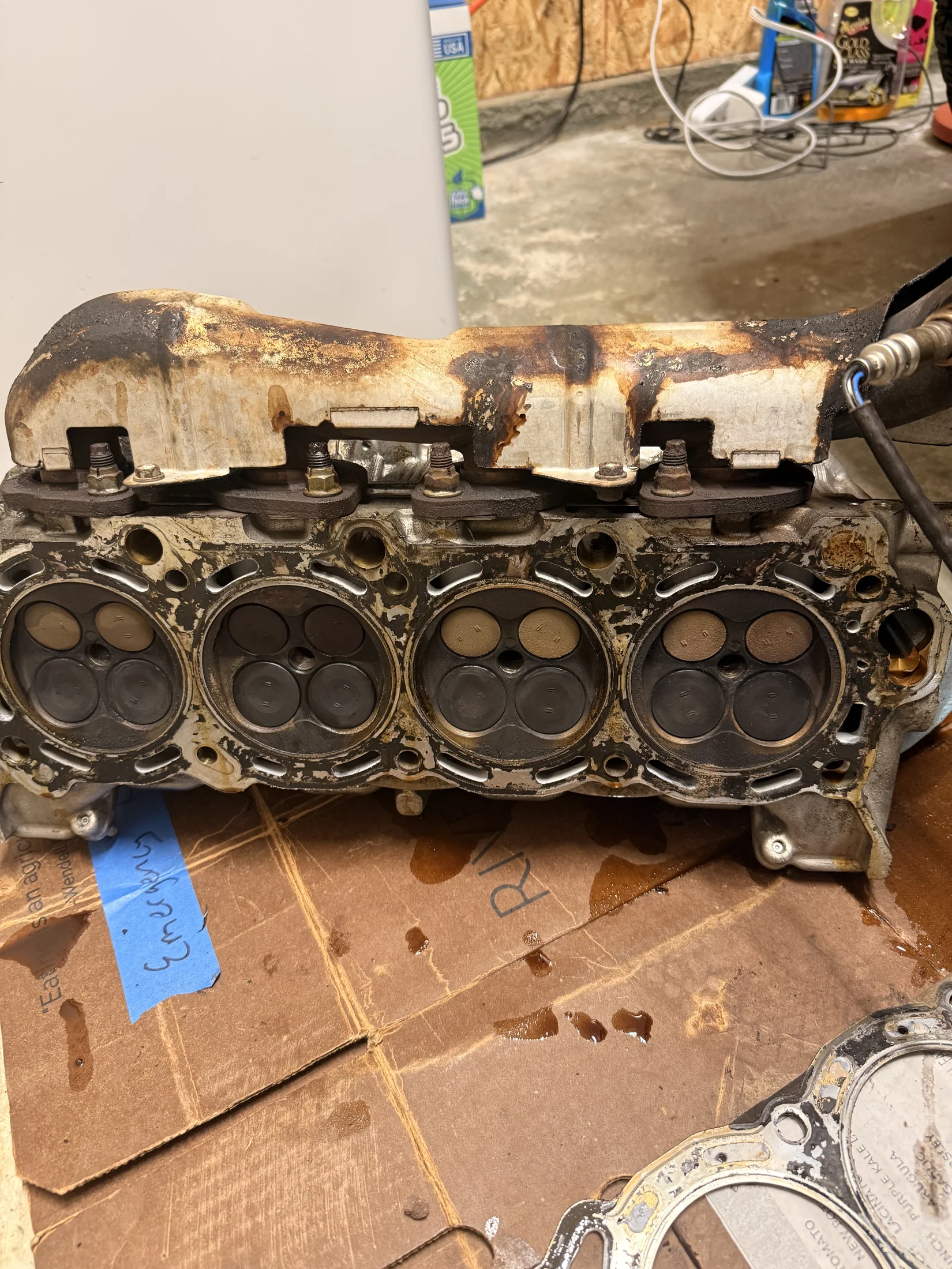

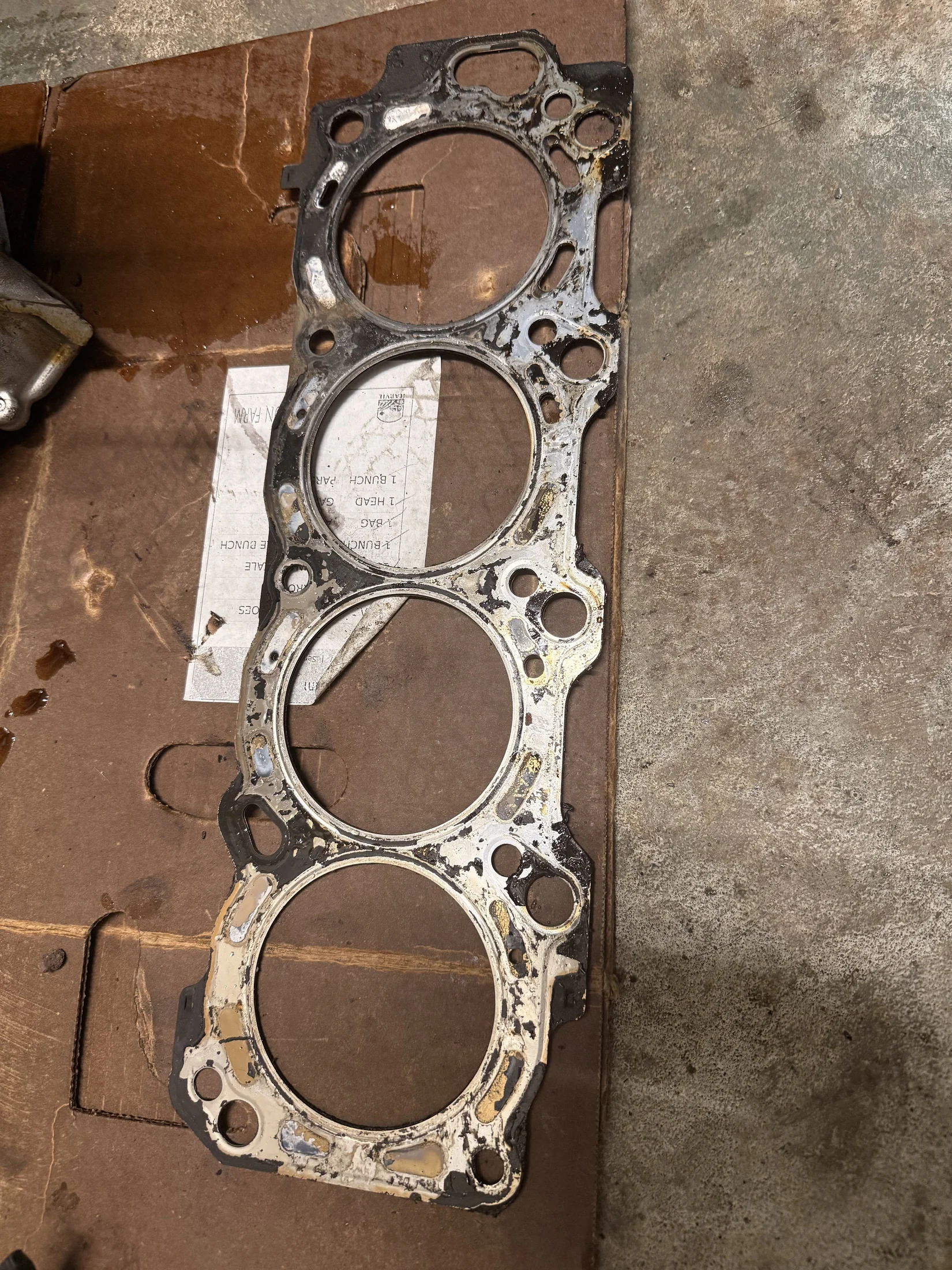

Got the left side cylinder head off. Coolant pooled in cylinder 3. Attached are pics. The valves are a different color on that cylinder too. Not sure how to tell the failure point!
I’ll get the other side off next week but I’m not sure whether I should just check the heads for warpage and clean it and call it good or if I should pull the block and make sure there’s no cracks or get it re done. Any suggestions?
I'm not extremely educated in these things but my brain is telling me that if there's no obvious failure point on the head gaskets that it might be a good idea to check the mating surface of the heads for warp/flatness at a machine shop. They can tell pretty easily, I think. You don't want to do a whole head gasket service just to put a warped head back on. Ancillary benefit, if they have to deck them to clean them up, that equals a little more compression :-)
Appreciate the reply. I have a machined straight edge I’ll use to check the head. I wasn’t planning on sending them out unless absolutely necessary.

So. That coolant could have gotten in there when you pulled the head off. In fact im pretty sure about that. When a cylinder has been burning air/furl/coolant the top of the piston will be cleaner than the others. Basically it’s been steam cleaned. The machined straight edge is a good plan. If you can get more than a 2 thou feeler gauge under it, the head needs to be decked. Same with the block. The fact that two valves are different is the clue to chase. How does the cam look for those two valves? I’m thinking about this…
The cams look perfect. No wear at all on the lobes.
