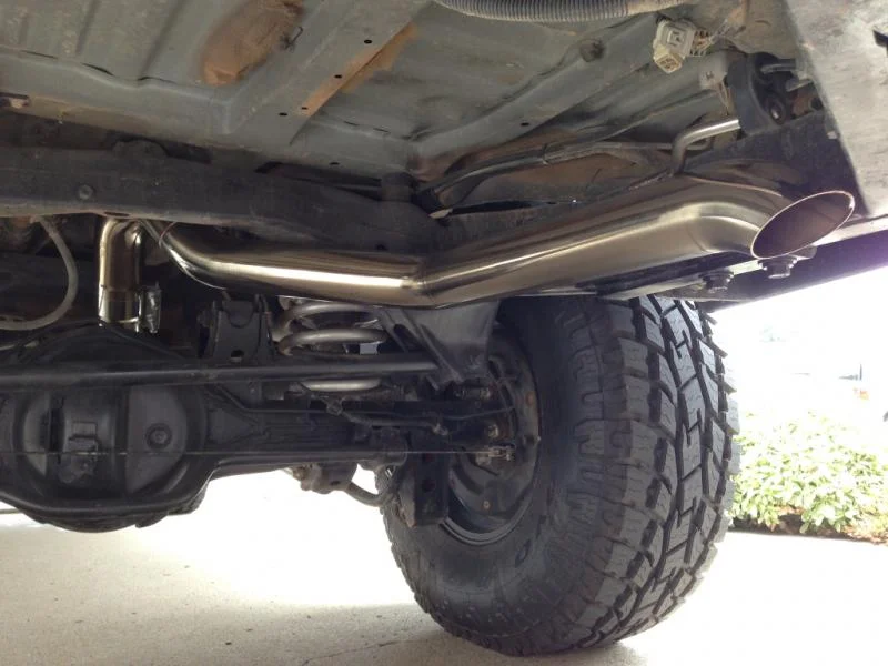

Ill do that when I get home tonight and snap a few pictures. I do recall adjusting the location of the muffler and the piping to maintain clearance in that area. Have you tried lossening all 3 brackets and trying to move the muffler forward. Lokks like there is rrom based on the location of the bar in the rubber gromet for the muffler and then the whole assembly to move forward. Mine is all shiny and stainless, what is different about yours?

This is a pic froma nother angle that doesnt address your issue of someone elses install, maybe it will help in the meantime
I will see how much play there is in the muffler moving forward and if I will get other issues, but I recall there not being a whole lot of play when it was all together before i tightened it all down. It seemed like it when together one way if you wanted it to all bolt up together well. Ill see if i can shoot some extra photos with a real camera, the iphone didn't do so well.

here are a couple of pics. It looks like the diff breather tube is touching, but its not. I moved the bracket up so it would not.
I do have a 2.5" OME lift there, more like 2" with all the weight I have in the back
Romer, can you take a picture with a tape measure like I have in the photo attached to this post? Mine looks pretty darn close. Also, in your signature you say your vehicle is lifted, so your measurement will be what the gap is minus your lift height (right?)
The rest of the photos show better what I am working with. You can see the rubber hangers are not stretched down farther than they should be.
The ome 2.5" but I have a rear bumper and ARB drawers filled with tools and parts so I doubt I get the full lift

I will snap a few photos of the same measurement with my suspension in the High mode for comparison. Honestly though my exhaust placement looks identical to yours when you consider you have a lift. It looks like I have a little over an inch of clearance and you have a little under 2" of clearance with a lift. With my suspension being much softer than yours, it will probably compress more when going over speed bumps, intersections that dip down a lot, and anywhere other scenario where the entire rear end will compress at once. I have just confirmed with EMS that I have no sag (not sure the significance of sag in this situation) and I am waiting to hear what else they would like me to inspect or do. They have been very responsive so I'm expecting more direction sometime today.
