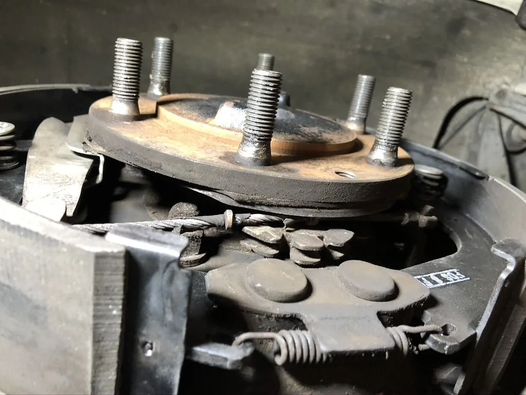

decided to save some money and have the brake shop machine my drums, and since they were in there replace the shoes.

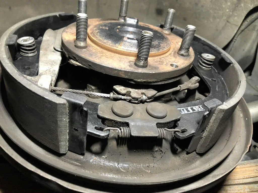

They put it all together and the pedal felt really soft and the hand brake wasn't working. They looked at me and said they adjusted the crank wheel accordingly... told them to fix it. After they did, I basically drove home with my back brakes on as they just tightened the crank wheel more.

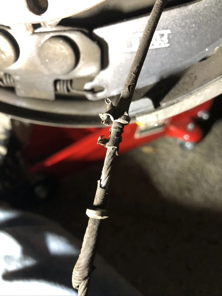

Went home and found the culprit. The emergency cable wasn't put on to the bracket on both sides and hence there was slack. I put it back on then adjusted the setting and all was OK, but I gave them s***... they really could care less. Told them to replace my torn up cable but they said it was like that when I came in (standard answer).
Do it yourself....

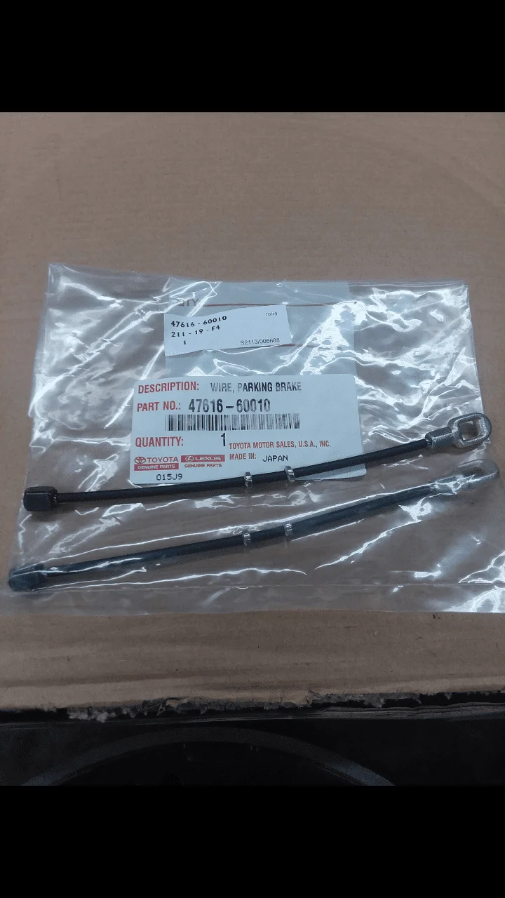

Not saying that they didn't mess those little cables up but I have seen the cables just like that on othe 60s that were installed properly just worn. Here is a pic and a pic of the part number for the replacement cable only one is in the package so order 2 if you want to replace them. Also helps to take it to a shop that actually works on landcruisers knowledge is key.
Tommy
Yeah, I don't think they messed up the cables, just did a s***ty job.

Expensive little cable... $50 for both. I guess I need to change them and be safe... they're brakes
