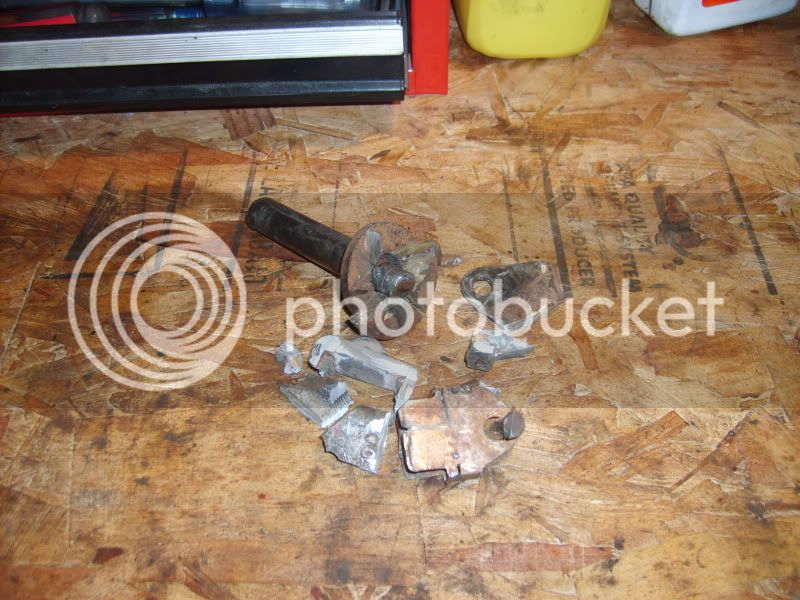

Waiting for new bellcranks to come in. I had to chop everything up to "disassemble" it. As you can see below.

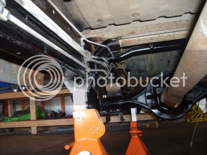

I've been taking the time to undo everything from the frame (brake lines, fuel lines, etc) to sand it down and paint it with a rust preventative enamel. It's much like rust bullet, I've great success with it in the past but it's not cheap.
Hoping to have the rear axle completely done within the next 2 weeks! I need some serious motivation.

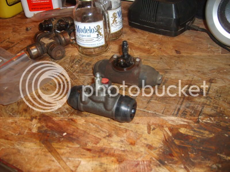

The rear axle is just about done. It's getting new wheel cylinders that I am picking up tonight and then will install everything over thanksgiving break, bleed the brakes, turn the rotors, button everything up and pull it out of the garage.

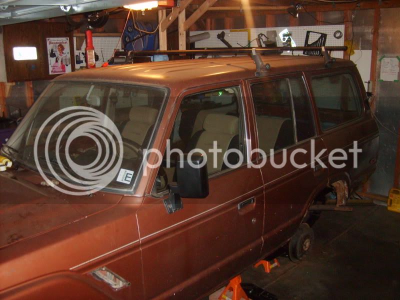

Yakima rack and gutter mounts. I also have a roof basket but it doesn't fit in the garage with it on.
Old vs. new wheel cylinders for the rear brakes.

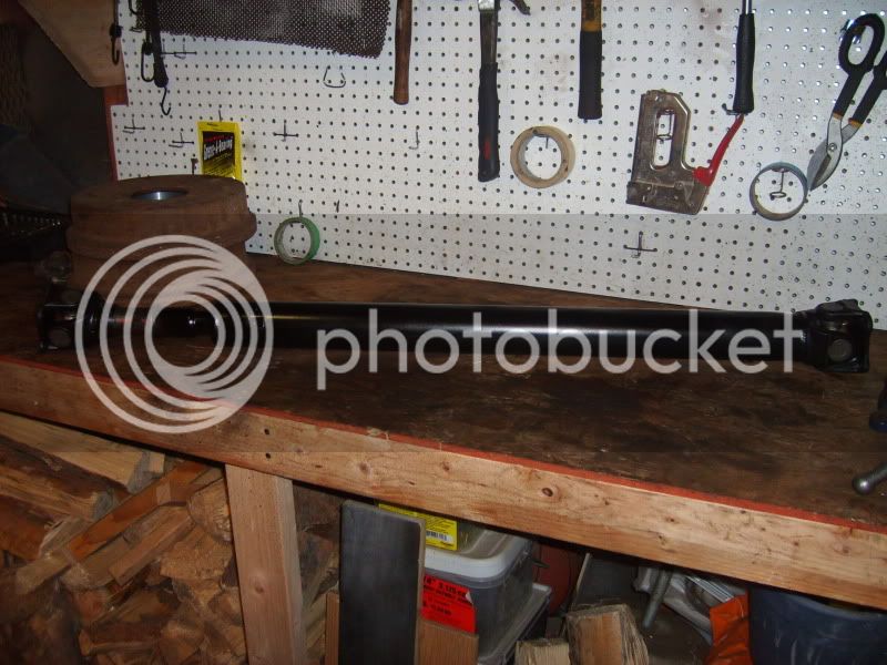

And finally, rebuilt the rear driveshaft and had it balanced.

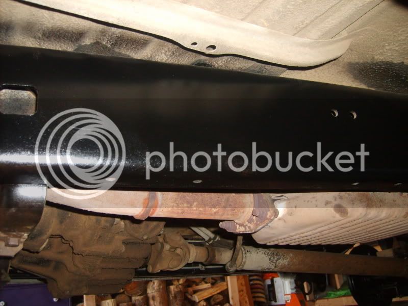

Hey Elliot your work looks great, just wondering how you got all that front end so clean? I didnt think I saw a sandblasting post. Was all that with a steel brush? My power steering box is all nasty along with the tir rods, I really need to clean it like you did.
yeah i was wondering the same thing. i went through a thousand rags on the engine bay, my axle looks even worse as far as built up gunk . Im about to start on all that- whats your technique?

As far as cleaning the axles and frame... I spray A LOT of degreaser and go at everything with a wire brush. I get it down to the metal (usually still has paint on it) then shoot some brake parts cleaner on the item to wipe off any more residual crud. Then I wipe the entire item down in mineral spirits and when it dries I shoot it with the rust enamel. It holds up great!
I know it sounds ridiculous but I'll also be going over the tie rod with a flap disk to get out the marks from whoever aligned it last. It left some pretty nasty grooves in the tie rod. Little things like that make a nice final product in my opinion.
