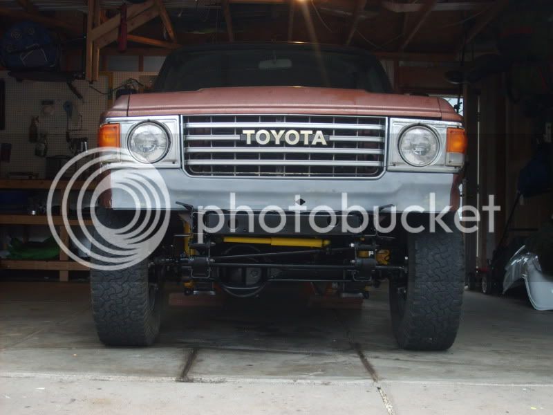

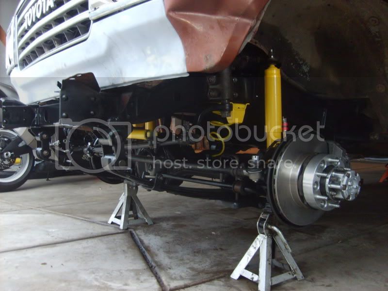

The drivers side is completely done! Feel free to flame my yellow bumpstops. :D I got the knuckle seal issue figured out. For some reason it got all wavy when I bolted it down (maybe wasn't lined up right). The passenger side will be done in a couple hours once the paint on my knuckles/steering/etc dries.
Aside from a couple of brake hoses that had to be special ordered, the front axle is DONE! I'm glad too, I was getting tired of messing with it. Setting all the bearing preloads, fishing out cone washers, blah blah blah.

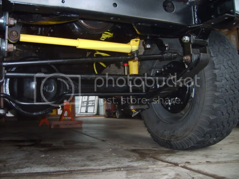

So the front axle build:
Knuckle job (bearings, seals, etc)
Inner axle seals
Wheel bearings, hub seals and races
Cleaned and painted housing
3" medium duty leaf springs
Appropriately matched shocks
Extended swaybar endlinks
New tie rod ends
Steering cleaned and painted
New coiled breather hose
4runner calipers
New FJ rotors
New rubber brake hoses (the OE ones were shot)
1.25" wheel spacers
17" alloy wheels from 2007 4Runner
285/70/17 BFG A/T (temporary)
Lots of getting dirty...see before pics. :D

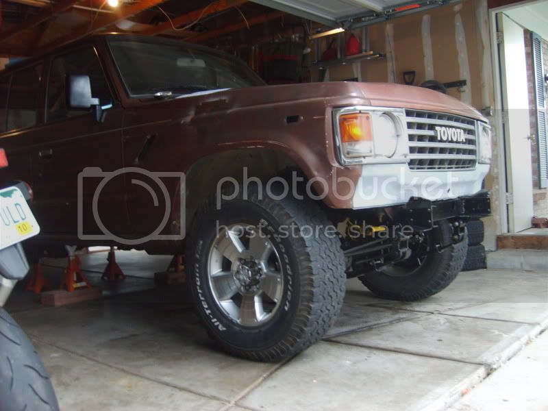

After I get the calipers plumbed, I'll be moving onto the rear axle. I'm thinking that will be much less time intensive.

Thanks Milo. I'm hoping I'll start on the rear this week/weekend. It shouldn't take as long considering all I'm going to do is clean it up, adjust brakes, new e-brake, and suspension. We'll see how that goes.

woah that is nuts! gotta be careful and use the correct sized stands!!

Holy crap, how very interesting. Well, I typically use other means of backup stands and stay as far from under the vehicle as possible. I'll definitely keep that in mind though, thanks for the heads up!
Holy hell. I have a pair of 6t 'stands and never thought twice about them. I'll have to go look at them again!
