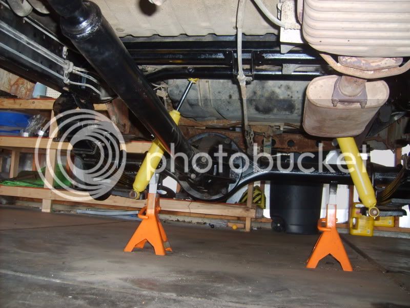

Got the rear axle done.
New wheel cylinders
New shoes
New e-brake bellcranks and hardware
3" lift springs/shocks
Rebuilt and balanced driveshaft
Shock xmember cleaned and painted with rust proof enamel
Same with rear half of the frame (lots of work but worth it)
Still need to get the drums turned and bleed the brakes. Hopefully I can make that happen this weekend!

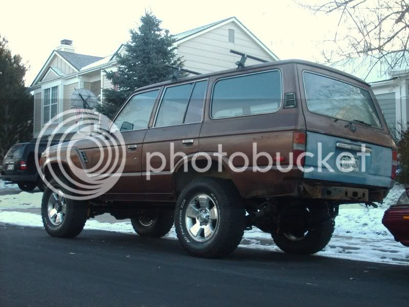

Well after thoroughly bleeding the brakes and making a few adjustments, I actually pulled the beast out of the garage. Upon first drive, it feels A TON better than those flat, worn out springs and shocks. The steering feels nice and tight, the parking brake works well, and most importantly.... it didn't blow up on the test drive! I'm hoping the shackle angle mellows out a little bit as the springs settle but we'll see, the ride quality isn't terrible but we'll see how it holds up.
Next endeavor is mounting up this SROR rear bumper I have along with fabbing the tire carrier and jerry can holder. I'm so glad I have a REAL 4x4 to drive now! Thanks for reading.

The 4runner brakes are working well so far but I think I may still spring for the T100 master cylinder to firm up the brake pedal.
The suspension is about 2.5-3" higher than stock.
