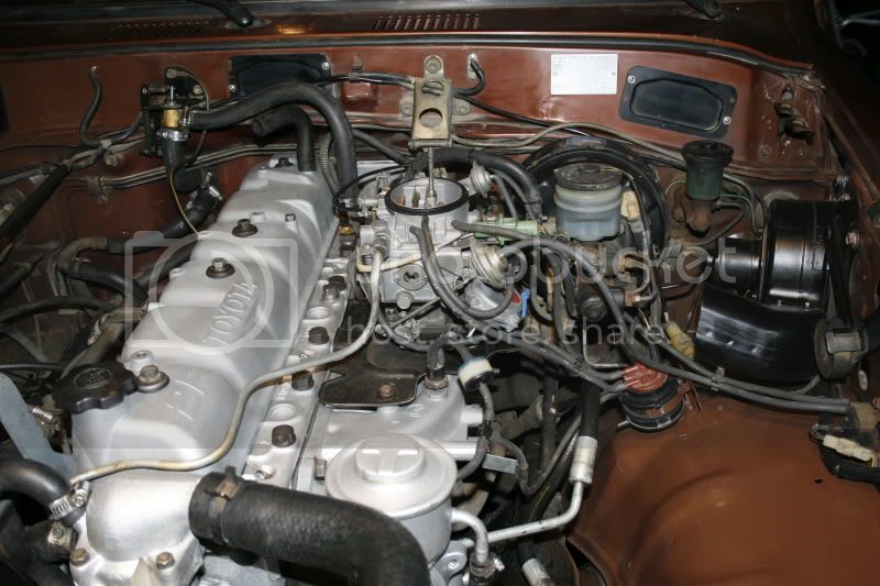

This is how my lower ports on my carb are routed. Lower left port routed to 1* advance on distributor diaphragm. Center angled port goes to the HAC. The top left and bottom right are both capped.
OK, that's perfect hose routing.
The other 2 should be capped off separately, because one port (upper) is manifold vacuum, and the other port (lower) is ported, so at idle, the upper port is sucking free air from the ported port. It's a vacuum leak, but a small one.
Idea: Stick a BB in the loop of hose to separate the 2 fittings.
I actually drove it around the neighborhood tonight! First time it's left the garage since January. Woot! Anyway, I fixed all of the leaks that made themselves obvious and cleaned up the vacuum hoses a little bit. Here are shots of the FINISHED motor.
And with the air cleaner on and everything capped.

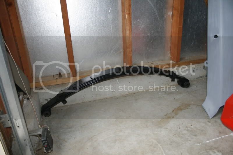

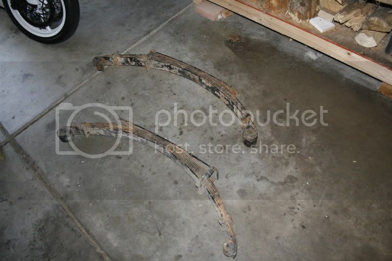

I'm tearing into the suspension and axles this week. I picked up some springs and shocks from a guy that had been sitting on his 60 for awhile. Only have a couple thousand miles on everything but had been sitting for awhile. Good excuse for a rebuild.

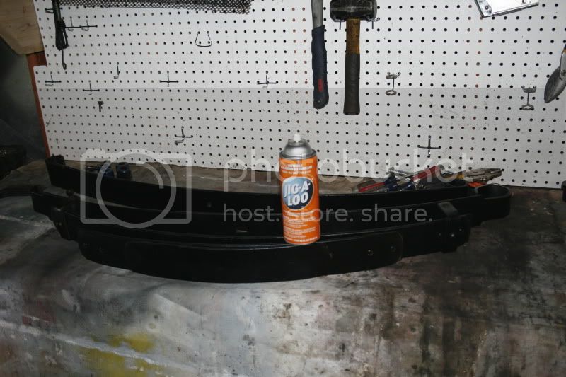

Pulled the leaves apart, wire wheeled, painted, and jig-a-loo'd (graphite spray to keep springs from squeaking) them before reassembly.
Coupled with new bushings, this might as well be a brand new set.

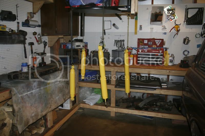

Oh yeah, and gave the shocks some love too.

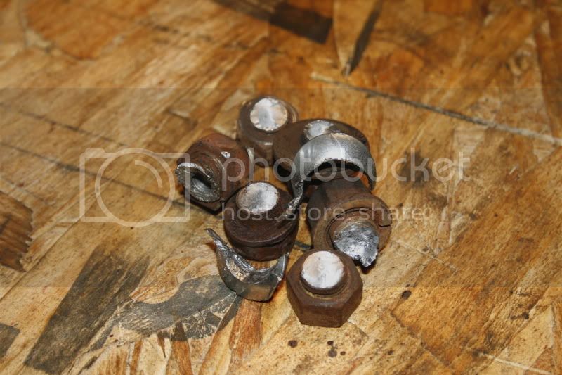

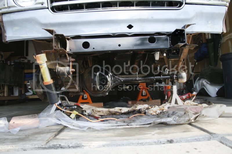

So I'm starting on the axles, suspension, frame, etc... Whilst removing the front bumper I broke off 2 bolts and had to drill out 2 others with a 15/16" bit. Major PITA but I guess that's to be expected from a truck thats older than I am.

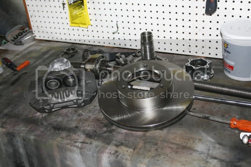

So I'm rebuilding the knuckles and replacing the wheel bearings. I also am upgrading to 4-runner calipers and rotors in the front. I may end up using a T-100 master cylinder depending on how the brakes feel with the new schwag.

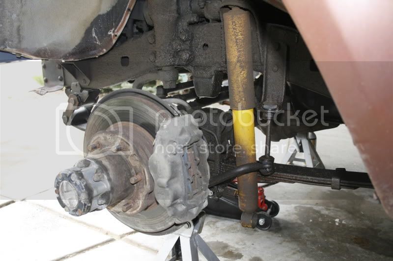

I feel like this shock probably wasn't doing much in terms of dampening... anything.

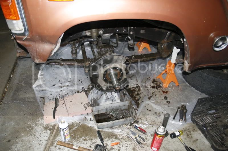

Here's an idea of how disgusting the front half of the truck is from many years of leaking knuckles, power steering, oil, mud, dirt.... and whatever else a farm truck runs through.
And after wrenching for 30 mins, cleaning for an hour, wrenching for 30 mins, cleaning for an hour, etc.... here is where I am. I'm going to pull the birf tomorrow and repack/rebuild/clean everything.

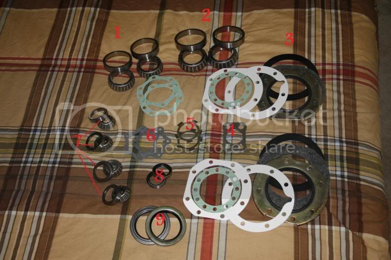

Here are all of the gaskets and bearings needed for a knuckle rebuild.

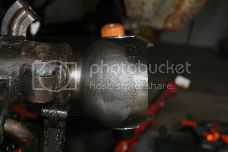

After complete teardown, the knuckle had a small burn mark area. Hope this is ok.

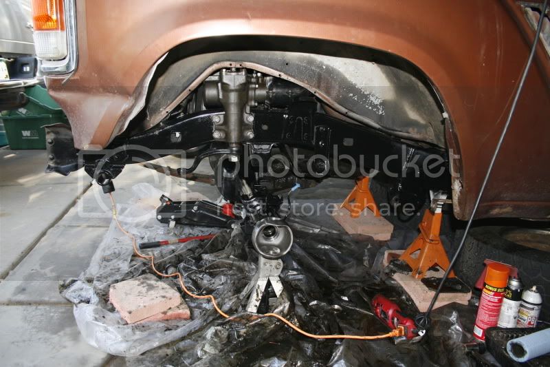

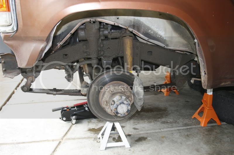

I've been getting the frame and axles cleaned up. There has been almost NO rust on any of these parts as the oil and PS fluid leaks have kept it in an oily cacoon for the last several years. I've gotten the drivers side axle cleaned up and ready for reassembly. If my brake parts come in I will probably tear into the passenger side axle this weekend.

And all of my brake parts are here. Calipers and rotors are from a 95 4Runner and should fit with a little trimming of the backing plate. I may or may not need to upgrade to a larger volume master cylinder. We'll see how it feels.
