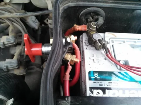

Here's where I mounted my blue sea switch. Otherwise you may be able to get specs for power draw for both your winch and the switch you currently have. Based on winch loads, expected duration of use, and what the switch is rated at (continuous, 10 minute, etc) you should be able to figure out of what you have will work.
I personally went with a blue sea that has a continuous rating at the winch's max amp draw. Probably won't ever see that but didn't want a switch melting down when I most needed the winch. Plus I like that I can switch off the winch from outside in an emergency without popping the hood.
