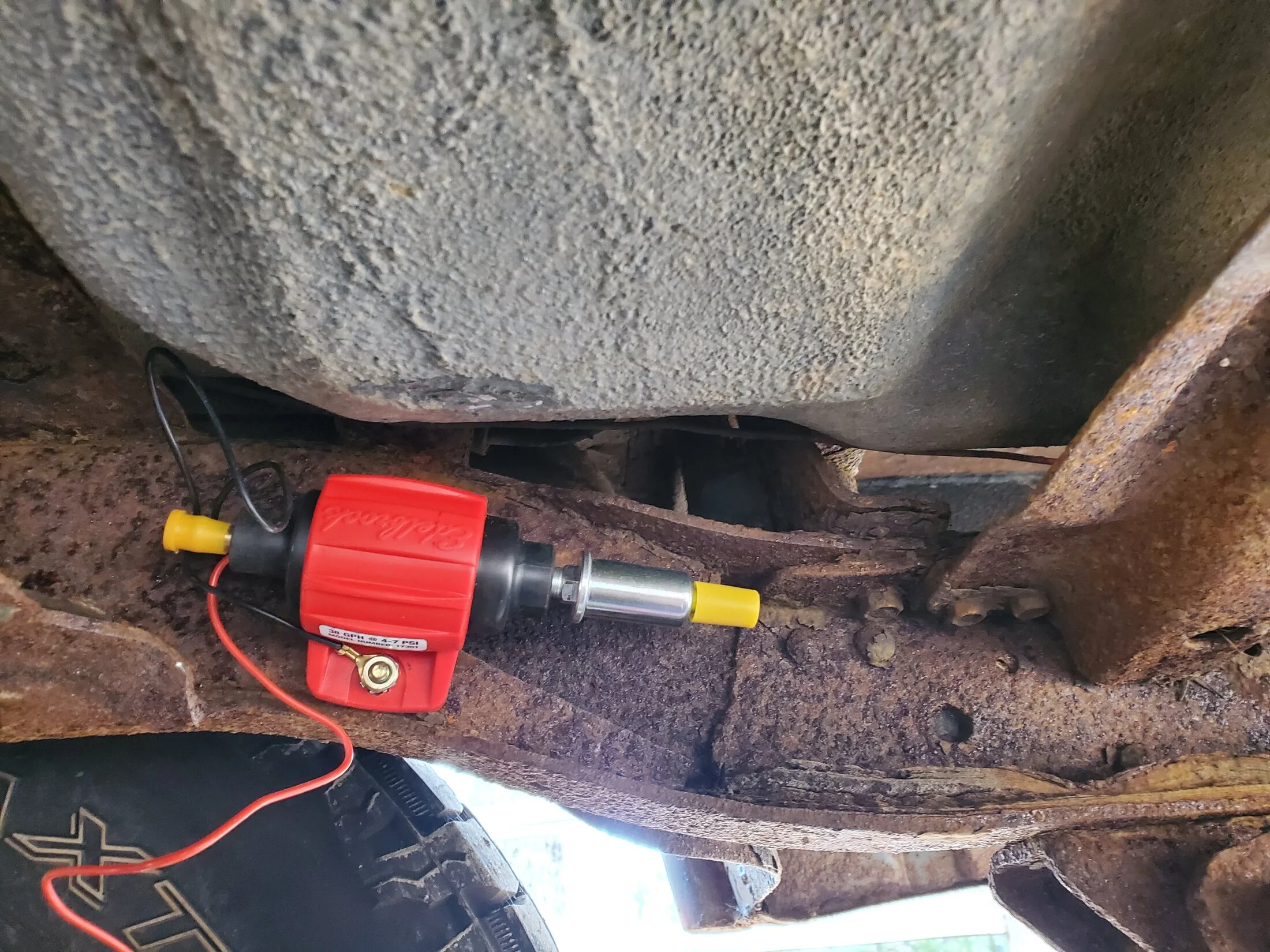

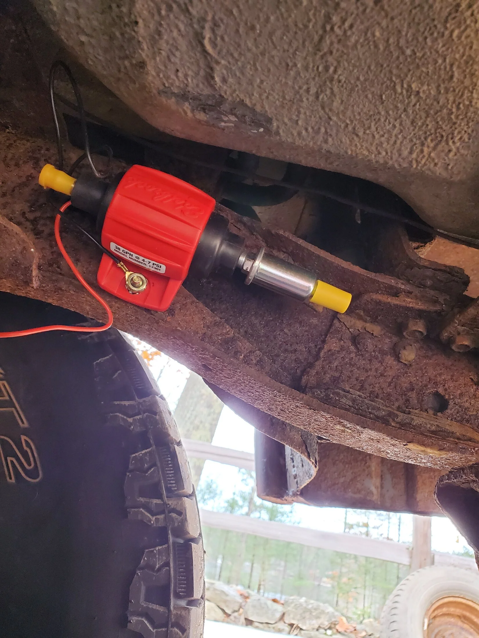

Edelbrock, dunno if this helps.
I mounted my pump and filter on the inside of the passenger side frame rail in front of the rear axle near the tank.
