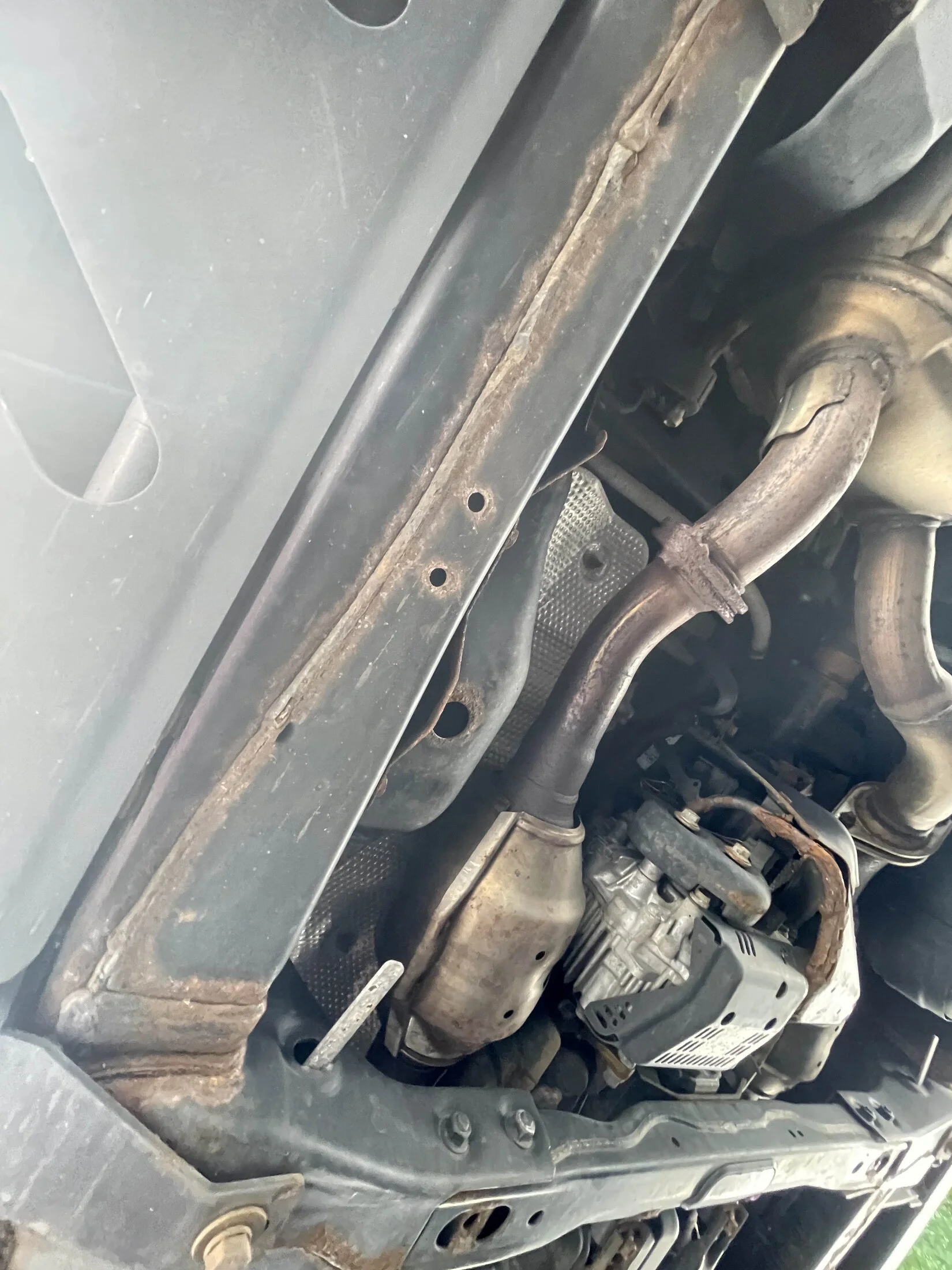

Hey folks,
Would you guys mind taking a look at this undercarriage and help me understand what I'm looking at / what potentially can be easily fixed with some elbow grease + paint prep + undercarriage spray, as well as what is potentially rusted through and needs an entire replacement?
About to purchase this '14 LX 570 from a friend and wanted to get some help from the community. This has lived it's entire life outside on the streets in NYC and has been driven as a daily work vehicle in all 4 seasons. Most recently, it's been covered in salt/snow/dirt from everyday use. A few weeks prior, the radiator failed, which seemingly caused a misfire, which causes a head gasket to fail, and coolant leaked into the engine, which caused catastrophic failure. A used engine with <60k miles was purchased and on it's way to a shop Toyota / Lexus specialist to install. Car is now in GA awaiting it's new heart.
Additionally, I purchased Slee aluminum skid plates to replace the rusted through covers (at least what I can identify as the corroded OEM sliders, but pls correct me if I am wrong in my identification).

Also, what is the clearly rusted through pipe in the middle of the attached photo? Is that easily replaceable?

It isn't terrible, a turbo tip on a regular power washer would knock 90% of the crusties off. Then some wire wheeling/needle scaling and clean and paint.
I believe that "pipe" is just part of the factory transfer case skid.

Just surface rust as far as I can see. An afternoon with a wire wheel and some rust converter paint would take care of that. I don't see real rot or anything to actually worry about. The "worst" of it is the gas tank skid, and if you already have a replacement then that saves some work.
Those appear to be Slee sliders with the added AHC protection.

Fully agree with this - rust isn't too bad outside of the gas tank skid which you are better off replacing rather than trying to fix.
Probably $500-$1000 for a good autobody shop to clean up the frame and other underbody surface rust and then prime and paint. After you are done do yearly applications of Fluid Film, Wool Wax or Cosmoline for added piece of mind (a bit belt and suspenders in GA to be sure).

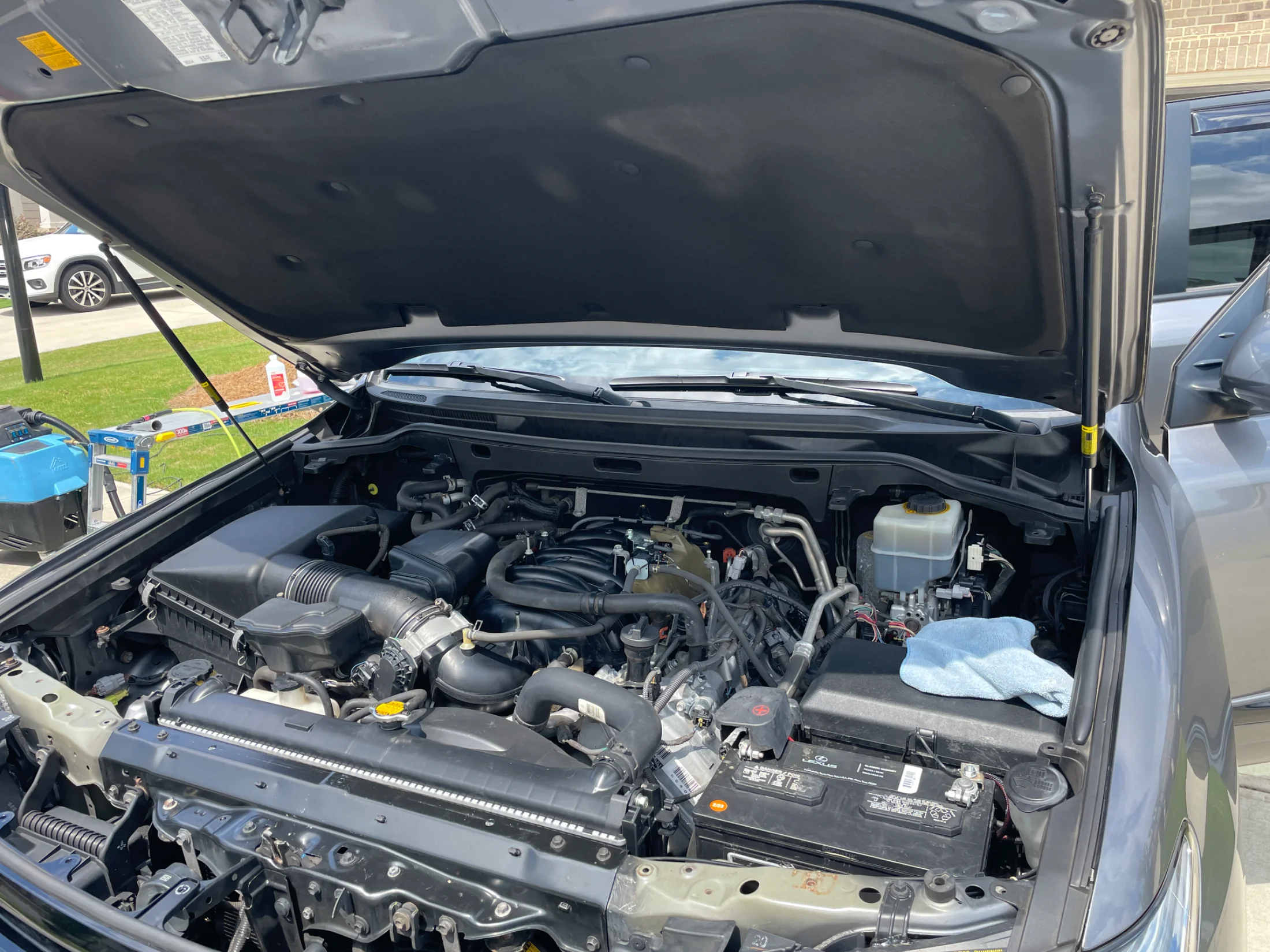

Congrats on the new LX! Looks great. :) Do you have the covers for the front part of the engine under the hood? Part of their function is to keep road grime and debris out of your engine bay and also to direct cool air through your radiator. I'd maybe look at replacing the front pieces responsible for directing air flow. Enjoy your new ride!
The ‘pipe’ that appears rusted through is the transfer case protector. They seem to rust on most 200s even those that have never seen salt. I have one sitting in my garage awaiting a free weekend to be installed.

Thanks! I took the covers off for the detailer to give the engine bay and various liquid holders a cleaning as the sand blasting left a ton of residue and grime.
I did give it a dry brush and vacuum before he came so it didnt get cakey with mud, so worked out very well!
