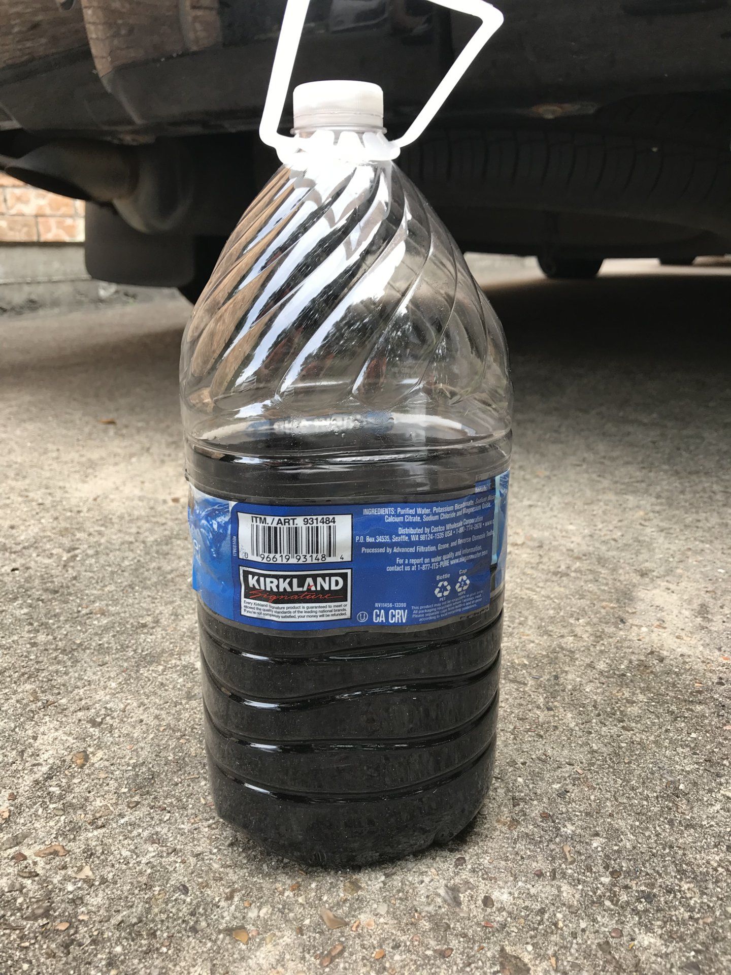

So it turns out to be an easy fix. Hooked up Techstream again last evening after work. Navigate to AHC screen and simply clear the code. And I can hear the pump working right away. Thanks to PADDO suggestion, it is all good now. After 2.5 Liter AHC fluid replacement, ride smoother. Used fluid is way overdue!

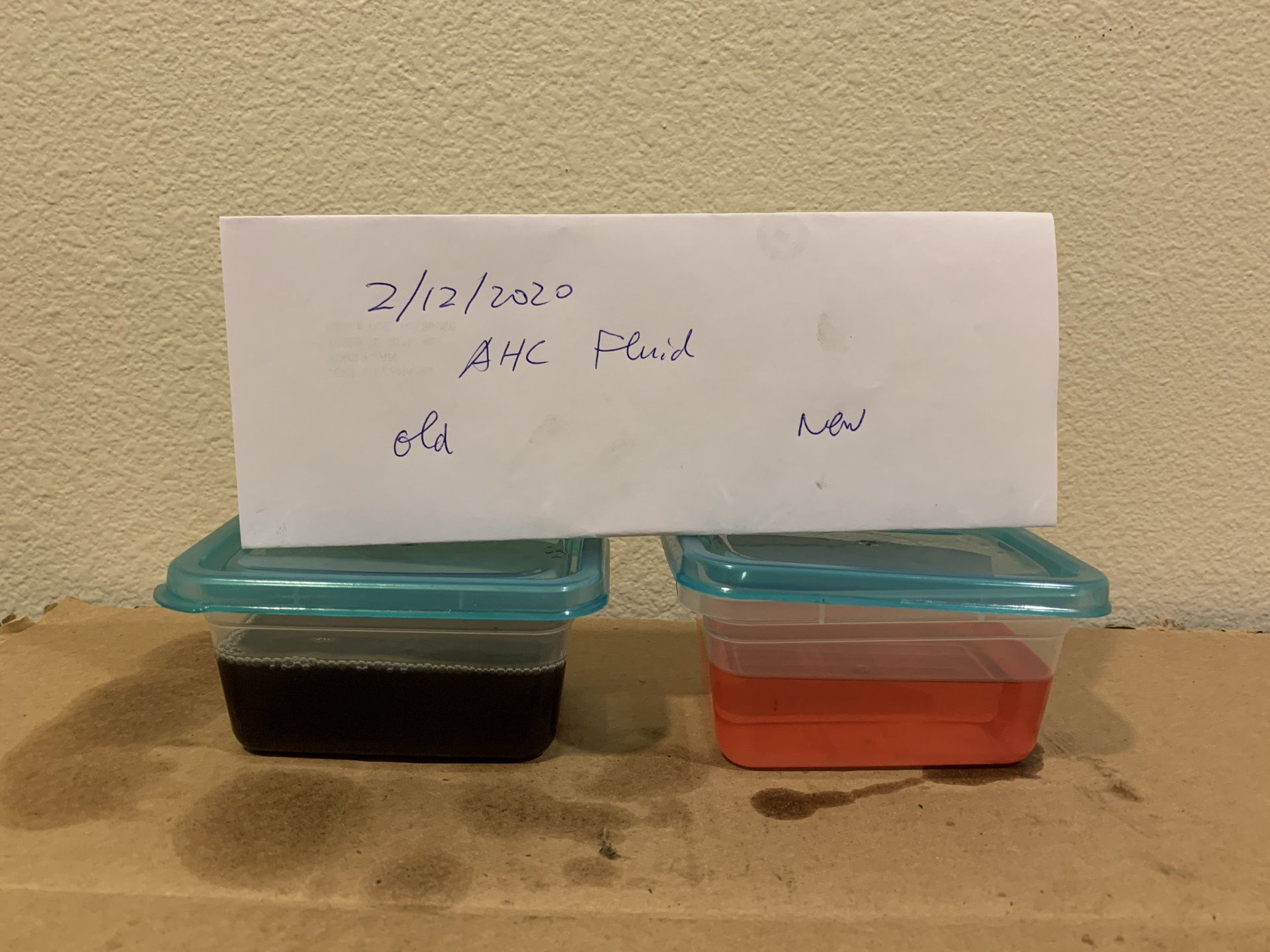

This is my old fluid compared to fresh new fluid, definitely needed to change.
What year is your LX and miles? Any record of previous fluid change? Just curious.
It’s a 2015 with 91k miles. there was one previous owner, probably didn’t service at Lexus dealership because there is not much Carfax records.
