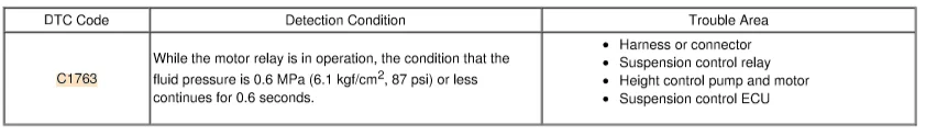

Is it the same error as before? I fully believe this is due to tech incompetence. It probably was just underfilled or needed bleeding - due to tech incompetence. There's specific steps that need to be carried out to make sure there's enough fluid level.
The specific issue is that the ECU does not see the AHC pump increasing fluid pressure within .6 seconds. Potentially due to insufficient reservoir fluid after burping air from the system. No increased pressure - no raise. They were likely chasing the wrong thing, but makes sense that they tried to replace the pressure pump.
If the same DTC remains now, I'm still suspicious they bleed or filled the system right. Alternatively, has the pressure sensor been checked or replaced?

Same error as far as I'm aware.
