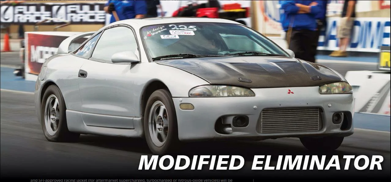

I have been running E85 in my 1997 Mitsubishi Eclipse GSX since 2007. It makes 3X the power and gets the same MPG as factory. I would love to switch the LX to a Flex-fuel vehicle. Or if anything switching to a smaller more efficient injector to lean out the factory AFR and maximize efficiency like you have done.
Factory tunes are so wasteful it's just plain sad!!!

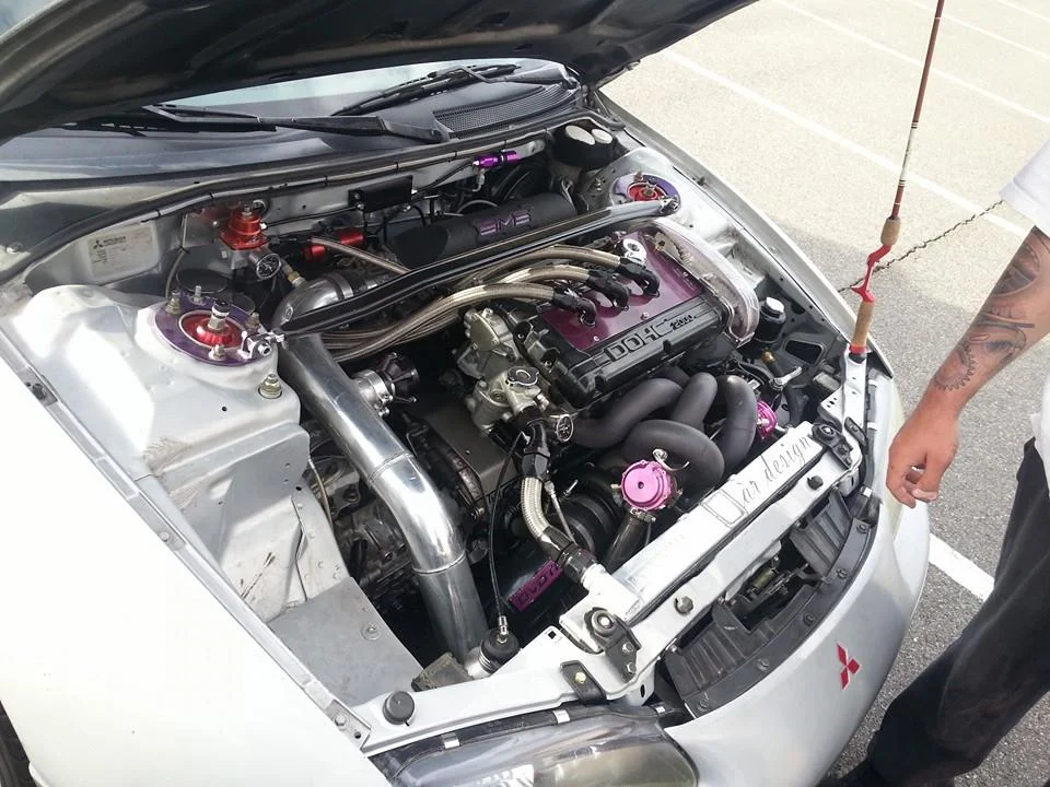

That's my Eclipse. I have it running on AEM Infinity it makes 830AWHP and has ran a best time of 10.2 @143 mph.
